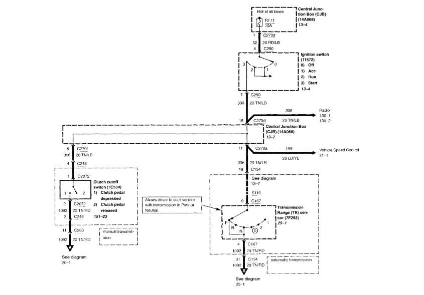

Turn the ignition key and just click won't start.
Dec 18, 2018 at 6:06 AM
Good morning,
Do you mean the starter motor just clicks or the relay is clicking?
I would start by checking the battery for proper voltage.
Did you try it in neutral?
I attached a wiring diagram for you to view. check the fuses to be sure they have power on both sides.

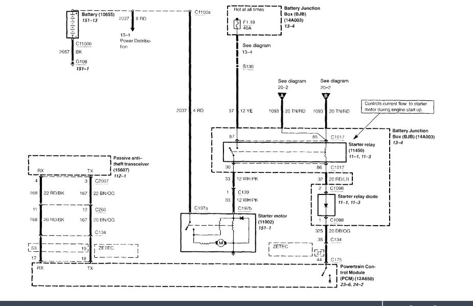

My car is not starting. put new battery, new alternator and new starter. Still wont crank over.

I suggest getting the battery load tested to check its condition, if it is okay then take your alternator and have it checked too.

Excuse me for butting in to your conversation, but this is not an ignition coil problem. Removing the generator for in-store testing is not a good idea. Those testers have at most a one horsepower motor to drive the generator. It can take over five horsepower to run it wide open for proper testing and that can only be done with the car's engine. Testing on-car also includes the entire charging system in the test, not just the one part.
Instead, just use an inexpensive digital voltmeter to measure battery voltage while the engine is running. It must be between 13.75 and 14.75 volts. If it is low, suspect the generator / voltage regulator. If it is within that range, that means it is okay to have the second half of the test done. That requires a professional load tester to measure full-load output current and "ripple" voltage. If the most current you can get is exactly one third of the generator's rated current, and ripple voltage is high, the generator has a bad diode. 30 amps from the common 90 amp generator is not enough to meet the demands of the electrical system under all conditions. The battery will have to make up the difference until it slowly runs down over days or weeks. Then you have to charge it again with a home battery charger.

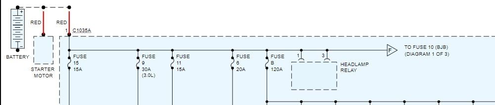

My positive battery cable broke so i went to a junkyard and cut off a positive battery cable on a 2006. Spliced both cables together with a splice connector and crimped. Did the same with the ground wire. And now when i turn key, i have nothing, not even a click or headlights, etc. What did i do wrong?
Aug 19, 2020 at 7:41 PM (Merged)
  • 110,194 POSTS
I have to be honest, I never saw a battery cable spliced. I attached a picture of how the battery positive connection supplies power to everything. Take a look and see if it what you have.
Something tells me you didn't reconnect everything. If you can, upload a picture of what you did so I can see and better help.
