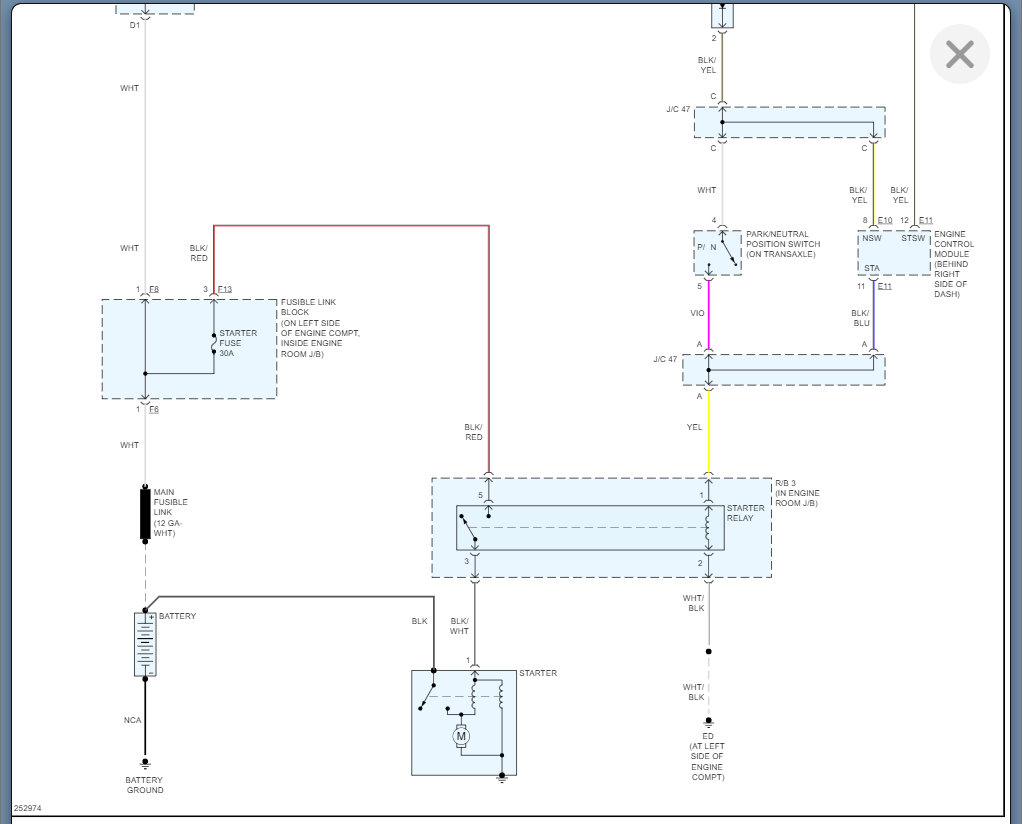

started truck it ran at idle for 3 to 5 minutes then stopped, turned key to start no warning lights in dash and wont restart wont crank. battery is fully charged.
Nov 16, 2021 at 5:53 PM
Just to be sure we are on the same page, was this vehicle starting and running properly before this started or has it been sitting a while?
Here are a couple guides that will get us started with this:

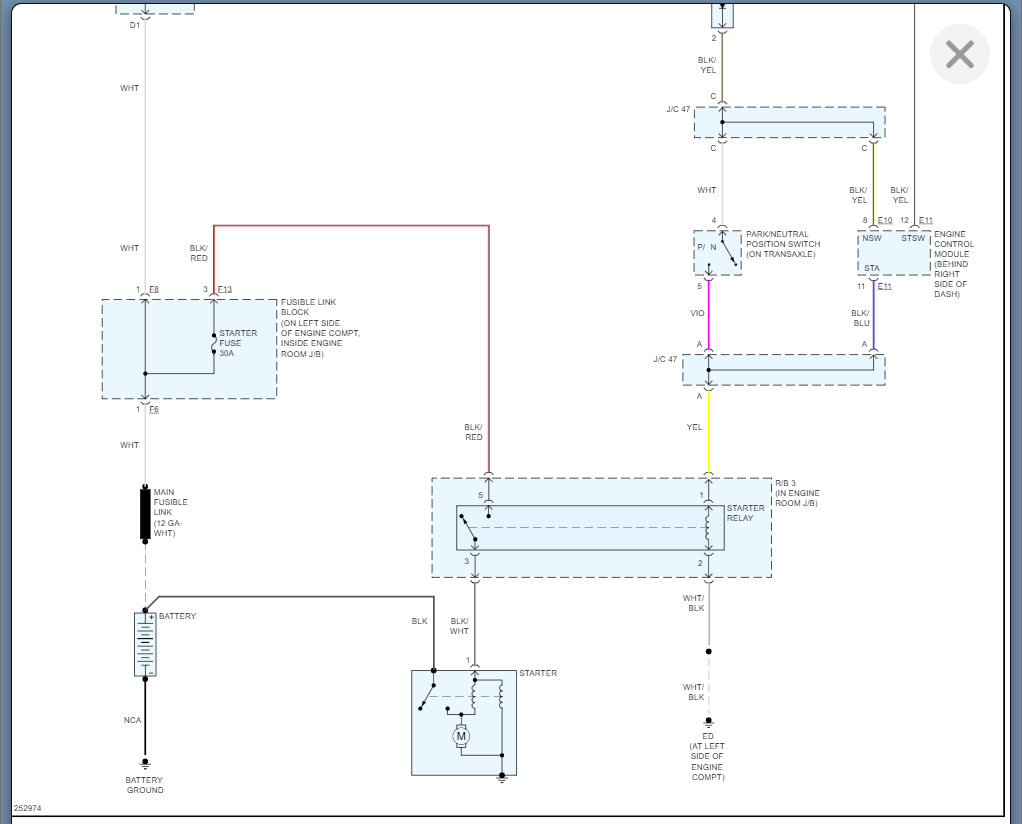

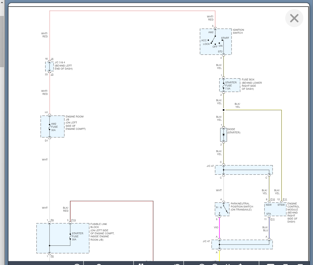

However, I am attaching the wiring diagram below. We need to find out if you are getting voltage at the starter when you are cranking the engine.
If you have voltage on both wires at the starter then the starter is the issue.
However, if you don't then we need to dig further into the starting system starting with the relay.
Please run through this and let us know what you find, and we can go from there. Thanks
