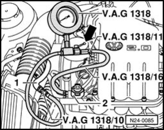

It just quit running. changed coil pack, ran good for moth the quit running again so relaxed again. It gets gas and fires, all lights come on. Can hear the car getting gas but won't. 4th ornery over and catch.
May 10, 2019 at 1:03 PM
  • 110,194 POSTS
Welcome to 2CarPros.
Although you hear the fuel pump, it may not be producing enough pressure to run the engine. What I suggest is to check for three things, spark to the plugs, fuel pressure, and for a signal to the injector. If one is missing or weak, that is where we will focus.
Here are links showing how in general to check the aforementioned components. Take a look through them and let me know the results.
https://www.2carpros.com/articles/how-to-test-a-fuel-injector
Here are the directions specific for testing fuel pressure and the regulator. The attached pics correlate with the directions.

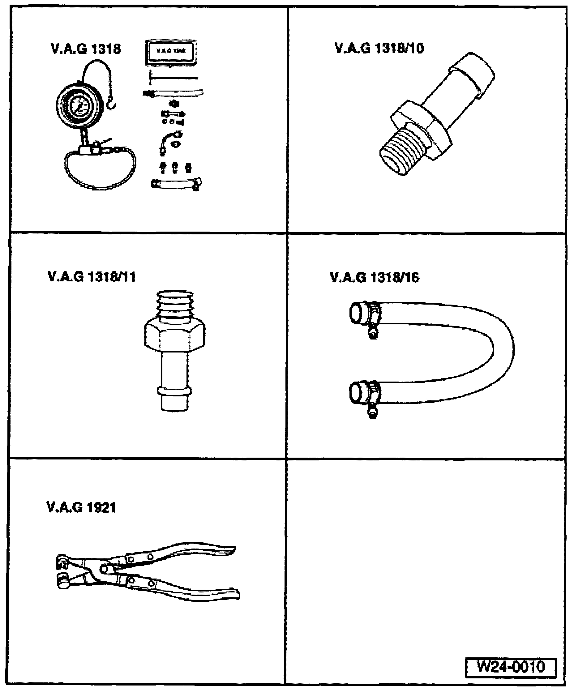

Special tools and equipment
- V.A.G1318 pressure gauge
- V.A.G1318/10 adapter
- V.A.G1318/11 adapter
- V.A.G1318/16 hose adapter
- VAS5024 Assembly tool for spring-type clamps.

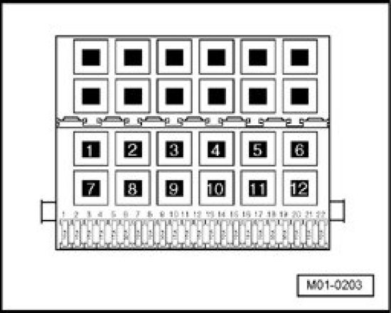

- Remove fuse no. 18 from fuse holder.

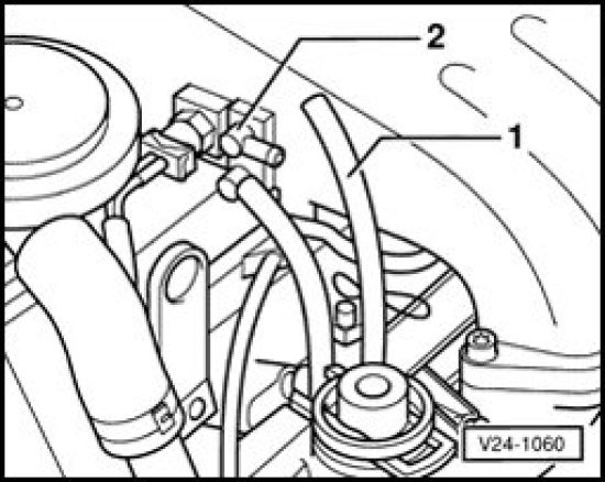

- Disconnect fuel supply line -1- from connection on fuel rail -2- and connect to adapter V.A.G 1318/10 at pressure gauge V.A.G 1318
- Use a rag to catch escaping fuel.
- Connect pressure gauge (V.A.G 1318) with adapters (V.A.G 1318/11) and (V.A.G 1318/16) to fuel rail -2-.

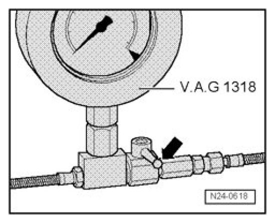

- Open pressure gauge shut-off valve. The lever points in the direction of flow (arrow).
- Re-insert fuse 18 (fuel pump) into fuse holder.
- Start engine and let run at idle.
- Measure fuel pressure.
Specified value: approx. 2.5 bar positive pressure
picture 4
- Disconnect vacuum hose -1- from connecting piece -2-. Fuel pressure should rise to approx. 3.0 bar positive pressure rise.
