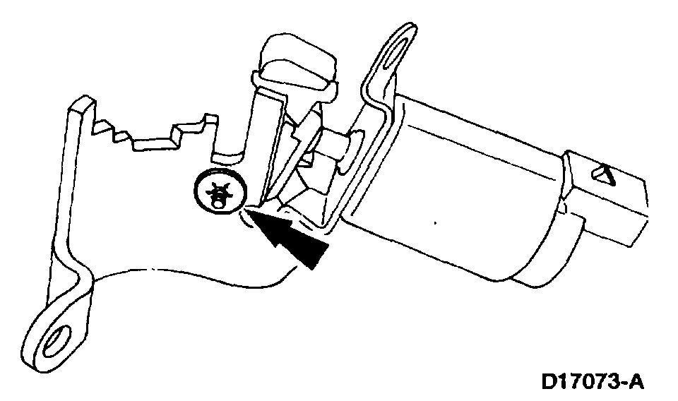

If I shut off motor and turned key one click put it in neutral then it would start and I could put it in reverse or drive. But not if I tried to start it then shift out of park. How do I fix it.
Feb 17, 2021 at 7:17 AM
  • 110,240 POSTS
It sounds like the park interlock isn't working. This is going to sound odd, but are the brake lights working? The actuator is powered through the brake light switch. So, if there is no power to the switch, it won't release.
If the brake lights are working, we need to confirm if there is power to the actuator. If there is, then the actuator needs replaced.

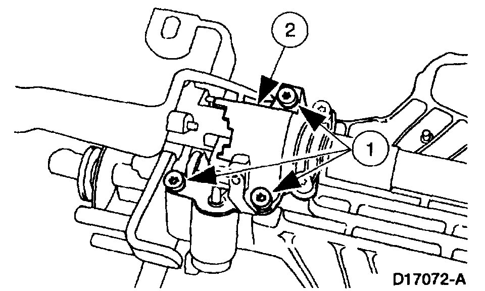

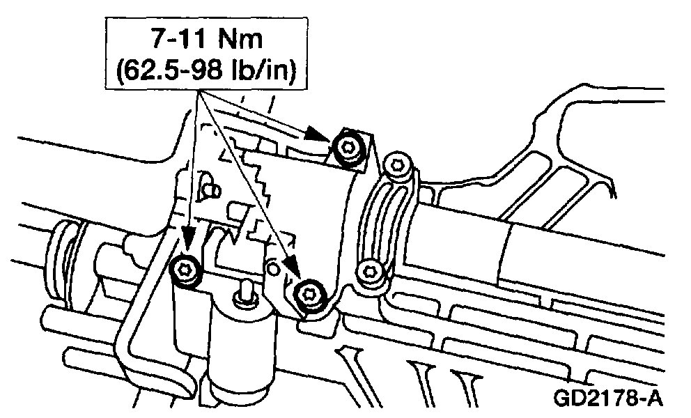

Here are the directions. The attached pic correlates with the directions.
_______________________________________________________
1998 Ford Truck Expedition 4WD V8-5.4L SOHC VIN L
Procedures
Vehicle Powertrain Management Transmission Control Systems Actuators and Solenoids - Transmission and Drivetrain Actuators and Solenoids - A/T Shift Interlock Solenoid Service and Repair Procedures
PROCEDURES
REMOVAL
1. Remove the steering column.
pic 1
2. Remove the insert plate and shift lock actuator.
1 Remove the bolts.
2 Remove the insert plate and shift lock actuator.
pic 2
3. NOTE: The shift lock actuator clip is an assembly aid for the assembly plant and does not need to be replaced in the field.
Remove the insert plate from the shift lock actuator.
- Remove and discard the shift lock actuator clip.
INSTALLATION
pic 3
1. Follow the removal procedure in reverse order.
