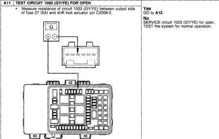

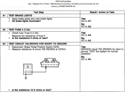

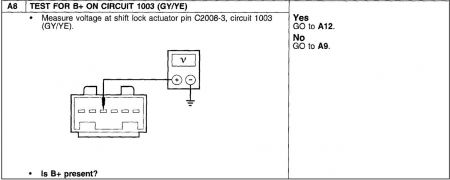

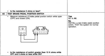

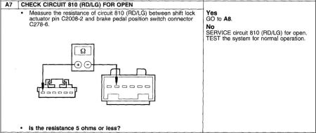

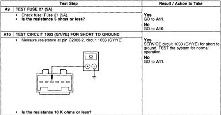

2003 Ford Expedition Will not come out of "park".
2003 FORD EXPEDITION
185,000 MILES • V8 • 2WD • AUTOMATIC
LIZARD31

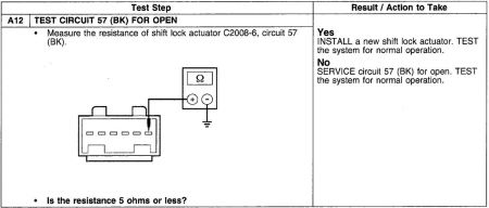

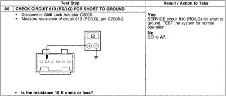

I can insert key, turn it on. Noticed that steering column is loose, not locked like it is normally until you turn it on. Tried to put in "reverse". Will not come out of "park".
Jun 4, 2010 at 2:58 PM
MERLIN2021
  • 17,250 POSTS
Test the shift lock actuator circuit like this:
https://images.2carpros.com/forum/automotive_pictures/62217_shifta_3.jpg
https://images.2carpros.com/forum/automotive_pictures/62217_shiftb2_1.jpg
https://images.2carpros.com/forum/automotive_pictures/62217_shiftc1_1.jpg
https://images.2carpros.com/forum/automotive_pictures/62217_shiftc2_1.jpg
https://images.2carpros.com/forum/automotive_pictures/62217_shiftc3_1.jpg
https://images.2carpros.com/forum/automotive_pictures/62217_shiftd1_1.jpg
https://images.2carpros.com/forum/automotive_pictures/62217_shiftd2_1.jpg
