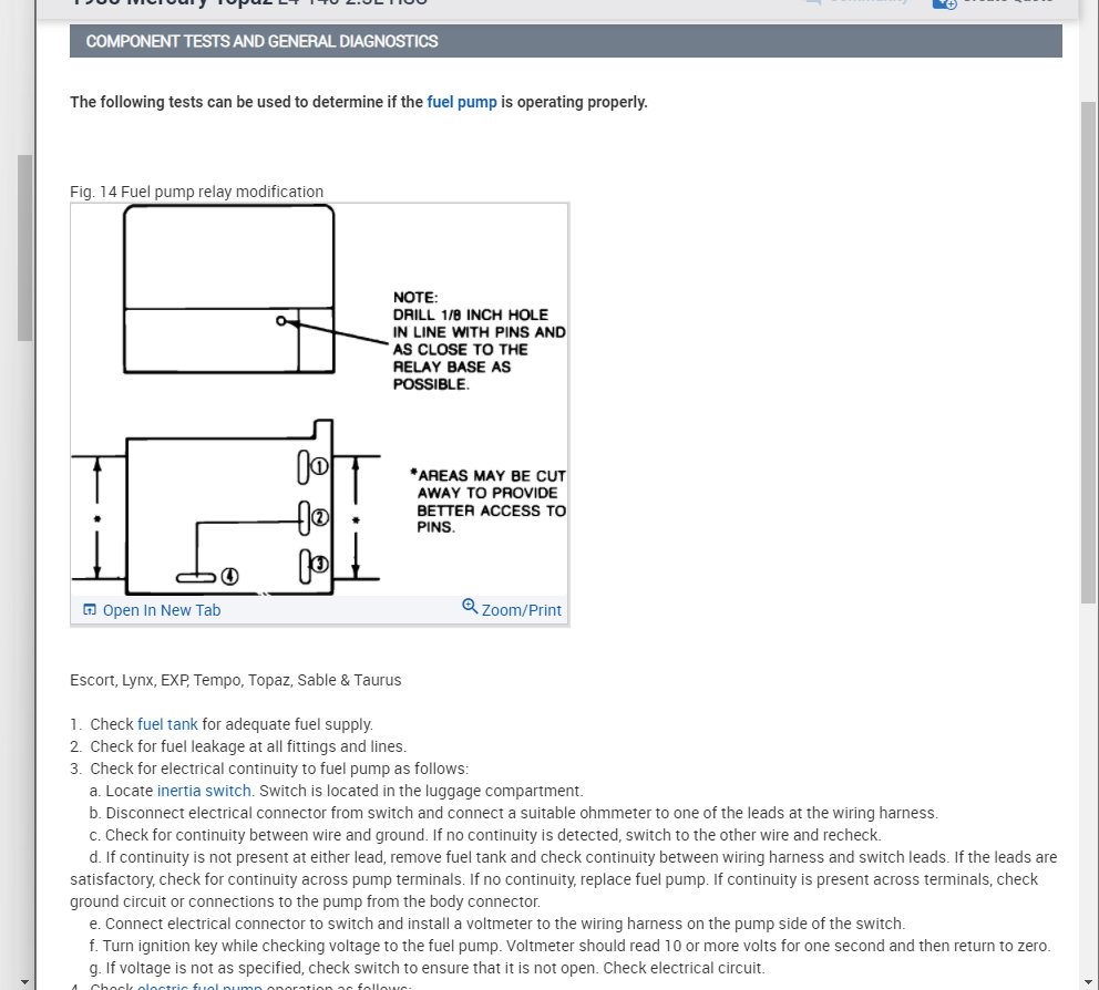

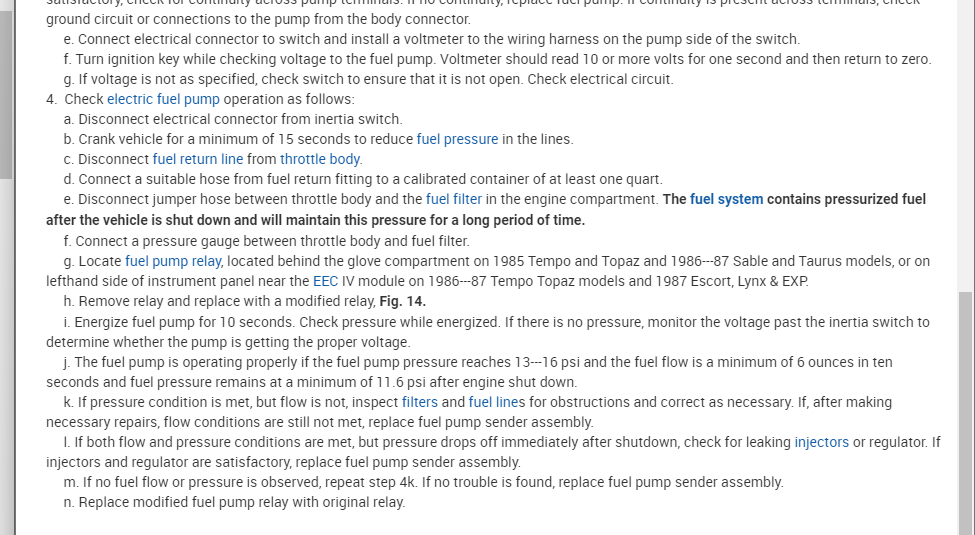

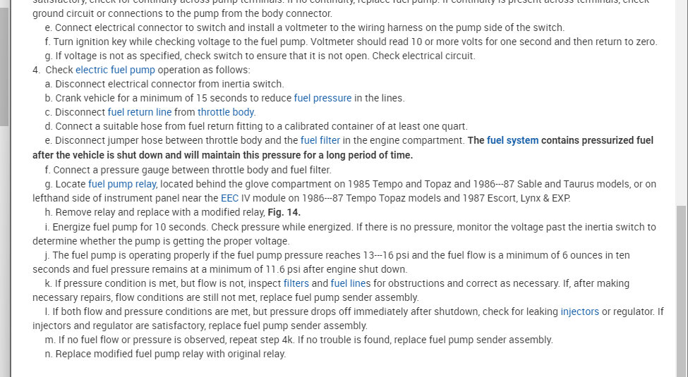

Are you getting spark after this starts then stalls? So, you replaced all these parts and then it starts and stalls, can you check to see if you have spark on a plug now?
If you have no spark, then I suspect we have an issue with the distributor. I have seen on these older Ford engines where the rotors keep breaking and the distributor shaft is the reason.
So, we need to check for spark.
If there is no spark, then we need to track down why we have no spark.
However, if you have spark then we most likely have a fuel issue.
So, try and use starter fluid in the intake and see if the engine starts.
If it does then we need to switch to a fuel issue, and it is most likely a pump issue.

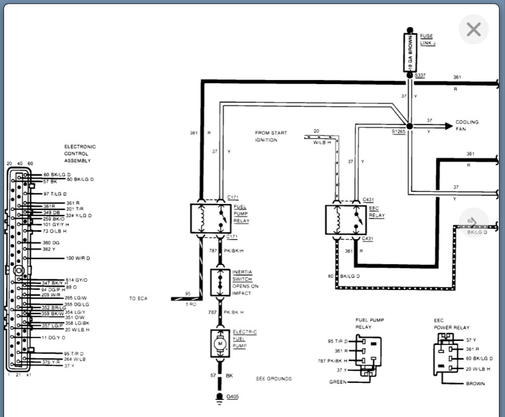

I attached some info from the manual on this so let's start with this and go from there.
Thanks

Yes, i have spark at the plugs and of course i thought the fuel pump as well at first but it a manual fuel pump and disconnecting the lines shows that it is indeed pumping fuel. But i have tried the starting fluid as well as gas and still the same it will start running a second then shut off, it will fire right back up but again only for a second. Then shut off again. The car did run when parked sat for probably six months due to a bad starter. i bought the car first, changed the starter, then had no spark, changed the plugs and wires, the cap and rotor still no spark. changed the control module and regained the spark. Checked the timing as well as rest the timing pulling the number one plug placing it on the compression stroke realigned the distributor, so it is pointing at the number one plug firing order is correct 1234on the motor side and on the distributor, it is 1342 clockwise so the timing is correct it's set at 10 degrees of timing. I have checked the timing numerous times as at first i thought it was a timing issue as it does spit back through the carb after it shuts off a little, but the timing checks out ok. The second it runs smooth at idle.

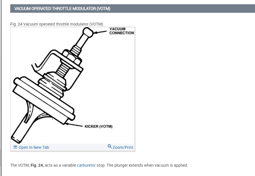

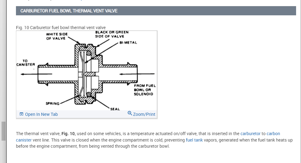

More than likely something is stuck open, or the carb is gummed up from the fuel evaporating and leaving a residue inside the carburetor.
So, for me the next would be to remove the carburetor and rebuild it and inspect the various systems attached below.
Basically, this vehicle is not only a carb vehicle but has a lot of emissions systems on it that will cause all sorts of issues. The 80's was not a good year for fuel systems due to increased regulation.

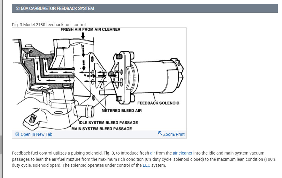

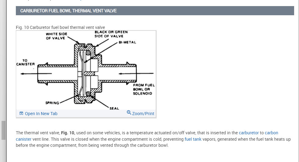

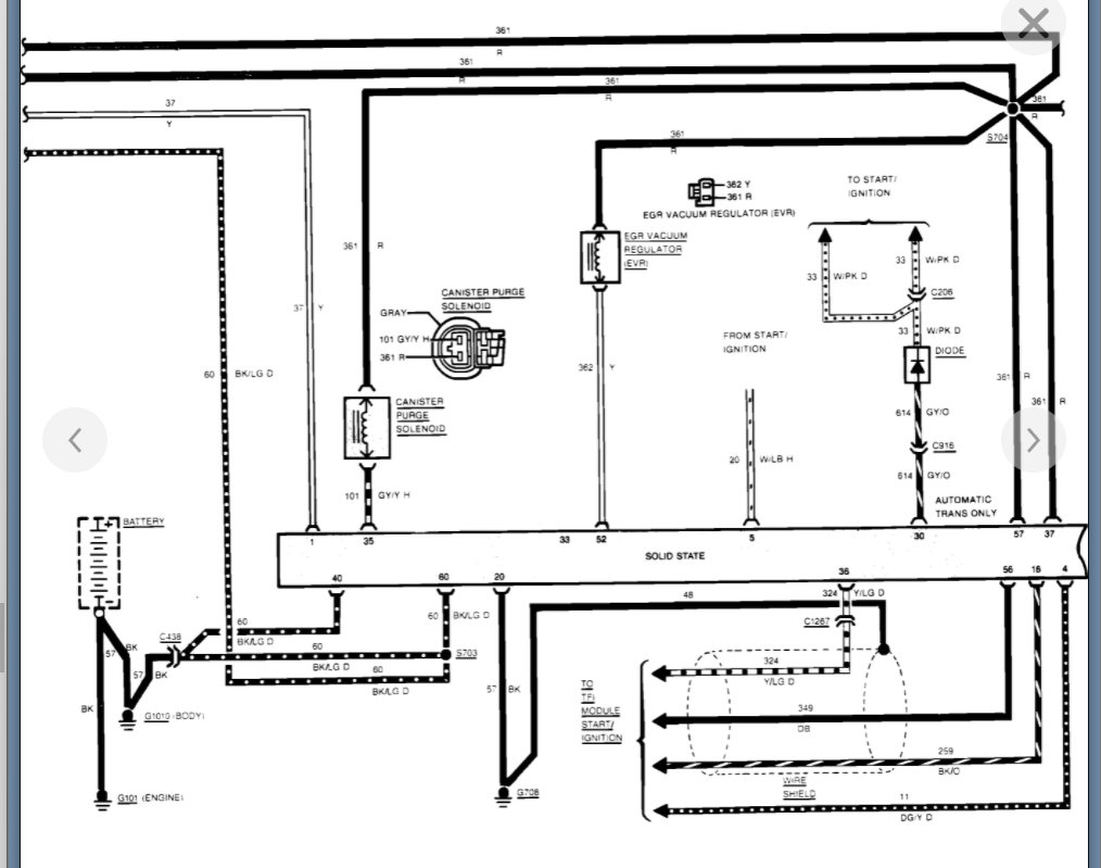

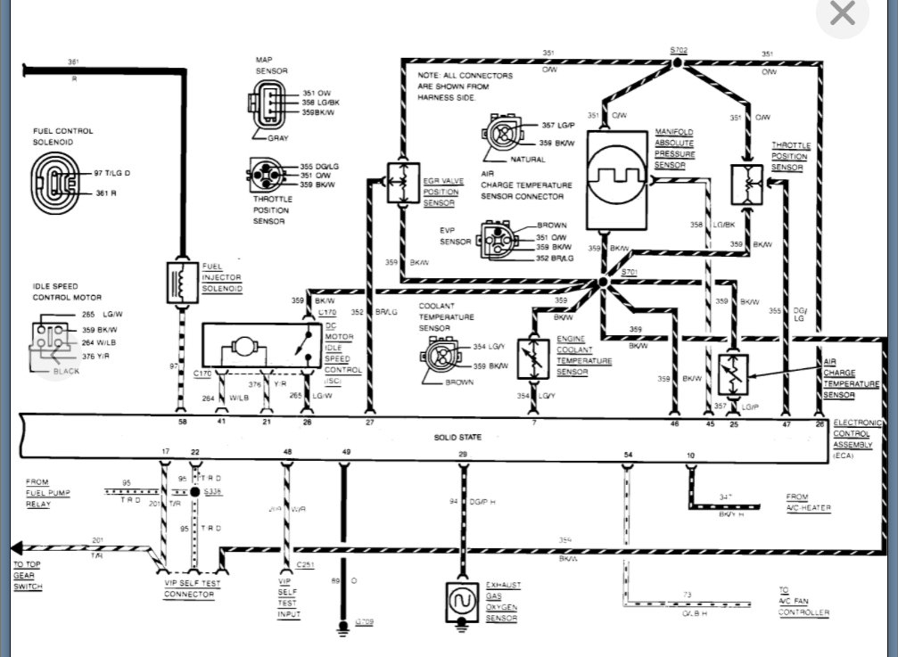

I am attaching a couple systems that need to be inspected but I would focus on the first because if this is stuck open then it will flood the engine and it will stall.
Please run through this info and let us know what you find. Thanks

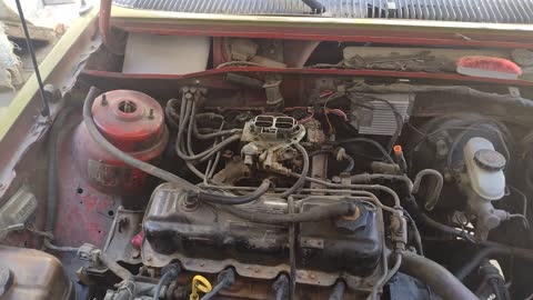

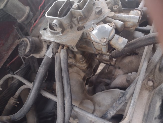

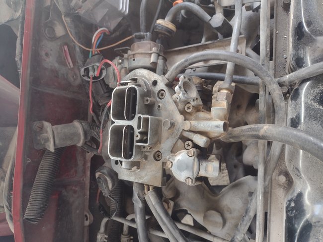

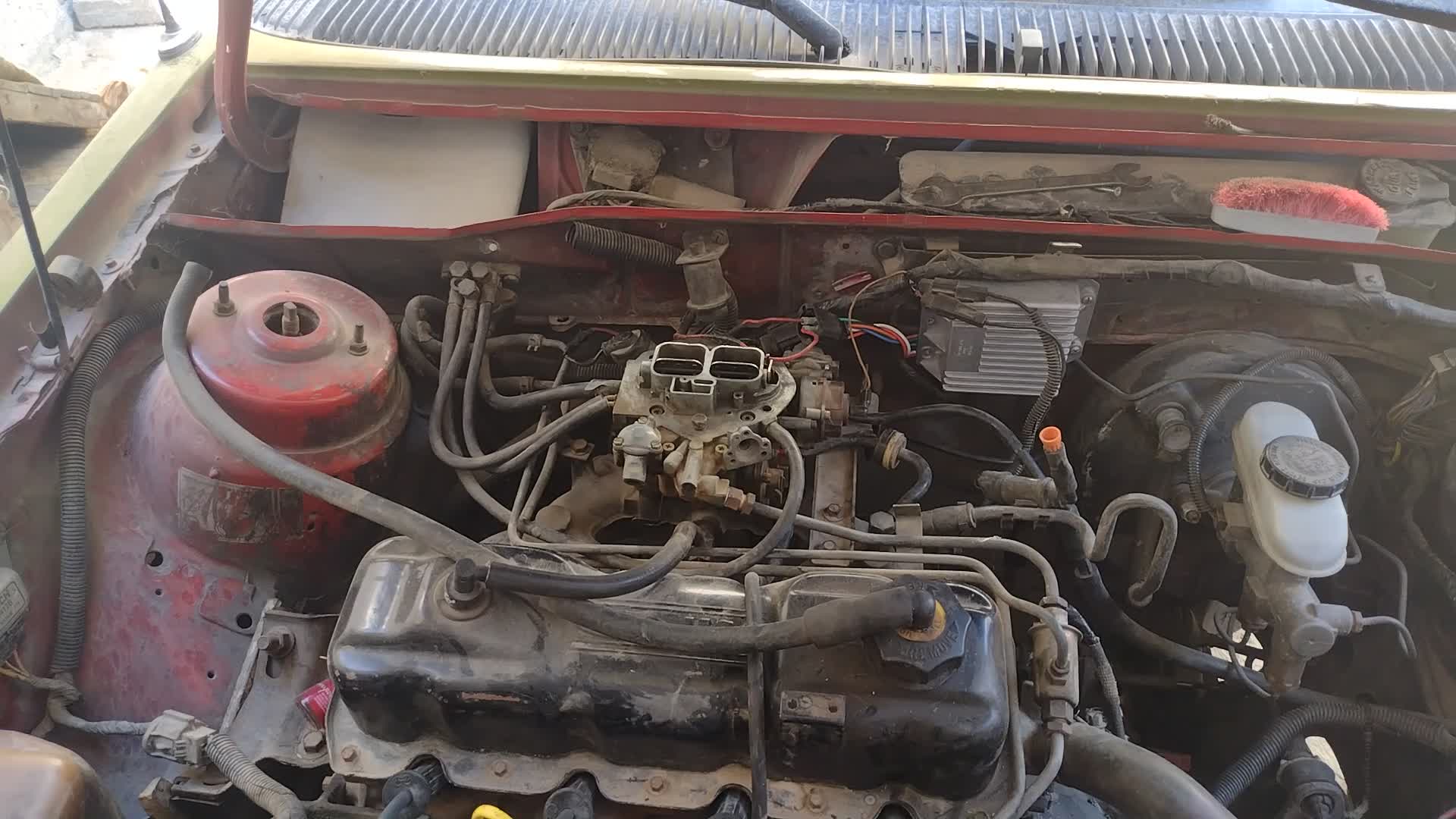

Okay. That is good. In that case we need to eliminate a vacuum leak around the carb and then I would rebuild the carburetor.

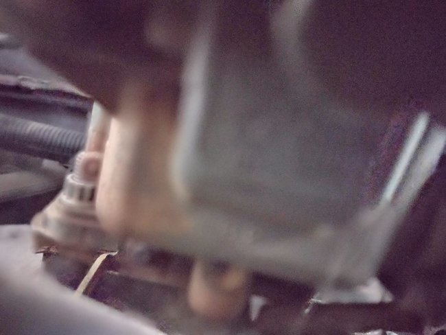

Can you get a picture of the carburetor?
Jan 19, 2022 at 12:03 PM
LGC
  • 27 POSTS
There's one.
Jan 19, 2022 at 12:06 PM
LGC
  • 27 POSTS
Other.
Jan 19, 2022 at 12:07 PM
LGC
  • 27 POSTS
Another.
Jan 19, 2022 at 12:08 PM
LGC
  • 27 POSTS
I don't know if this got posted but this is what it does.
Jan 19, 2022 at 12:10 PM
Perfect.
I think you have too much air.
Does the choke remain open like that? I can't tell but it looks like that is an electric choke.
If that choke is not closing, then the engine will start on the initial burst of fuel but then it will stall because there is too much air coming in before it warms up.
Let's try starting the vehicle and use some starter fluid to keep it running after it starts. So just give it a couple burst immediately after it starts and then when it starts to stall give it a couple more.
If you are able to keep it running longer than in that video, then we need to address why that choke is not closing.
Jan 19, 2022 at 12:19 PM
LGC
  • 27 POSTS
The last photo shows there is a wire connect inside is a coil type spring that can be adjusted but it had been that way when it did run, we always had to close the choke and pour a little gas into the carburetor to start it. After that it would run fine until it was parked because of the starter issue until i started working on it again when i replaced the starter. And it started doing as it is now. I tried to close the choke manually and I put gas in the carburetor as it starts to shut off and it doesn't change anything.
Jan 19, 2022 at 12:29 PM

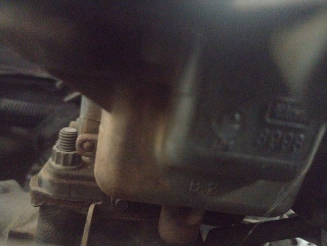

The numbers on the photo is 8998 there was also the numbers r50324 on the side of the car but no names.
Jan 20, 2022 at 5:19 PM
Okay. I cannot confirm what year that carb is but that is a Motorcraft 2-barrel carburetor.
There are master rebuild kits all over the internet so I am sure you can find one that can be shipped.
Basically, you are going to have to find a kit and then you may not use all the gaskets that are part of it, but you should be able to work your way through it.
When you rebuild it, you are going to want to loosen those 3 torques screws on the choke and adjust the choke so that it is closed when cold. Then adjust it to the point when it starts.
Also, you are going to want to soak the carb overnight in parts cleaner. You can fill a pan, or most parts stores sell paint can sized buckets full that you can soak them.

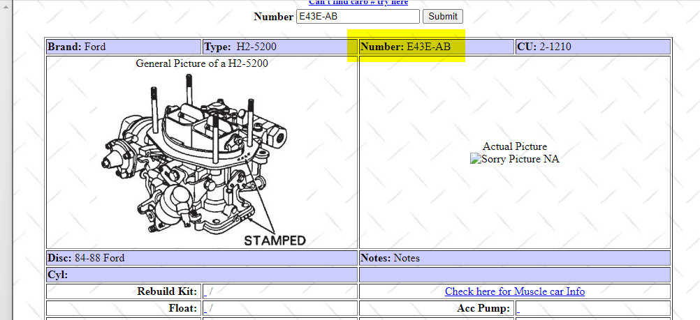

Actually, after hours if searching i actually believe it's a Holley Weber 5200c it was for the 2.3-liter motors in the late 70s on actually was used on a 2.3-liter Fords in 75 and 76 in the 85 Topaz 2.3 liter it was so e barrel carburetor for Canada and Mexico and fuel injected for the us.
Jan 20, 2022 at 6:46 PM

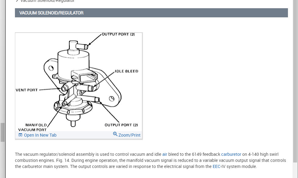

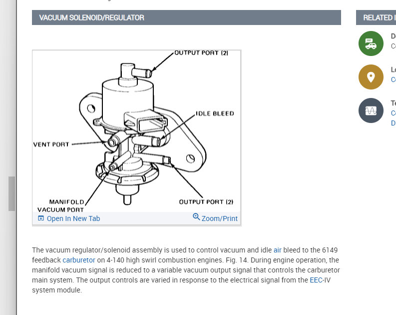

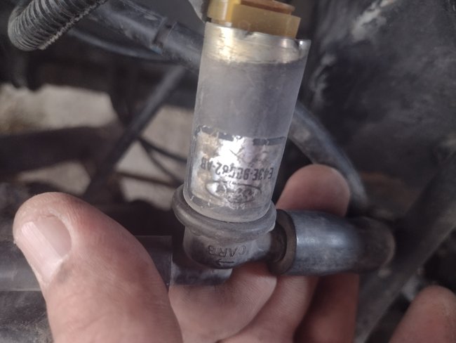

Yeah. It is a Motorcraft carburetor. That part number on the picture you just sent was for this carburetor as well.
Take a look at this attachment.

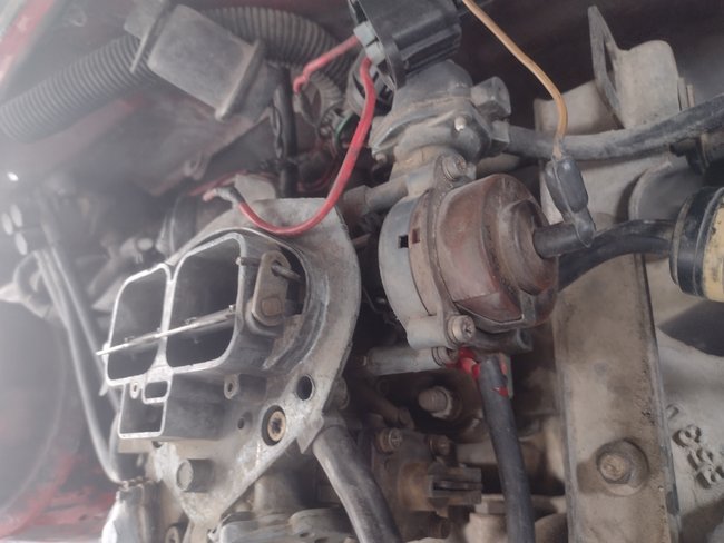

However, can you try to clean up that part number? I can see it is E43E- 92582-AB?
The E43E is the Motorcraft carburetor, but I suspect this is a sensor of some sort, but we can figure it out for sure once we confirm that part number.
Is the line that says "Carb" with an arrow a vacuum line or a fuel line?
Jan 22, 2022 at 3:57 PM
LGC
  • 27 POSTS
Vacuum.
Jan 22, 2022 at 4:19 PM

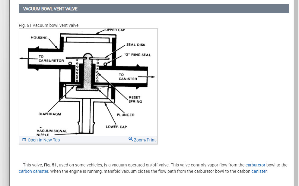

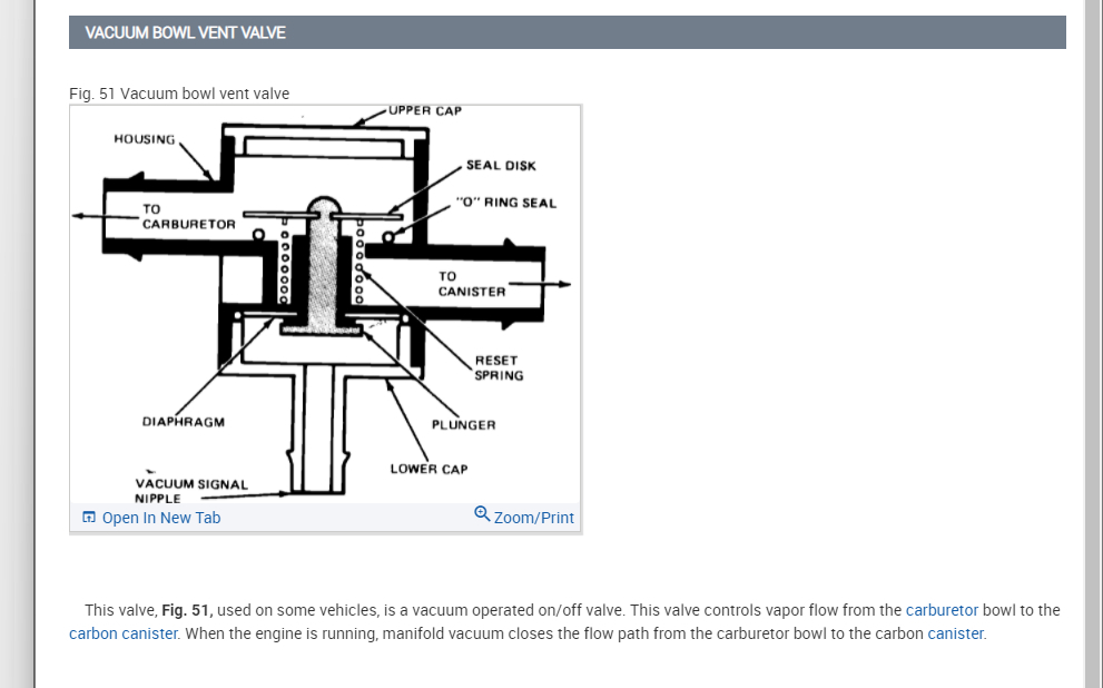

Okay. That is going to be a vacuum solenoid regulator. I attached the one that is on the stock carb but clearly this one is slightly different.
Jan 23, 2022 at 9:09 AM
LGC
  • 27 POSTS
The reason I asked because i did notice while trying to start the car it gets hot that part. Also, could you possibly find the wiring diagram for the electronic ignition for the 1985 Topaz i want to go through the wiring to check for shorts i can't seem to find one.
Jan 23, 2022 at 9:52 AM

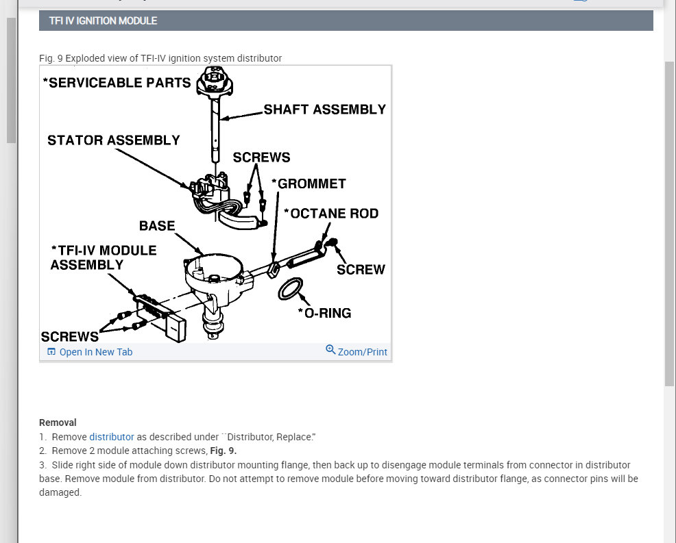

It is a solenoid so it will get warm but if it is getting hot then it could be shorted. It is unlikely that it is the issue, but you can try and unplug it and block the vacuum line to see if the engine starts. It could be the source of your additional air.

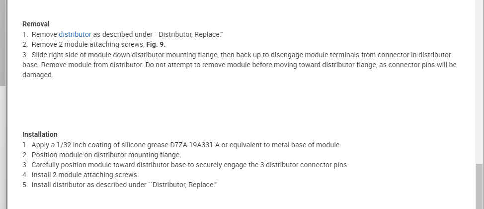

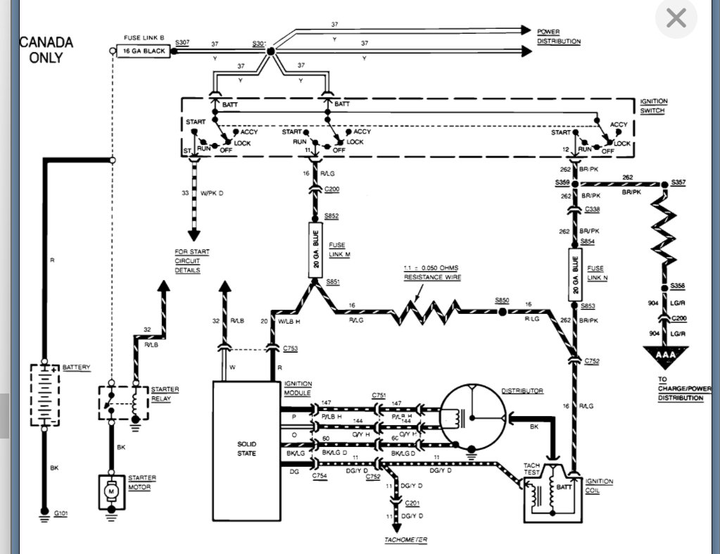

I attached the ignition related systems. If we need to get into that then we need to get a new post started so that others will find that detail as well and they won't think to look all through this post for ignition related info.
Jan 23, 2022 at 9:59 AM
LGC
  • 27 POSTS
The photos are not clear enough for me to read and i thank you for all your time and help with this matter.
Jan 23, 2022 at 10:07 AM
Unfortunately, we are at the mercy of the print quality they have online.
I will try and zoom in on them, but I am not going to be able to alter the fuzziness of the writing.
Do you have a phone that you can access the photos, because you can zoom in easily on your phone.
I will post what I can come up with.
