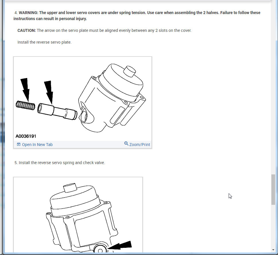

Hi, my vehicle runs and drives great shifts fine going down road and everything but when you put in into reverse it goes in; well i can hear it click in and it will start to go by itself when take foot off brake, but when i give it gas to go it wont go. What could it be? i was told low fluid but I have no clue?
Jan 11, 2021 at 6:20 AM

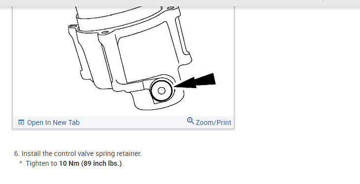

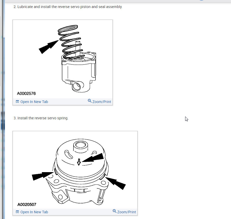

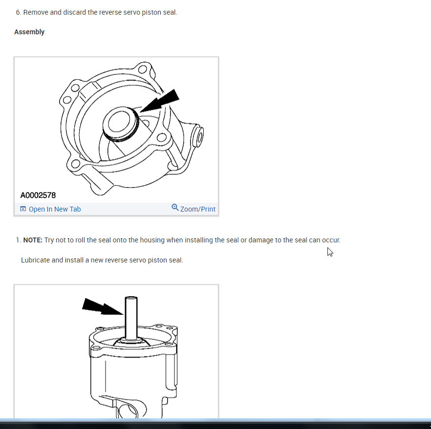

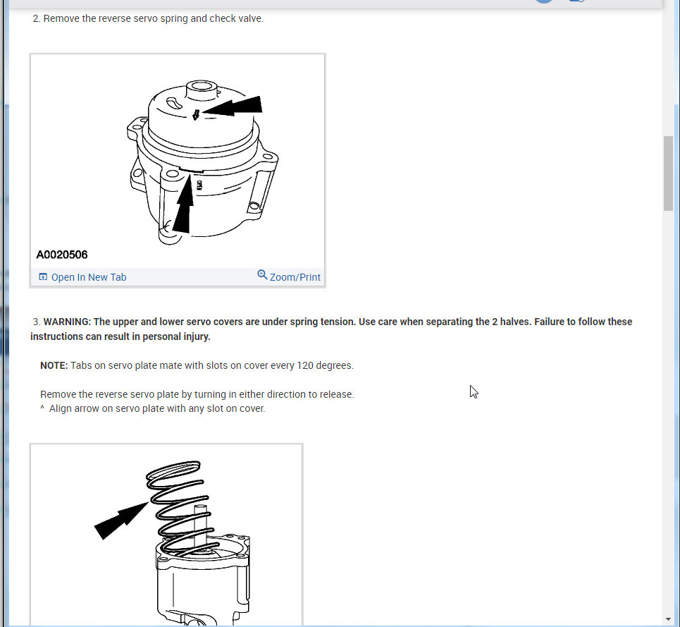

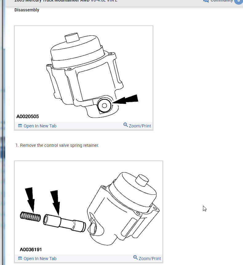

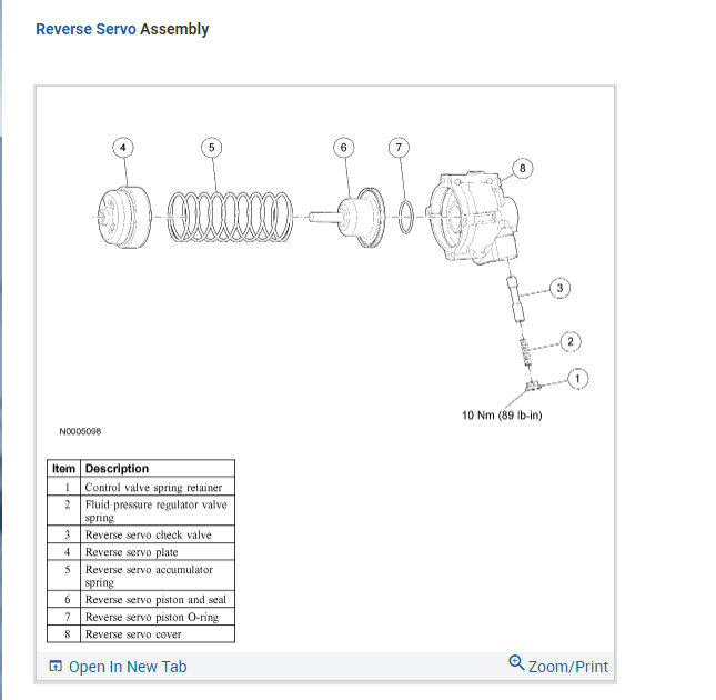

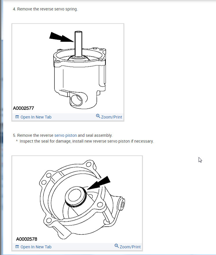

Low fluid would be the place to start but normally a fluid issue will effect other gears and not just reverse.
I suspect the reverse sero that applies the band that engages reverse is the issue. If you can hear it shift into reverse but it doesn't move, then the servo is just not applying the band enough to engage reverse.
I attached the process on how to replace this as I would start with this. Let me know what questions you have.
