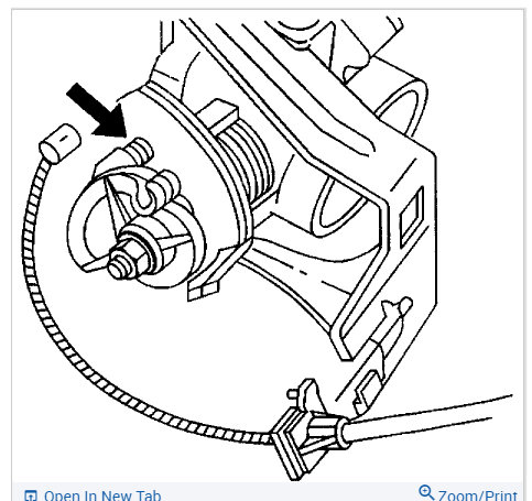

My car won't go over 40 MPH, it acts like something is pulling it back. I can push the pedal to the floor, and it won't go past 40 MPH. This is my only vehicle and I've got to get it fixed.
Why is it doing this?
Also, it has no catalytic converter.

We need to start with checking to make sure the throttle cable is correctly installed in the bracket of the throttle body so that when you press the accelerator it is getting the full travel.
You can do this by having someone push the throttle and you watch the throttle plate and make sure it is fully opening. The engine can be off to do this.
I attached a picture below of where this attaches.

The cable is working properly.

Okay. So, if it is not a mechanical issue then we have a sensor issue and more than likely this is a MAP sensor issue.
Were you able to check for codes? I imagine you have o2 sensor codes but if we have others then that will cut down on a lot of this diagnostic work.
Otherwise, we need to monitor the MAP with a scan tool while driving and see what the reading is to determine if this is seeing the correct amount of air coming in.
