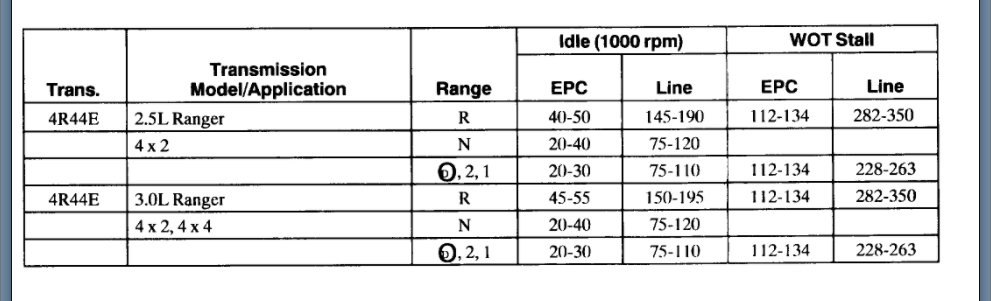

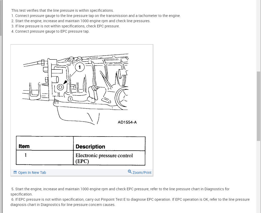

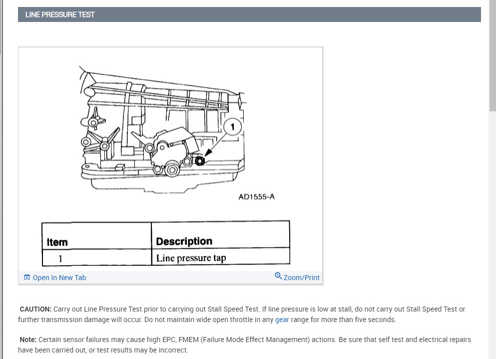

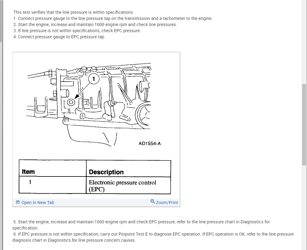

Basically, what is happening is you are losing pressure somewhere. Either due to an internal leak of the transmission, low fluid, or the pump is failing.
The fact that you can give it a little gas and it may engage means you are just raising the RPM of the pump and it is building the pressure enough to get it to engage the gear.
To confirm this, we need to check the pressure using the attached info from the manual.
Please let us know what you find with this, and we can go from there. Thanks

Neutral = 150 PSI
Drive = 180 PSI
Reverse = 210 PSI
High?
Dec 10, 2021 at 11:07 AM

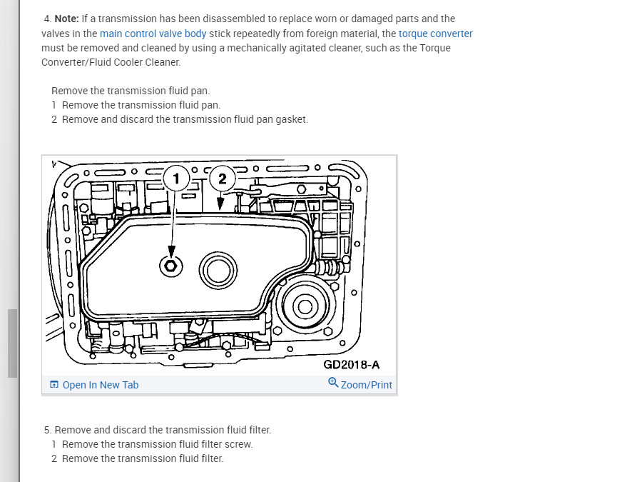

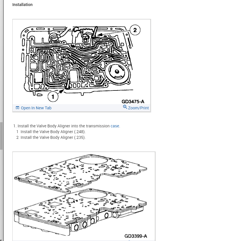

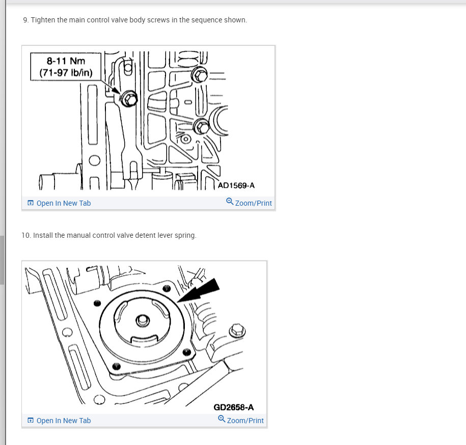

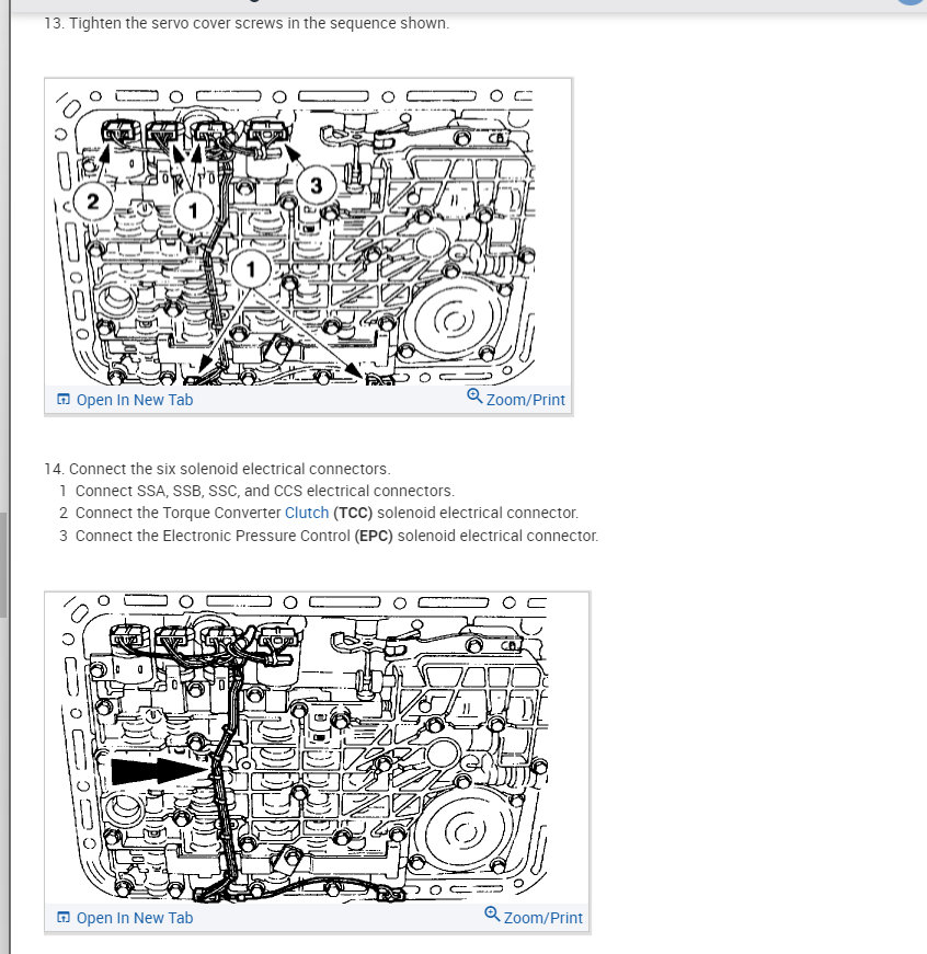

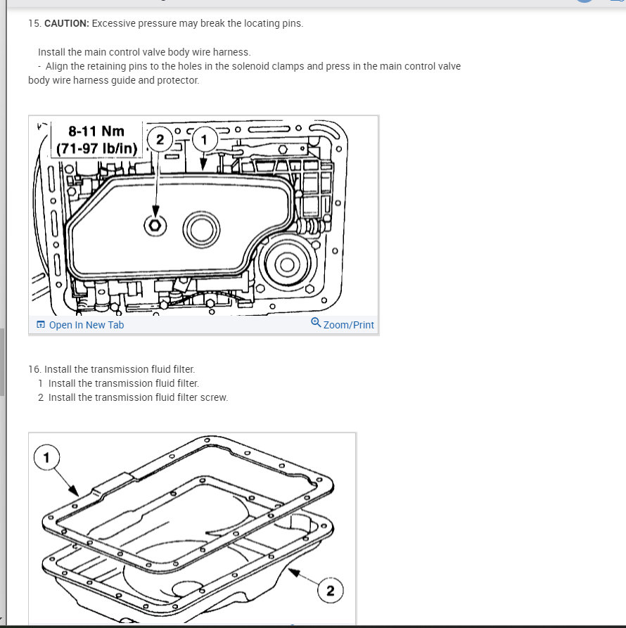

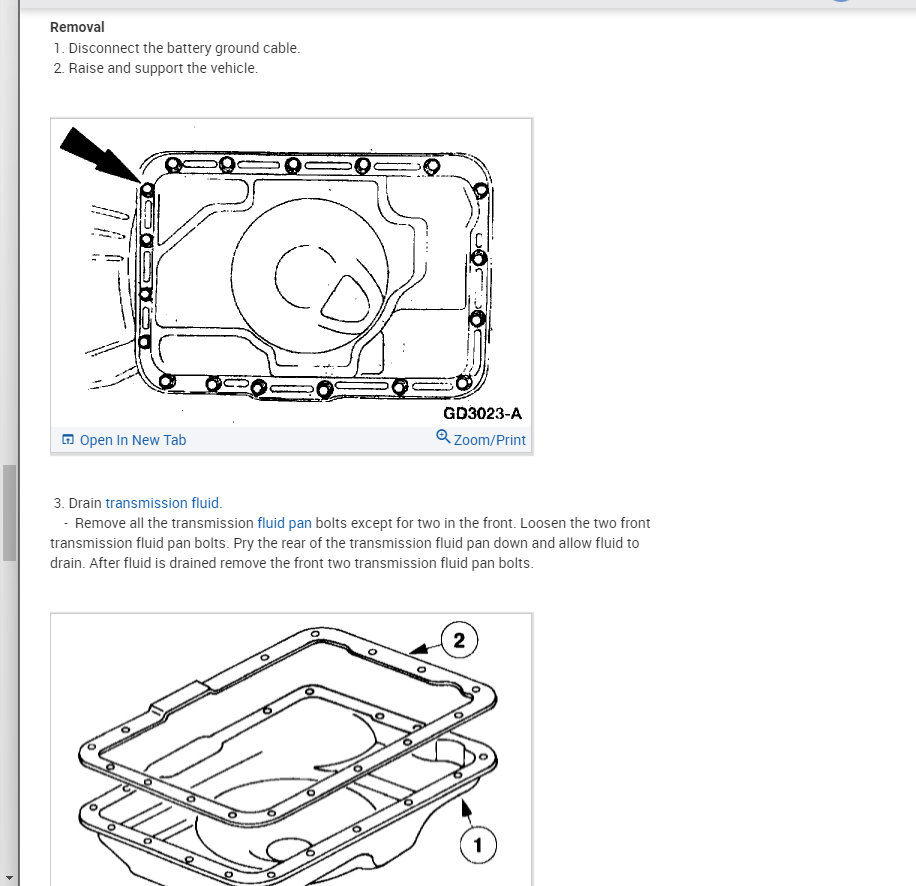

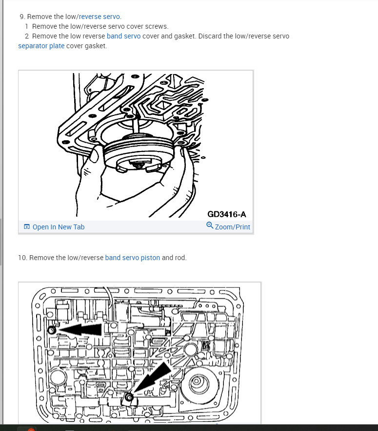

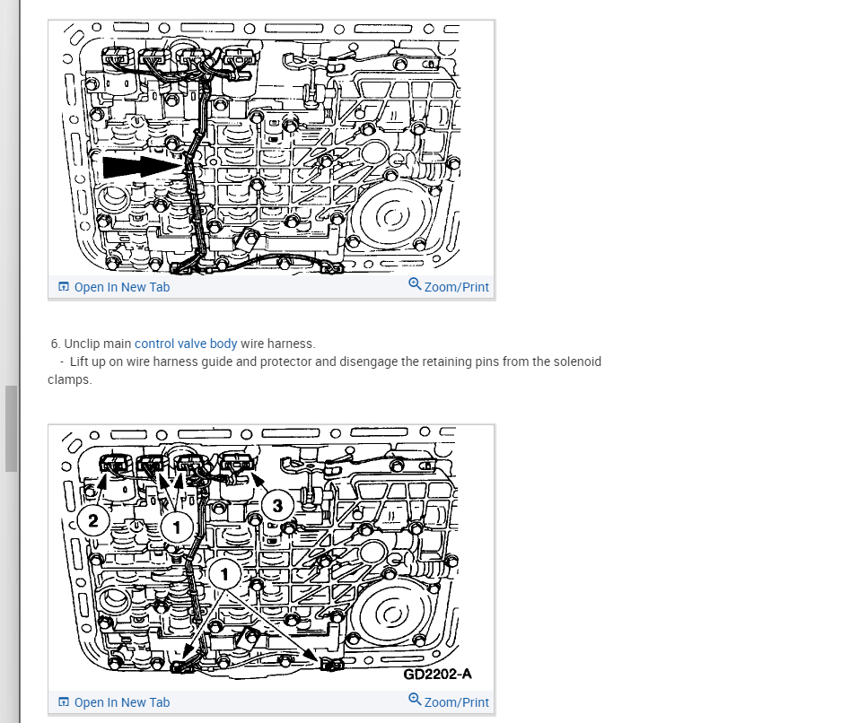

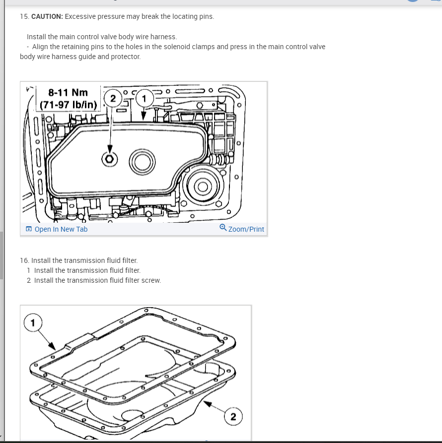

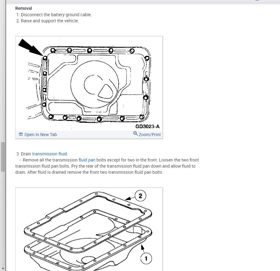

Yeah. If these were at idle, then you have high line pressure. It is odd that you have no engagement or movement as that is normally an issue from low pressure.

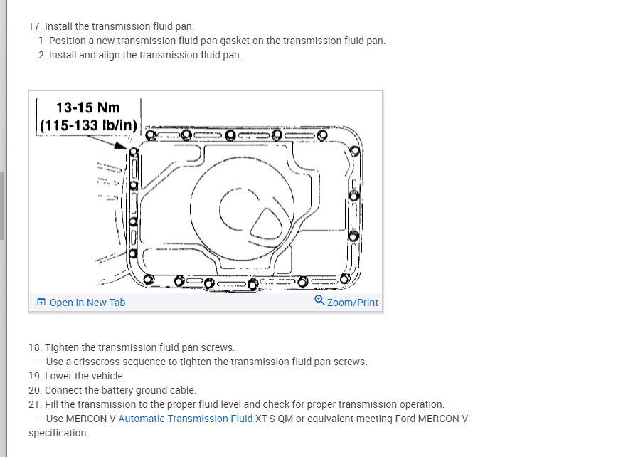

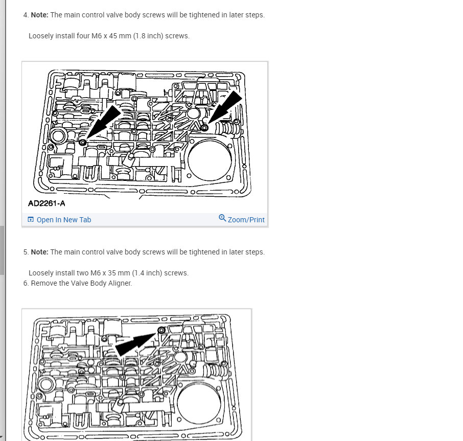

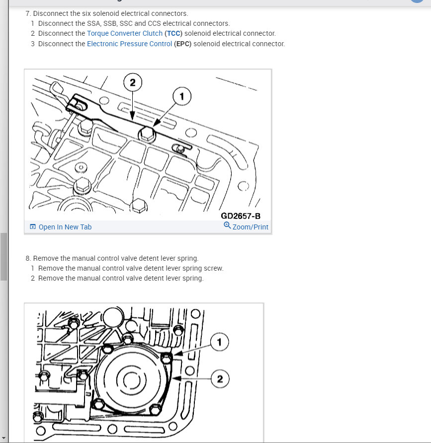

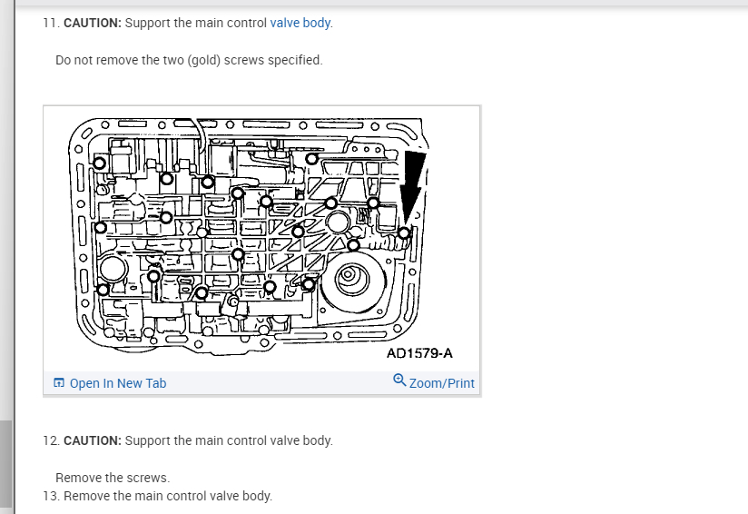

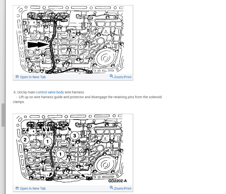

However, the causes of high pressure are low fluid levels or sticking solenoid valves in the valve body.
If it were me, I would drop the pan and see how much metal is there and then remove the valve body and inspect the valves.

Yes, high pressures surprised us as well. Looks like we will drop the pan and look at the solenoids.
