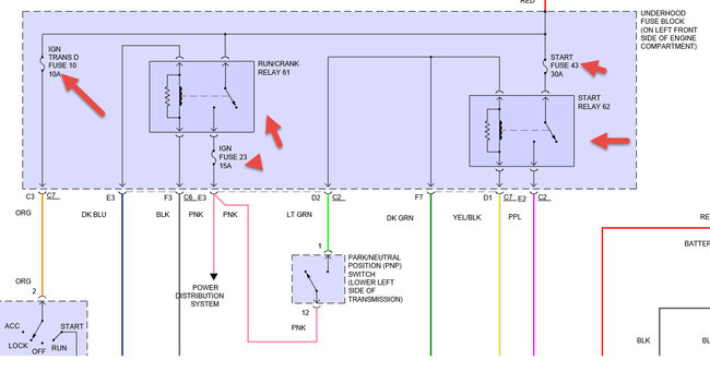

2006 canyon wont crank, not getting fuel to top of engine. engine light comes on for a couple seconds but is very dim. checked fuses ,starter ,and relays please help

try resetting security system if no manual look online

Tried that . Also hooked scanner to it and it said connection error

the connection may be at the aldl you are porbably going to have amechanic see why no power is coming to it so a scanner will work. but before you do that check items in pic also check all fuses under hood fuse box.

Thanks a lot for help . Found problem .. Fuse box had several loose solenoids that were not making contact. Changed fuse box now runs
