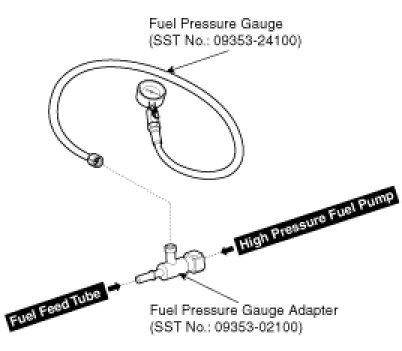

COMPONENT TESTS AND GENERAL DIAGNOSTICS
Fuel Pressure Test
1. Release the residual pressure in fuel line .
CAUTION:
When removing the fuel pump relay, a Diagnostic Trouble Code (DTC) may occur. Delete the code with the GDS after completion of "Release Residual Pressure in Fuel Line" work.
2. Install the Special Service Tool (SST).
(1)Disconnect the fuel feed tube from the high pressure fuel pump.
CAUTION:
There may be some residual pressure even after "Release Residual Pressure in Fuel Line" work, so cover the hose connection with a shop towel to prevent residual fuel from spilling out before disconnecting any fuel connection.
(2)Install the special service tool for measuring the fuel pressure in between the fuel feed tube and the high pressure fuel pump .
pic 1
3. Inspect fuel leakage on connections among the fuel feed tube, the high pressure fuel pump, and the SST components with IG ON.
4. Measure Fuel Pressure.
(1)Start the engine and measure the fuel pressure at idle.
Fuel Pressure:445 - 455 kPa (4.5 - 4.6 kgf/cm2, 64.5 - 66.0 psi)
NOTE:
If the fuel pressure differs from the standard value, repair or replace the related part .

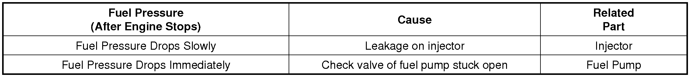

(2)Stop the engine, and then check for the change in the fuel pressure gauge reading.
Standard Value:The gauge reading should hold for about 5 minutes after the engine stops
NOTE:
If the gauge reading should not be held, repair or replace the related part .
pic 3

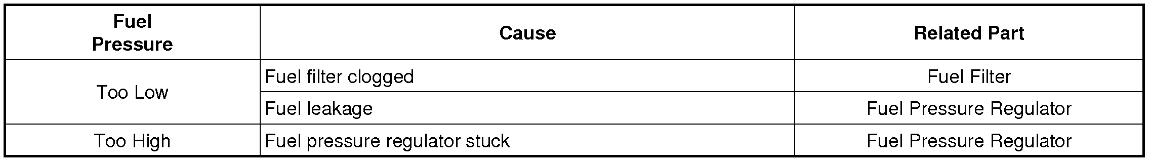

Fuel Pressure:480 - 520 kPa (4.9 - 5.3 kgf/cm2, 69.6 - 75.4 psi)
NOTE:

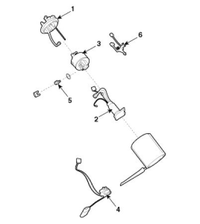

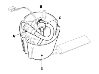

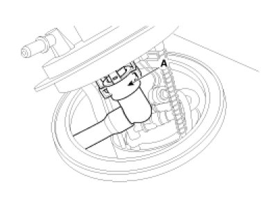

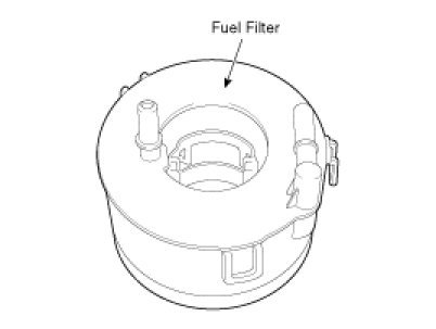

If you find the fuel filter or the pump is the issue, here are the directions for replacement. Note that to replace the filter, you have to remove the fuel pump from the tank. Note, if you have to replace the fuel pump, make sure to do the filter at the same time.
2013 Hyundai Sonata L4-2.4L
Removal and Replacement
Vehicle Powertrain Management Fuel Delivery and Air Induction Fuel Filter Service and Repair Removal and Replacement
REMOVAL AND REPLACEMENT
Replacement
1. Remove the fuel pump .
2. Disconnect the electric pump wiring connector (A) and the fuel sender connector (B), and then remove the fuel sender (C).
3. Disconnect the fuel tube quick-connector (D).
4. Remove the head assembly (E) after releasing the fixing hooks.
pic 7

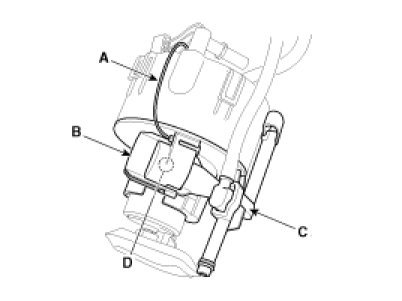

5. Disconnect the fuel feed tube quick-connector (A).
6. Remove the fixing clip (B), and then disconnect the fuel tube (C).
7. Remove the reservoir-cup (D) after releasing the fixing hooks.
pic 8

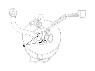

8. Disconnect the ground cable (A).
9. Remove the cap (B), and then remove the assist pump (C) and the fuel pressure regulator (D).
pic 9
CAUTION:
Be careful of O-ring.

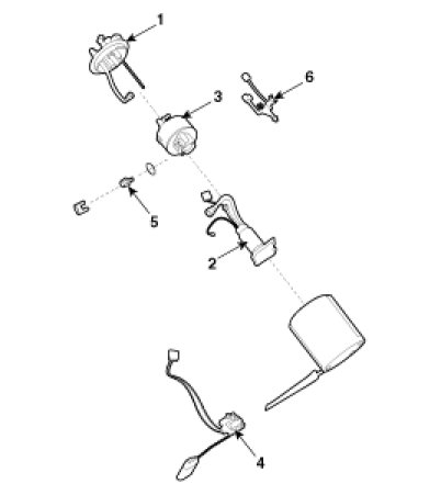

10. Separate the electric pump motor from the fuel filter after releasing the fixing hooks (A).
pic 10
pic 11
pic 12
1. Head Assembly
2. Electric Pump Motor
3. Fuel Filter
4. Fuel Sender
5. Fuel Pressure Regulator
6. Assist Pump

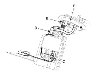

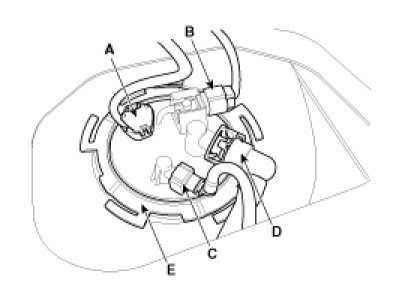

Here are the directions for removal and replacement of the pump assembly.
Fuel Pump
Vehicle Powertrain Management Fuel Delivery and Air Induction Fuel Pump Service and Repair Removal and Replacement Fuel Pump
FUEL PUMP

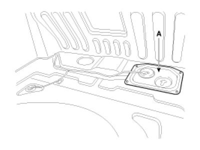

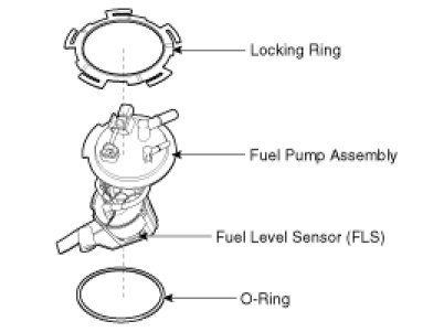

Removal
2. Remove the fuel pump service cover (A) in the trunk.
pic 13
3. Disconnect the fuel pump connector (A) and the fuel tank pressure sensor connector (B).
4. Disconnect the fuel feed tube quick connector (C) and the vapor tube quick-connector (D).
5. Remove locking ring (E) by use the special service tool [SST No. : 09310-2S200].
pic 14
6. Disconnector the vapor tube quick-connector (A) at the fuel pump, and then remove the fuel pump from the fuel tank.
pic 15
pic 16

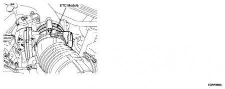

HI i have taken code from computer they are as follows: 2106, 1295, 2135. i need the problems for these codes and any information.
Mar 19, 2021 at 9:45 AM (Merged)
DOCFIXIT
  • CAR REPAIR CONTRIBUTOR
  • 18,828 POSTS

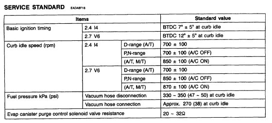

Hi All codes are for faults in Electronic Throttle Control to determine if replacement is needed a diagnostic scan of codes will be needed. Location see diagram
https://images.2carpros.com/forum/automotive_pictures/198357_Graphic_551.jpg
Hope this helps Thanks for donate

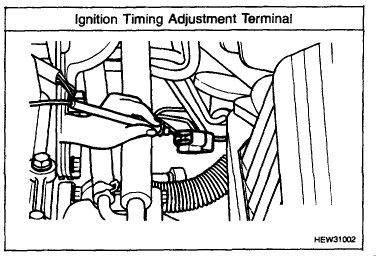

Hi and thanks for using 2CarPros.com. You have already done a lot of work and eliminated many of the possible problems. However, I have to ask if you checked engine timing as well as the catalytic converter to see if it is plugged.
To start, here are general symptoms of a plugged converter:
Here are general directions to check one:
As well as a video:
https://youtu.be/kNXh1Lphzr4
I realize the ignition timing is controlled by the PCM, but here are the specs for where it should be. (see attached picture 1)
In addition, there is a ignition adjustment cable you should check if timing is an issue. Make sure it is getting power, is clean and tight, and no damage to the wiring. See attached pictures for location. I have also attached pictures of many of the sensors located under the hood because if the converter and timing check good, I want you to get a live scanner and check the coolant temperature sensor. (CTS). It tells the PCM the engine's temperature and from that, the computer adjusts air and fuel mixture. If it is too rich or lean due to an inaccurate reading, it will cause drive-ability problems.
I hope this helps. Let me know if you have other questions as well as what you find.
