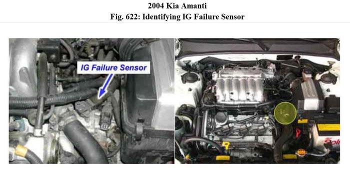

ANBER14
Suv will turn over but no firing? Can you help me?
Jan 10, 2016 at 7:02 AM
WRENCHTECH
  • 20,761 POSTS
This sounds like you have a crankshaft angle sensor tha5t is out but to be sure this guide will walk us through the repair.
Jan 10, 2016 at 7:20 AM
SAM.SMALL
WRENCHTECH nailed it on my car I had to get a new crankshaft angle sensor cost me $122.00 all fixed! I love this site.

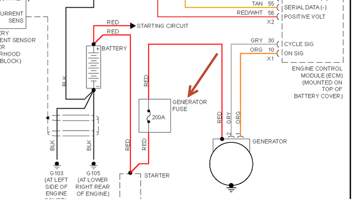

Oct 30, 2019 at 11:27 AM (Merged)
LANIECEMILAN
  • 5 POSTS
I forgot to mention that part. All fuses are intact. Every fuse was pulled. I asked the dealer about disabling the anti theft they said they don't know. I had it towed from the local mechanic to the dealer this morning
HMAC300
  • 48,601 POSTS
that is pretty sad when a dealer doesn't have anyone that knows about anti theft. a scanner will pick it up if there is something amiss with it however. i'm sending a diagram of a fuse that may have burnt up but not checked it is a 200 amp one and is designed to protect the system it goes off the alternator. check that as well
