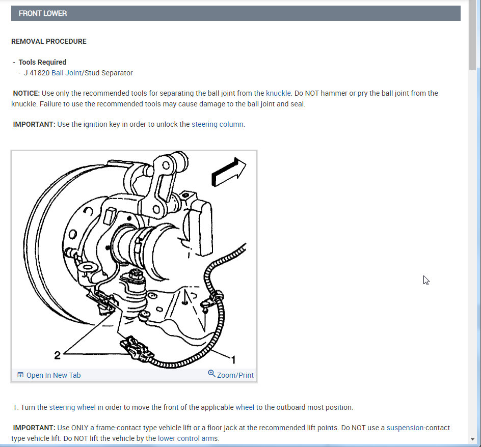

That is great that you found that. If the lugs were tight then that was the next thing we were checking.

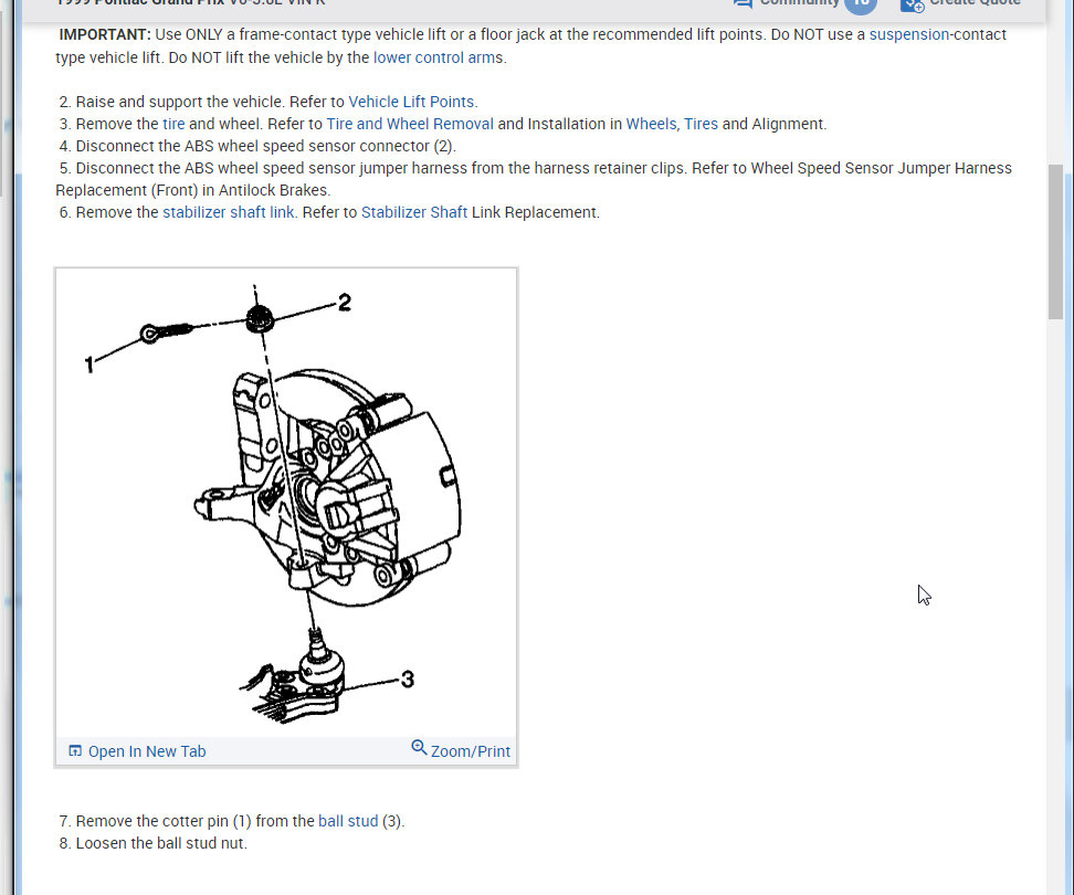

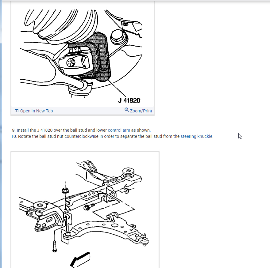

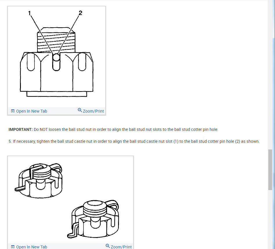

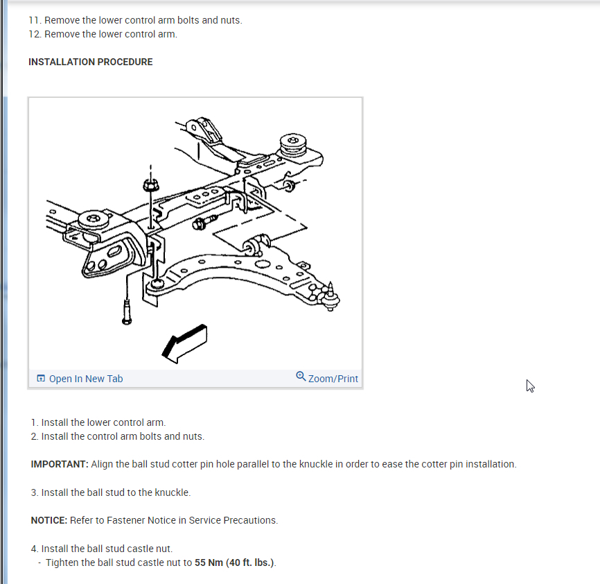

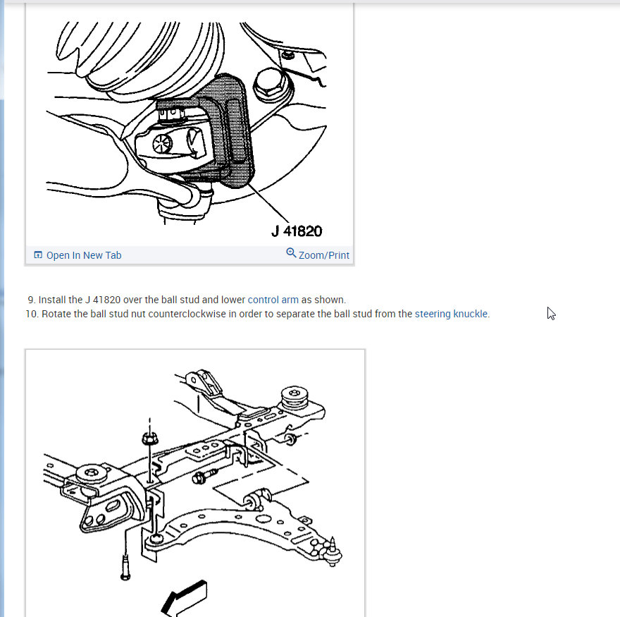

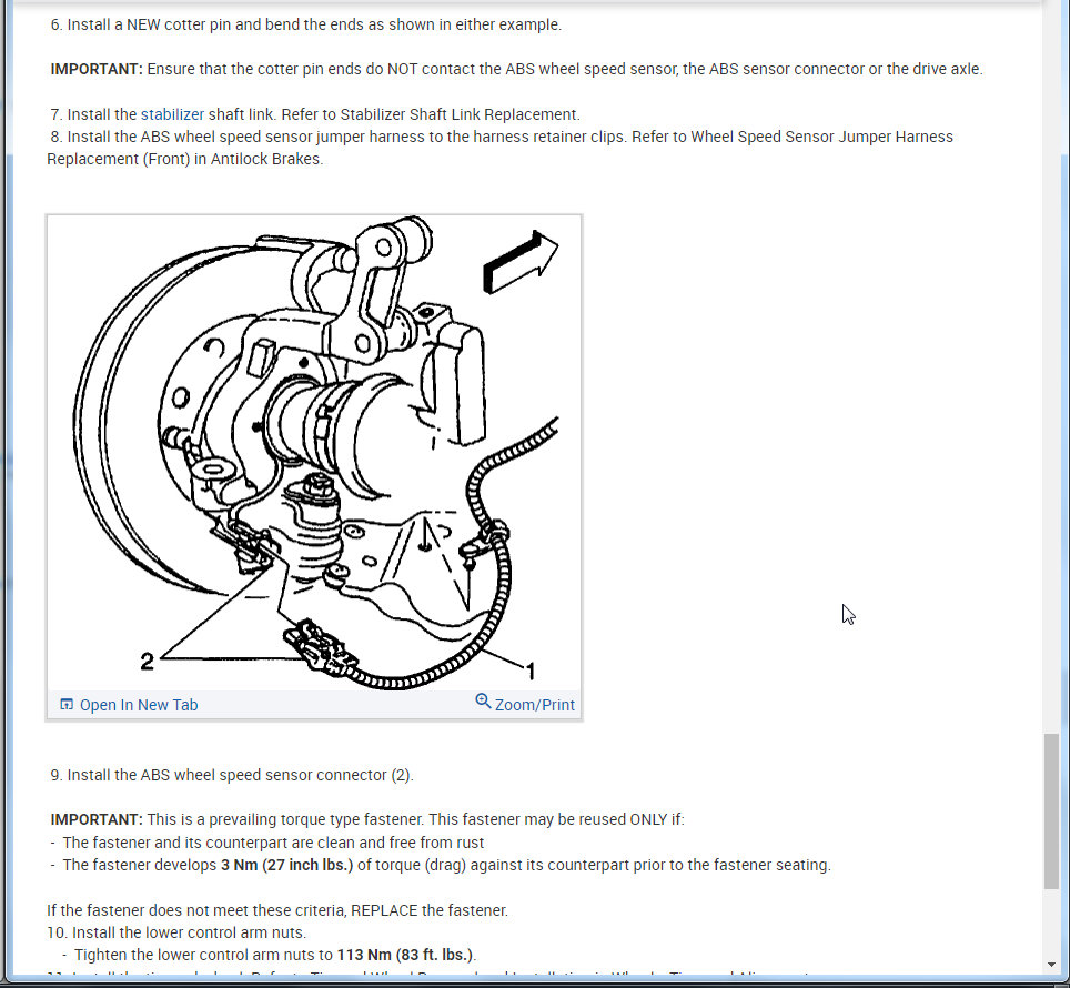

So that means it is most likely the lower ball joint which means the control arm needs to be replaced. I am attaching the process below of the control arm.
