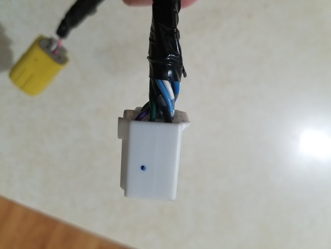

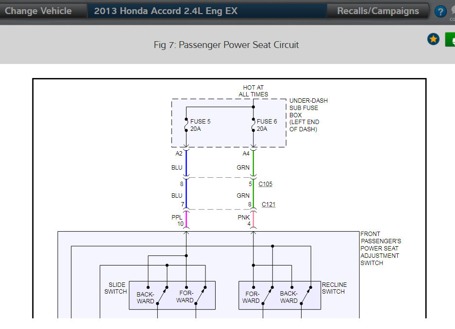

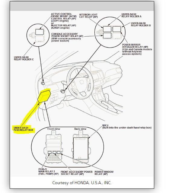

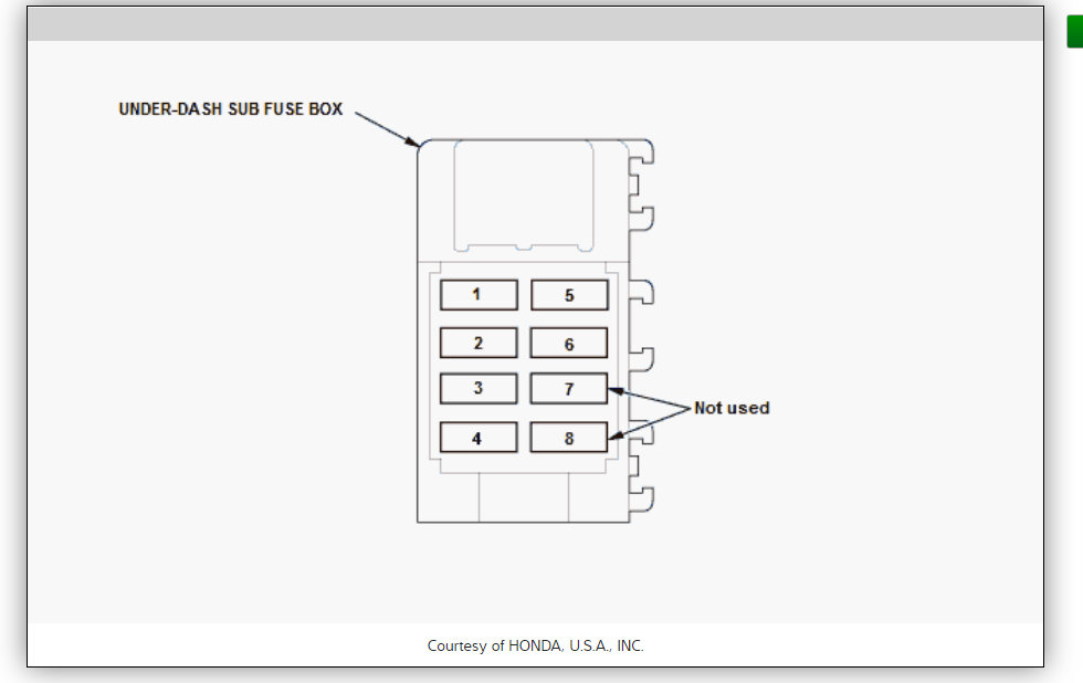

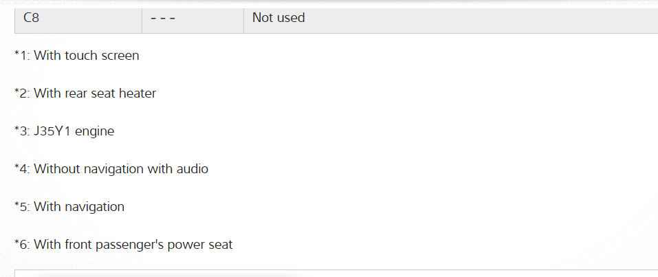

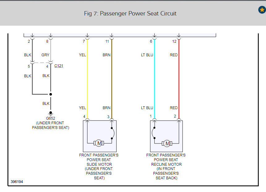

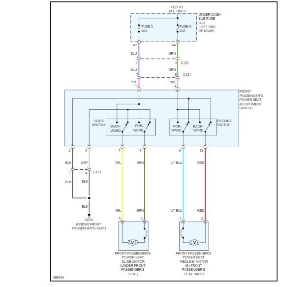

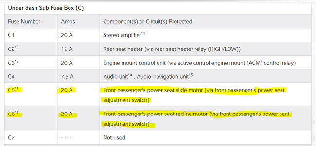

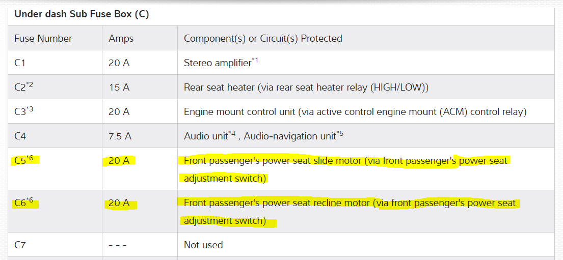

Hi, I have a Sport model with a maual passenger seat and purchase a electric passenger seat from a 2013 Honda Accord EX-L 4 cylinder engine. Would you be able to help me rewire from the manual seat to the plugins for the electric? What I'm thinking is all I would have to do is add 2 power lines with 20 amp fuses from the fuse block to the 2 switches for forward and back and tilt forward and back. This seat doesn't have the other functions that the drivers seat does which is why I wanted to do this. Honda passenger seats suck in every way. If it's not feasible I'll throw the electric one away and suffer on my 3,000 mile trip in October. Thanks, Phil
Aug 10, 2019 at 11:12 AM
SCGRANTURISMO
  • 4,897 POSTS
That is correct. The two power wires coming into pins #4 and 10 of the Power Seat Connector are both 20A fused circuits. You will also need to run ground wires from pins #2 and 8 of the Power Seat Connector to a ground. You can use a self tapping screw and make your own, just make sure all the paint is removed where you are placing the ground, to make good metal to metal connection, a toothed star washer would be preferred(not a necessity), but ring connectors for the wires are required. Also a little dielectric grease will help prevent corrosion from building up on the ground. In the diagrams down below I have included all the information that you will need. Please get back to us with how everything turns out.
Thanks,
Alex

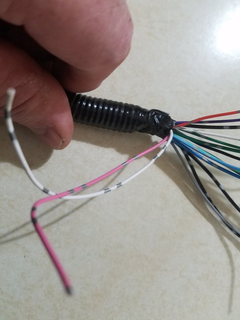

06SEACCORD
Interior problem
2006 Honda Accord 4 cyl Front Wheel Drive Automatic 17k miles
I've had my car in the shop for ages as the mechanics were looking for a refurbished cloth seat to replace the previous cloth manual seat. However, when the seat was delivered, it was a POWER seat (heated, forward/back, up/down, airbags & seatbelt sensor).
The mechanics connected all the electrical leads but the seat is completely unresponsive, and the airbag warning indicators flash from time to time. The seat is currently in the full upright position, and as far forward as possible, making it impossible for anyone over 4 feet tall to squeeze in.
Is there something that I can do without taking it in to Honda to get the seat working? Or at least adjusted to a position where a human might fit in it? Honda is asking for $120 / hour in labor, even if they just inspect the vehicle.
Any suggestions would be much appreciated.
Aug 27, 2020 at 4:40 AM (Merged)

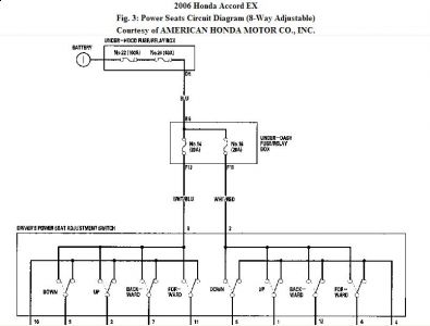

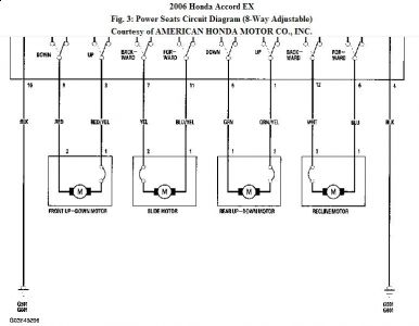

06SEACCORD
the original seat was manual, which had the levers to make it move forward and back. I've checked all the leads and there is one female adaptor on the seat but no male wire harness. any suggestions?
KHLOW2008
  • 41,812 POSTS
The wiring is rather simple for the powered seats and there are 2 types, 8-way adjustable or 2-way adjustable. I guessed yours should be 8-way and here are the wiring schematics and you should be able to hook them up.
https://images.2carpros.com/forum/automotive_pictures/192750_PowerSeat06Accord8way01_1.jpg
https://images.2carpros.com/forum/automotive_pictures/192750_PowerSeat06Accord8way02_1.jpg

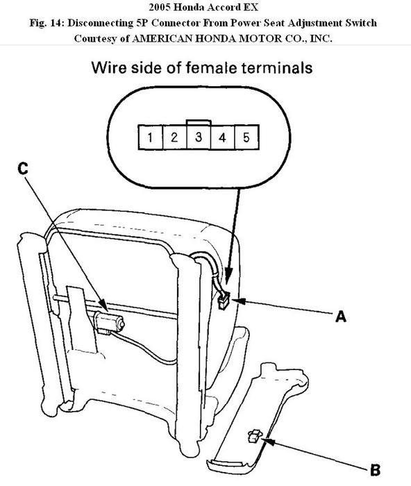

'05 Honda Accord Coupe. Power driver's seatback will come forward, but won't recline. Makes a clicking noise - don't see anything to prevent it from going backwards. Also, power passenger window does not work.
Appreciate your thoughts!

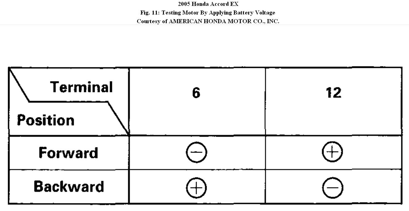

KHLOW2008
  • 41,812 POSTS

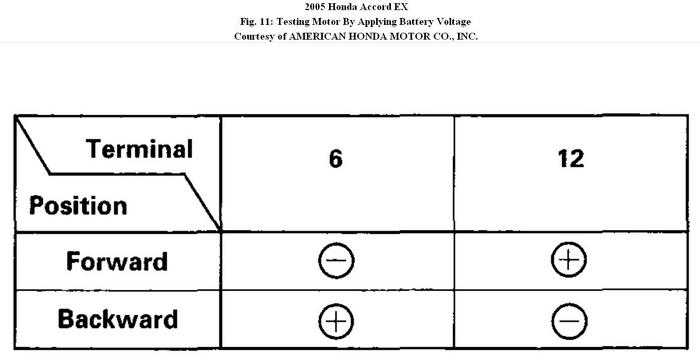

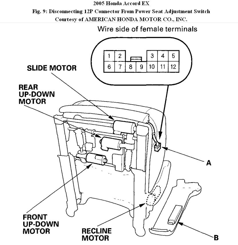

MOTOR TEST
DRIVER'S 8-WAY ADJUSTABLE POWER SEAT
1. Remove the driver's seat.
2. Disconnect the 12P connector (A) from the power seat adjustment switch (B).
3. Test each motor by applying battery voltage and body ground to the terminals.
4. If the motor does not run or fails to run smoothly, check for an open in the driver's seat wire harness between the 12P connector and each motor connector. If the harness is OK, replace the motor.
DRIVER'S 2-WAY ADJUSTABLE POWER SEAT
2. Disconnect the 5P connector (A) from the power seat adjustment switch (B).
3. Test the motor (C) by applying battery voltage to the 5P connector No. 2 (or No. 4) and ground to the No. 4 (or No. 2) terminals. The motor should run.
4. If the motor does not run or fails to run smoothly, check for an open in the wire between the 5P connector and the motor 2P connector. If the harness is OK, replace the motor.
© 2008 Mitchell Repair Information Co., LLC.

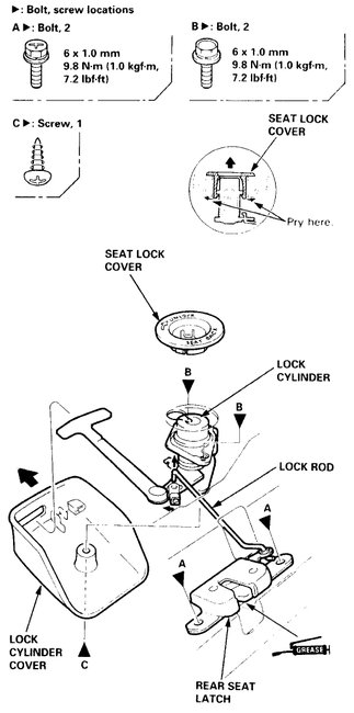

The rear seat is suppose to fold down giving access to trunk. There are two options, one insert key into slot at top of seat and turn clockwise. Two, open trunk and pull latch. I have tried both of these with no results. Do you have any suggestions as to how to get the back seat to fold down ?
Aug 27, 2020 at 4:42 AM (Merged)
STEVE W.
  • 15,384 POSTS
If the seat has not been folded down before it is possible the pivots have rusted and will not allow it to move. Or the latch is not releasing fully. Does it feel/sound like the latch is releasing when you turn the key? Does it feel any different if you push in on the seat as you turn the key?
The attached shows the latch assembly. The cover in the trunk area comes off with a screw. You could remove the cover and see if the latch rod and the rest of the parts are moving when you actuate the latch. It may just be corroded or possibly disconnected.
If the pivot at the bottom is moving and the lock rod is moving, take a pair of pliers and pull the lock rod a bit, it is possible it has gotten bent enough that it does not release the latch.
Good luck, please reply back with what you find.
