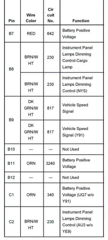

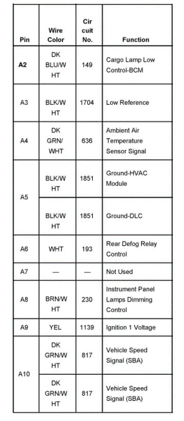

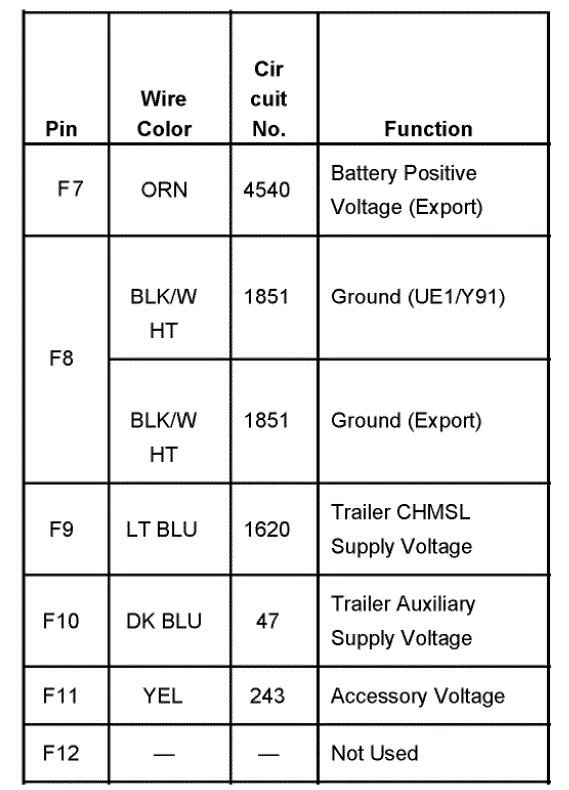

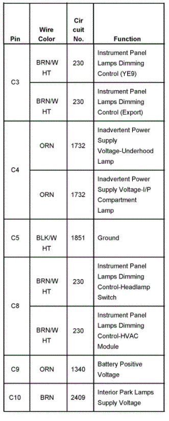

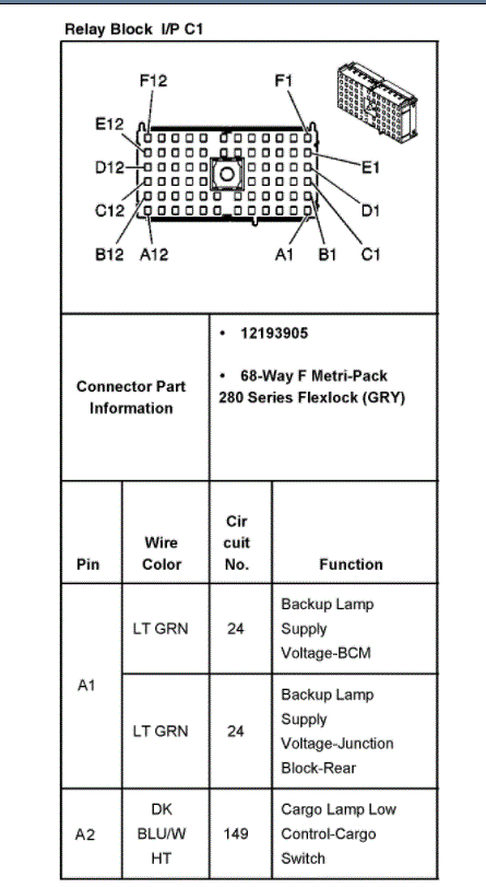

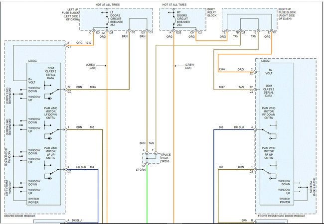

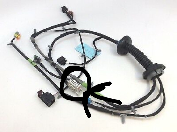

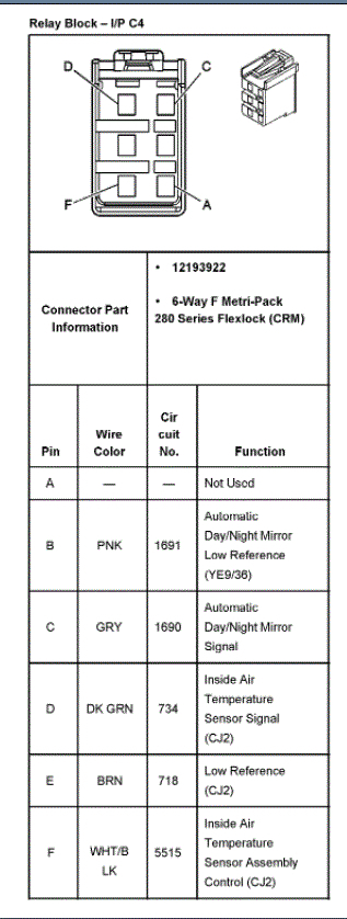

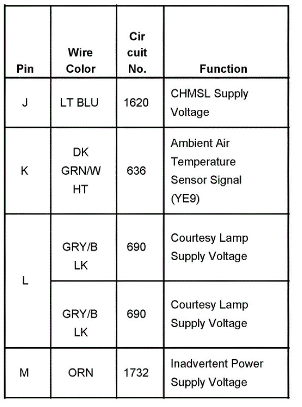

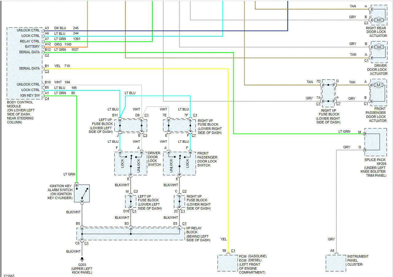

Hello, I would like to have the wiring diagram of the end of the wiring harness of a Silverado 2002 and 2003 of the picture below and c1 c2 c3 c4 pinout of left I/P and mid bussed electrical center and right bussed electrical center.

Like this but other c3,c2,c1.

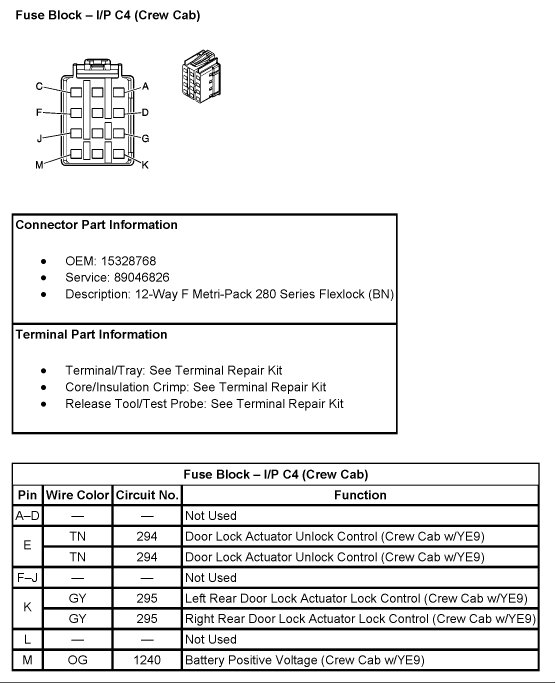

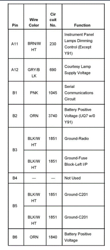

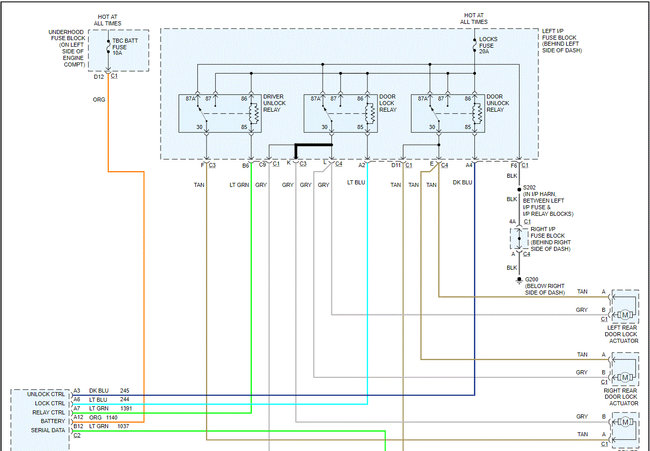

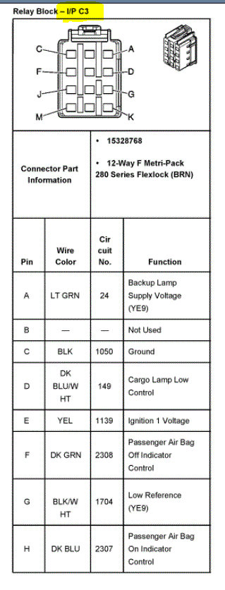

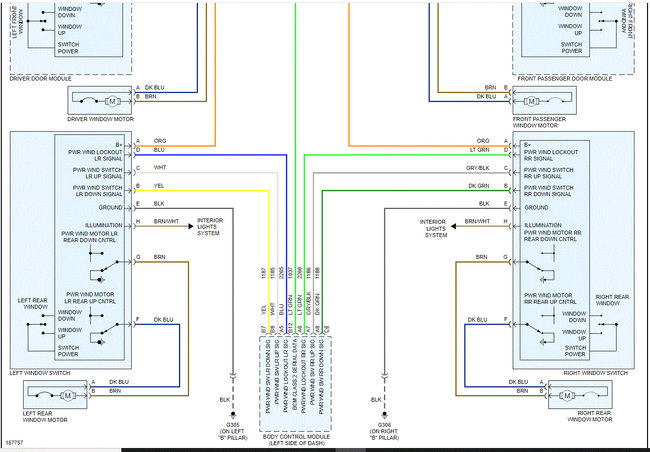

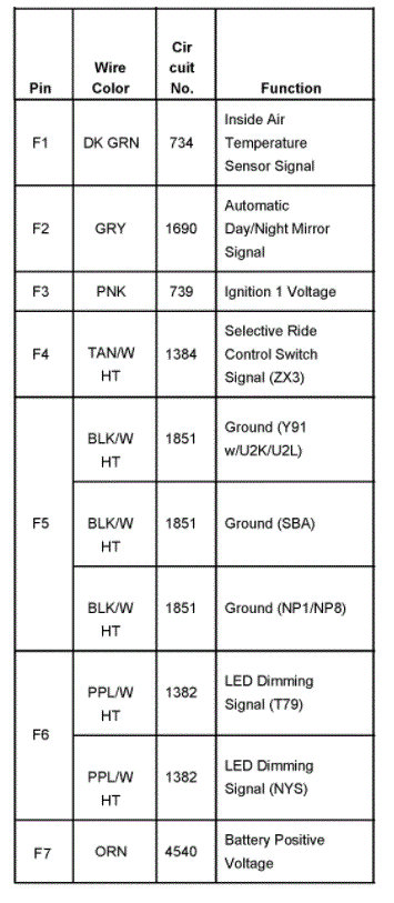

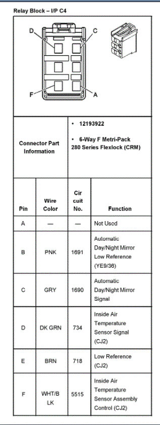

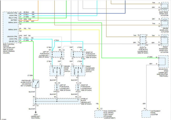

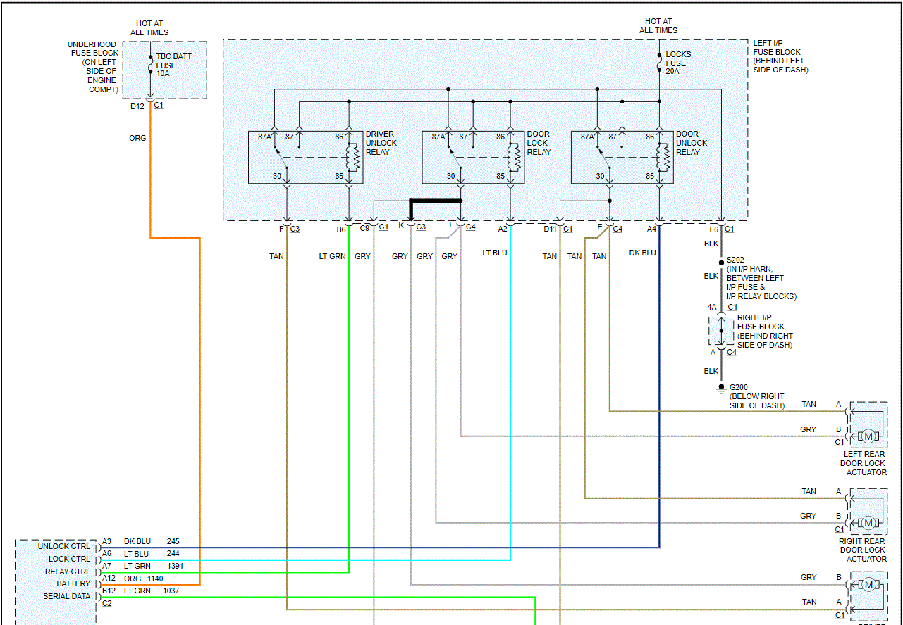

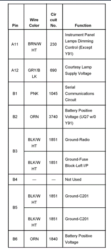

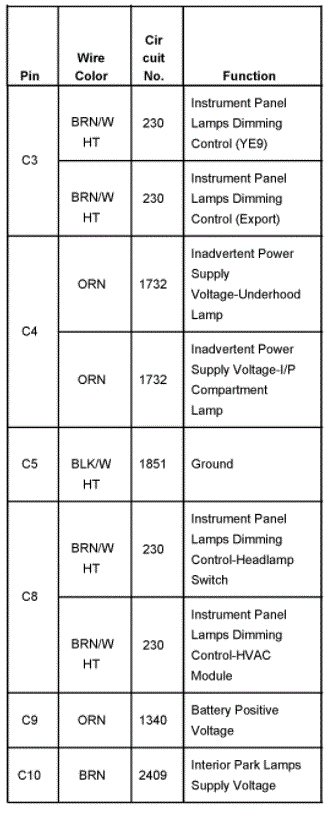

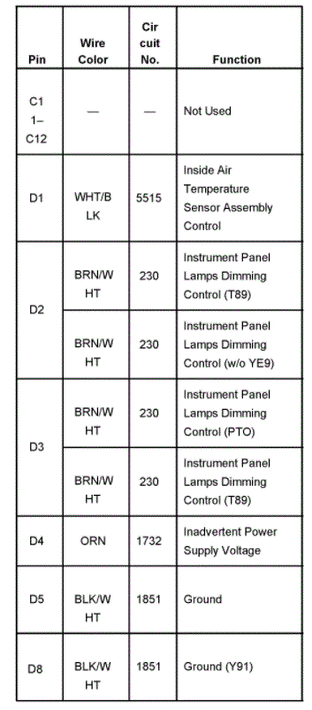

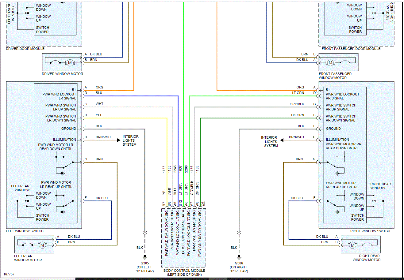

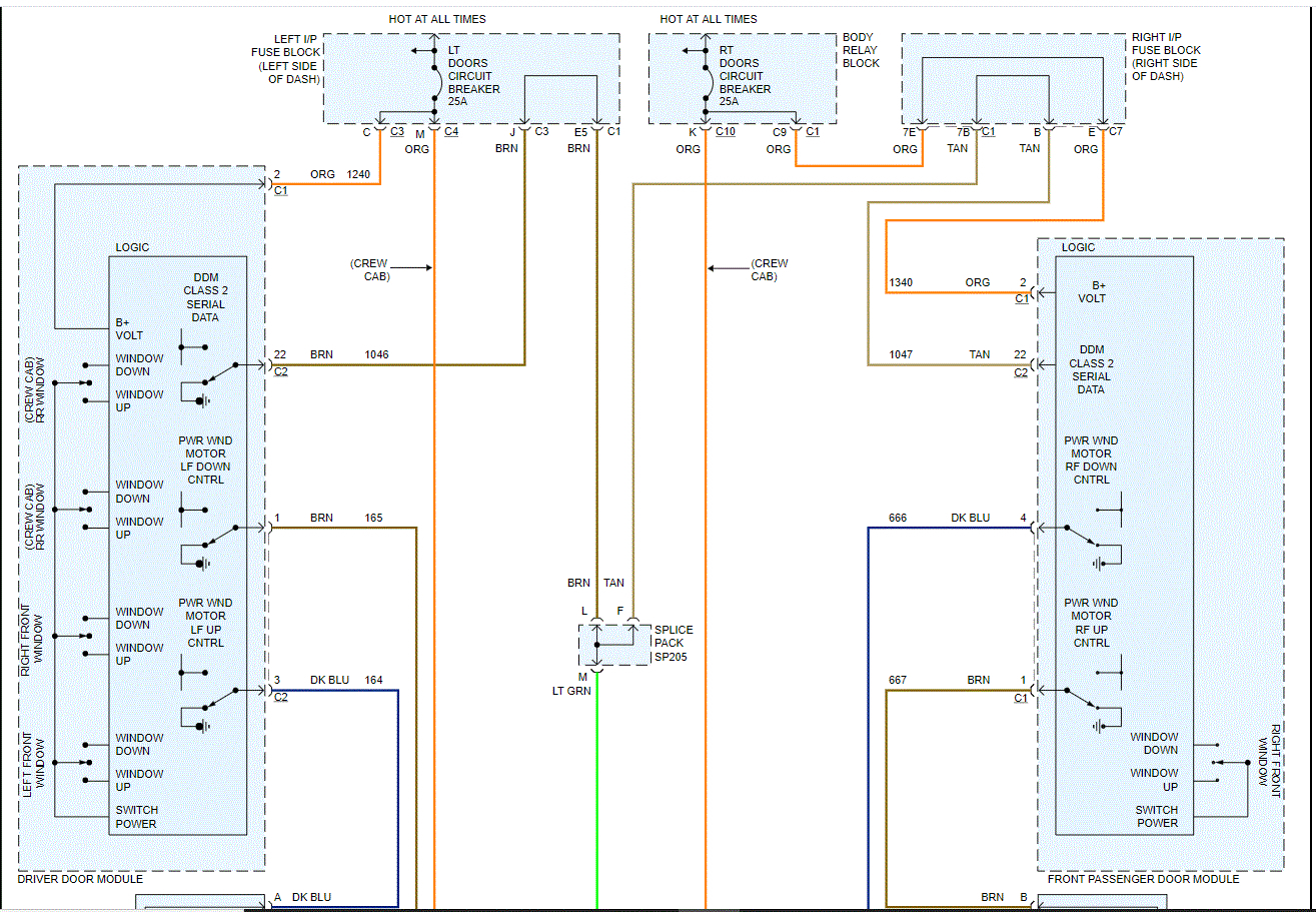

I attached the wiring schematic below for the power windows and locks below. You should be able to determine which pin to check based on the wire's color.
Pics 1 and 2 are the windows and pics 3 and 4 are the locks. Note that I had to cut each schematic in half to make it readable. I did overlap them so you can follow from one to the next.

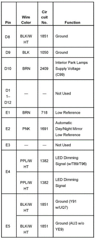

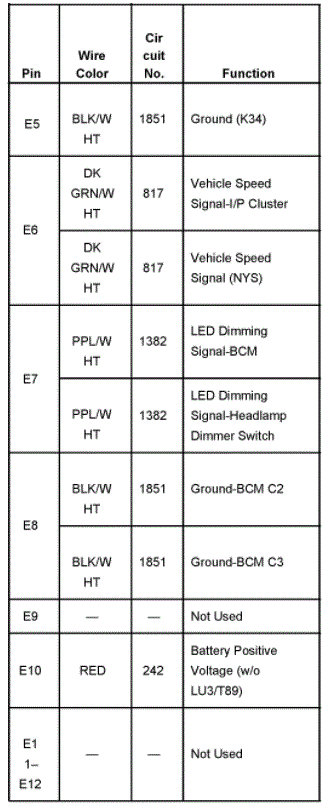

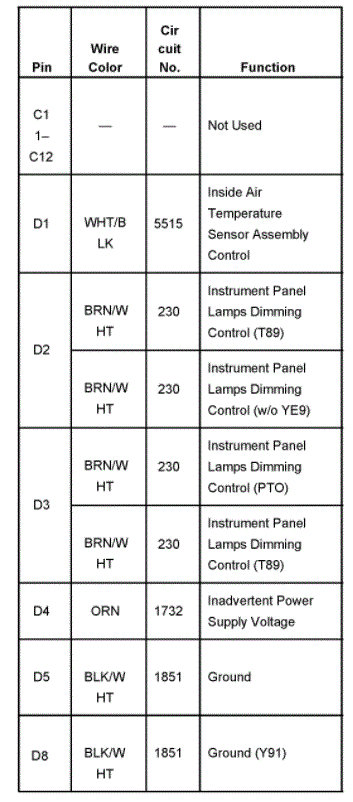

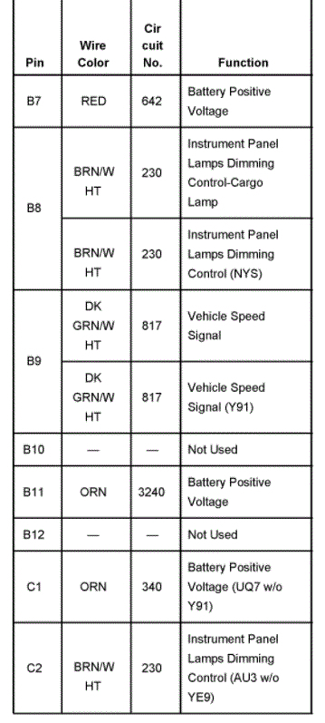

As far as the pinouts, I attached the C1 and C3. For some reason, I don't have the C2.
