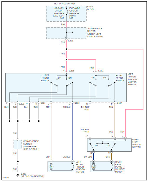

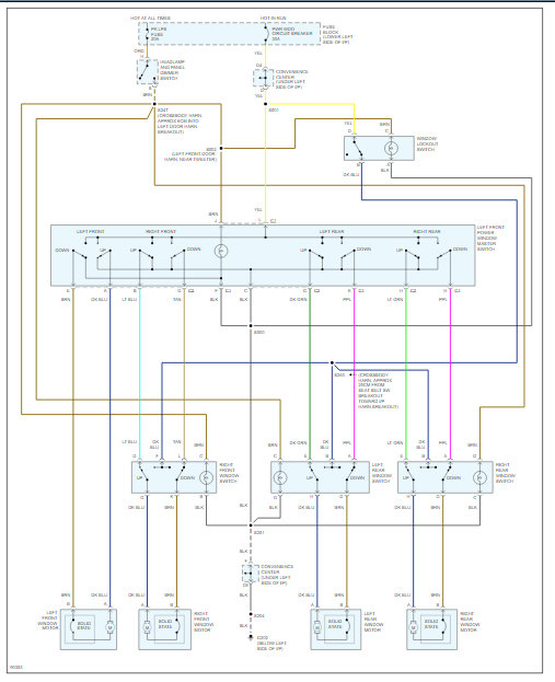

It has manual locks and windows. I have added power windows and locks withe the factory door harnesses.
I have not been able to locate a dash harness that has all of the same connectors ( plugs ) as mine has. I have pulled a few! And every BCM is different as well. So......

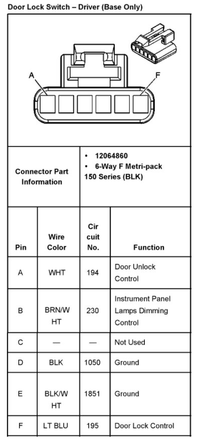

Is there a diagram of the actual switch pins for :
DS window switch
DS lock switch
DS power window switch
PS window switch
PS lock switch
If I can find out what each pin controls I can make the correct connections and add relays where needed
Hope this was enough info?
Thanks

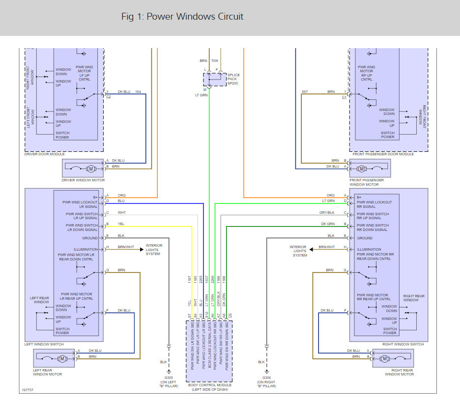

Here is a guide to help you test the wiring and the window wiring diagrams below.

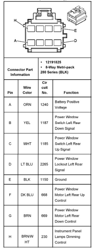

Driver and passenger door wiring, the plugs on the ends. There is 1 for the passenger door. There are 2 for the driver door.
I am looking to find out what each pin in the connector would control.
Example: 1st pin= ground, 2nd pin= hot all time, 3rd pin= accessory power etc......
In other words I will be hard wiring all the needed connections from the factory harness to the power window,locks and power mirrors I just need which wire does what so thanks for the wiring diagrams got it fixed it was a bad switch (main)

Understood. Here are the connector view diagrams for each of these components.
Please run through these and let us know if you need more info. Thanks

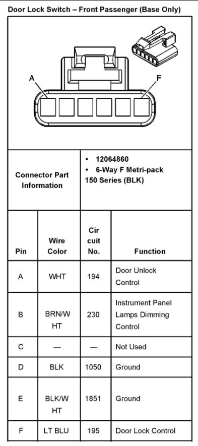

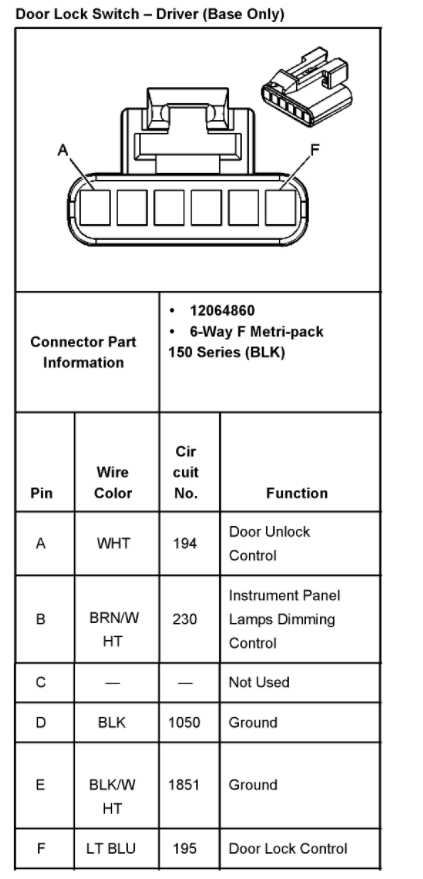

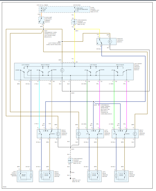

DADFIXIT

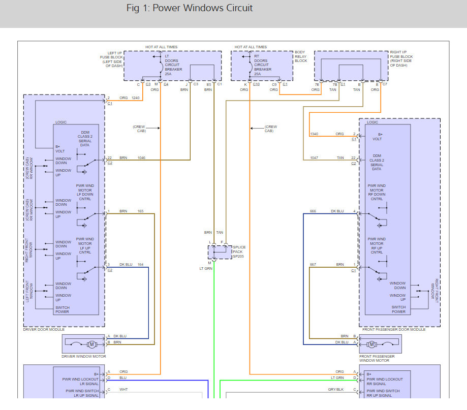

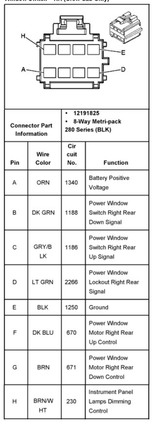

Swapped doors from 1997 Suburban need to make windows work. I need to put connector from old door to new door and splice correct wires.

Hello, I'm Danny.
Here is a quick wire testing tutorial to view:
I've attached 2 pictures below.First picture is your 1994 Silverado and the second is the 1997 Suburban.Hope this helps and thanks for using 2CarPros.
