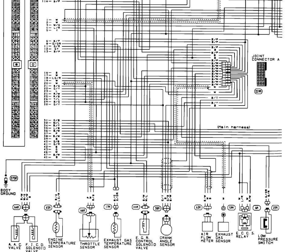

Had a fuel fire burnt engine wiring harness. found a partial used harness. I am needing a wiring diagram that shows wire color and location to splice in used wire loom.

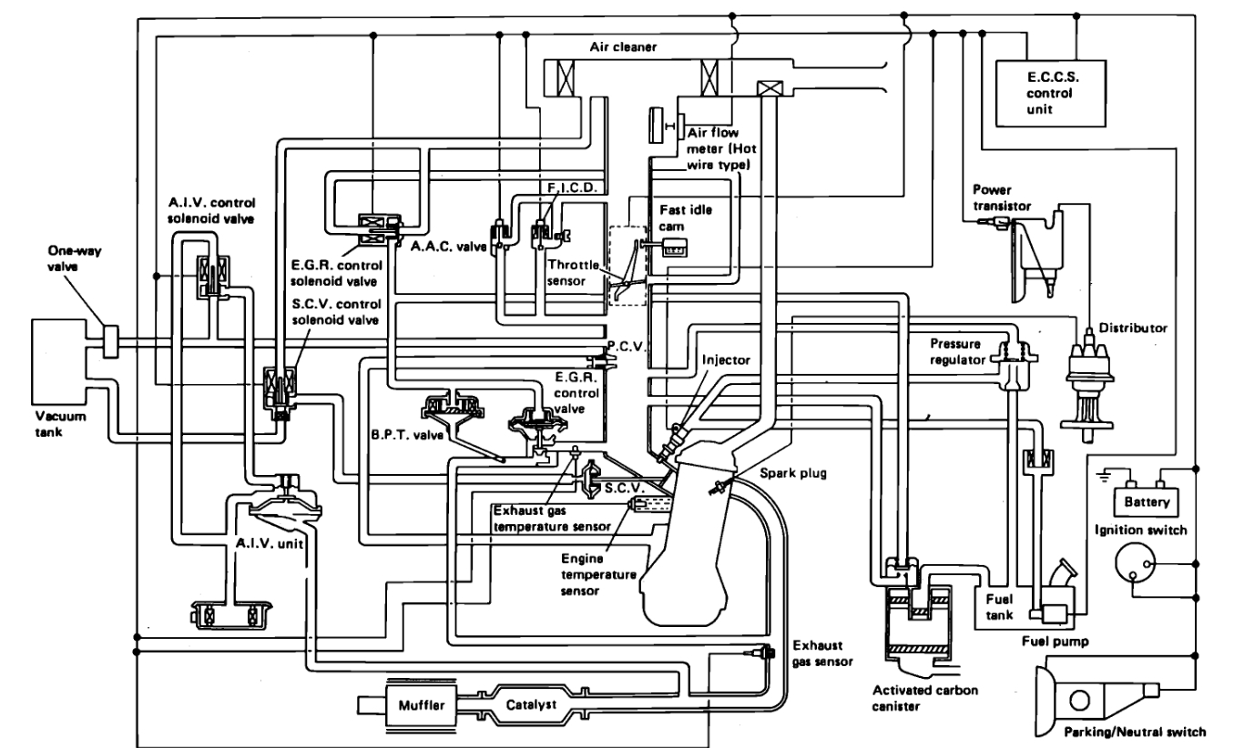

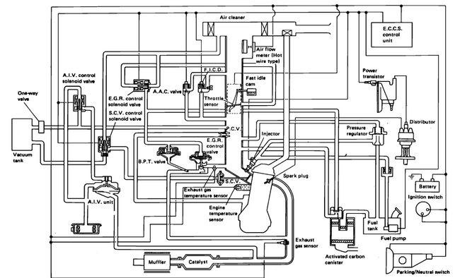

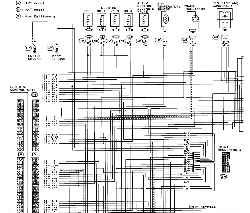

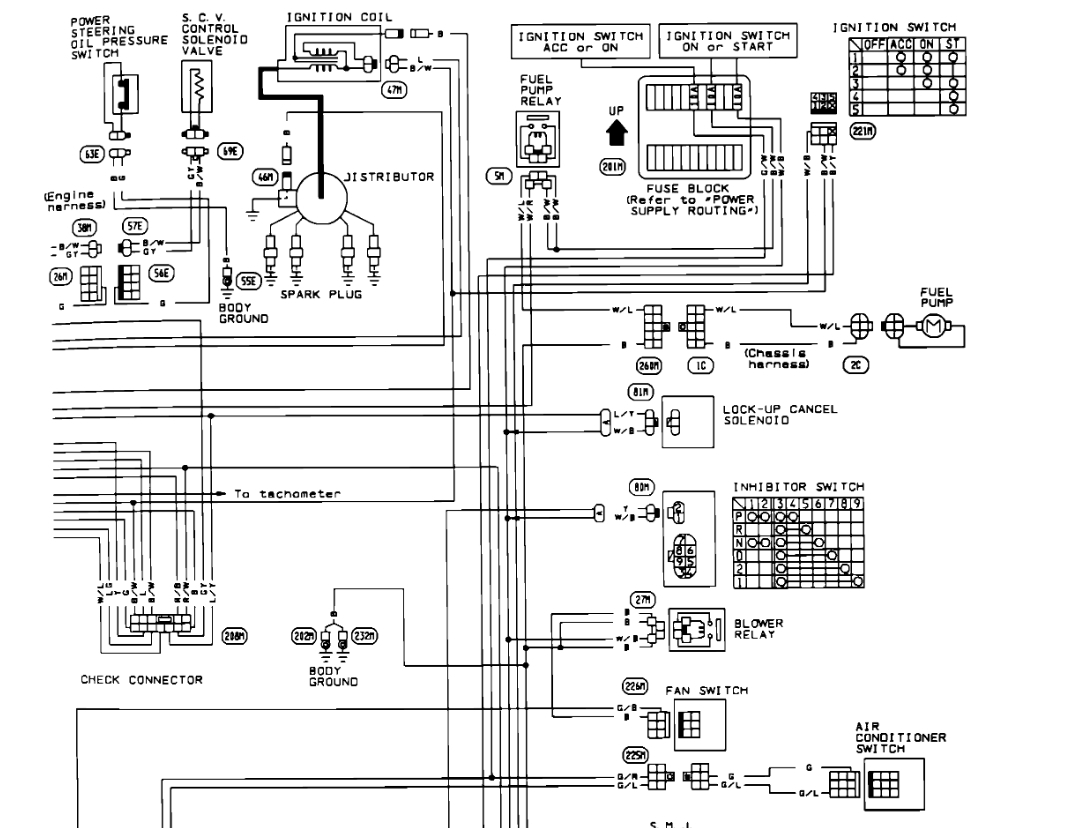

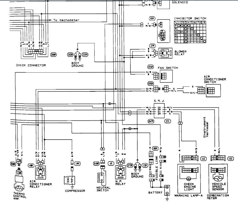

Sorry to hear about the engine fire. Here are the engine wiring diagrams as requested and I have included a guide to help you test the connections.
Check out the images (below). Please let us know if you need anything else to get the problem fixed.
