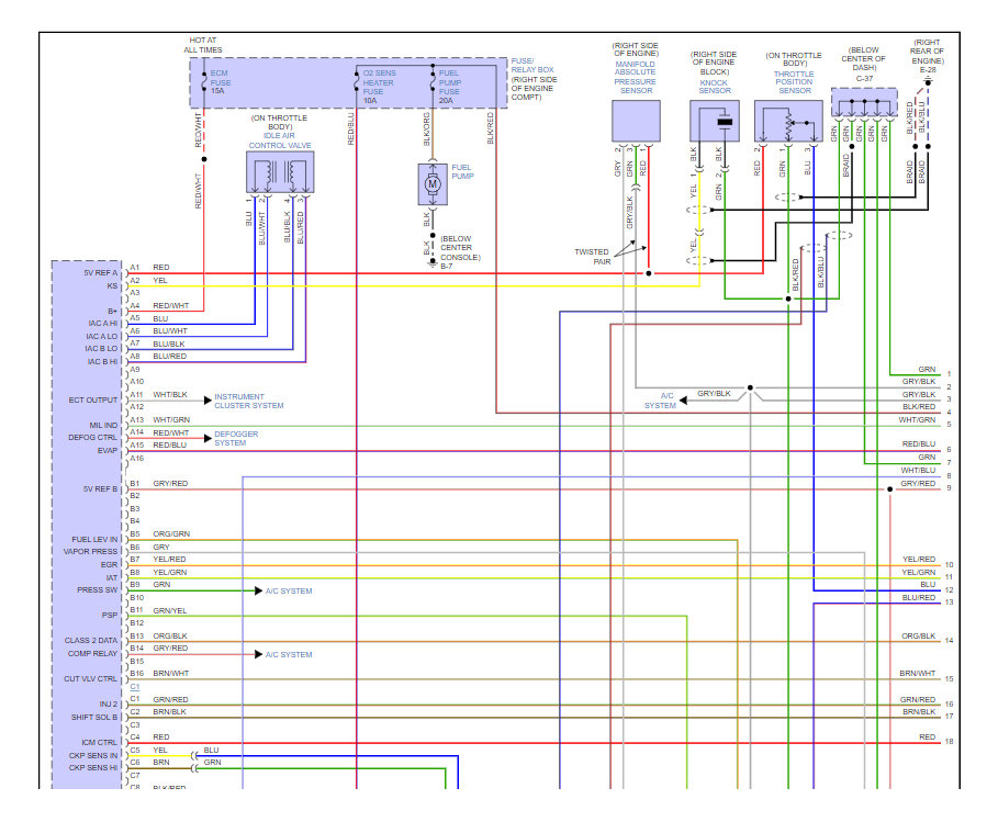

Can I get an engine wiring diagram for a C24SE, KB240 2005 petrol engine?
152,342 MILES • 2.7L • 4 CYL • 2WD • MANUAL
EMMANUELNGANDU
  • 30 POSTS

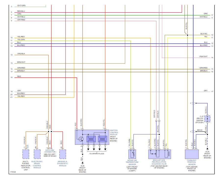

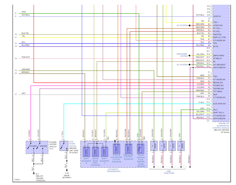

Anyone with a wiring diagram for Isuzu, engine C24SE, KB240 2005 petrol engine?
Aug 17, 2022 at 8:36 PM
  • 55,732 POSTS

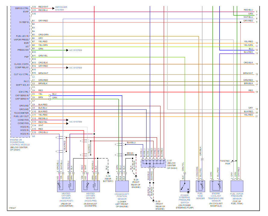

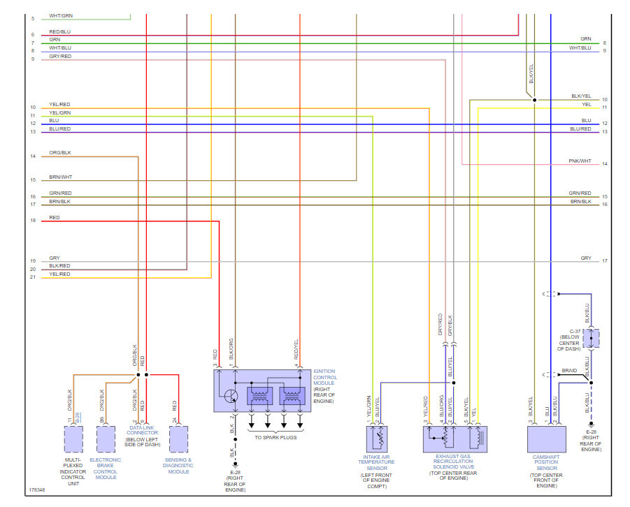

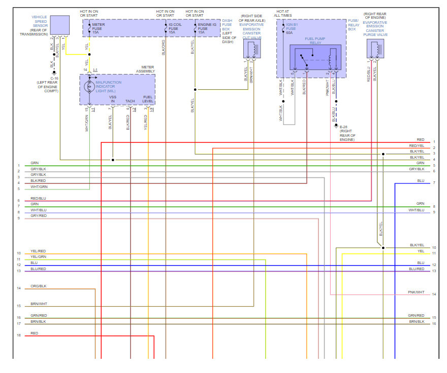

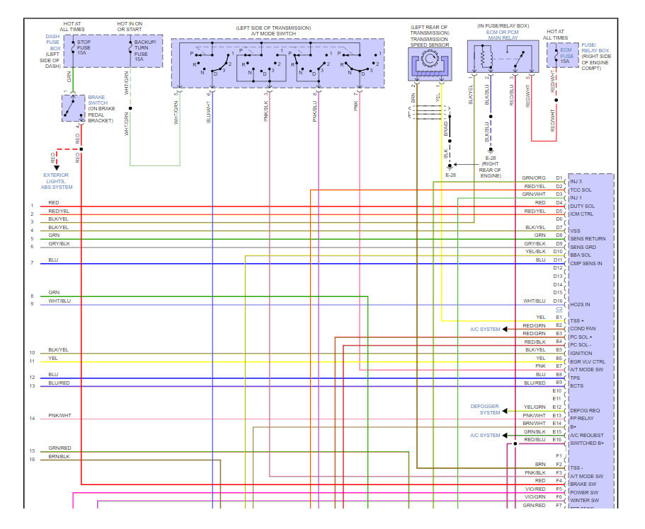

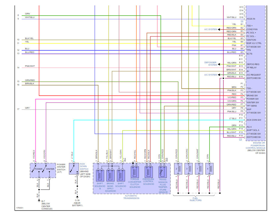

Here are the wiring diagrams they list for a 4 cylinder engine and a guide to help you test the connections:
Check out the diagrams (below). Please let us know what you find.
