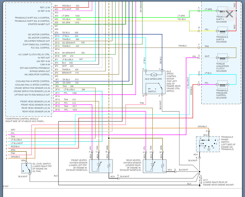

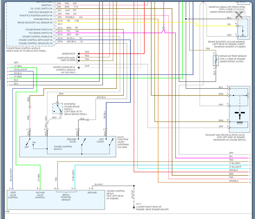

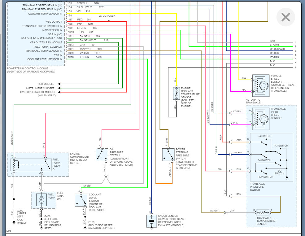

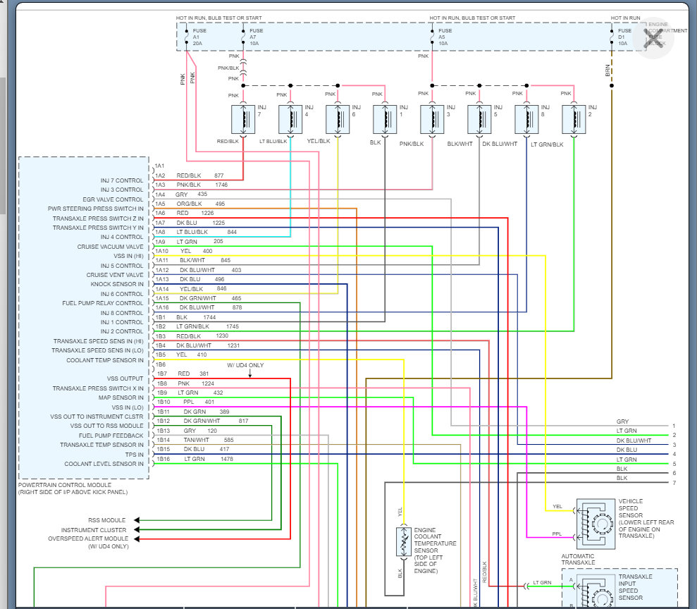

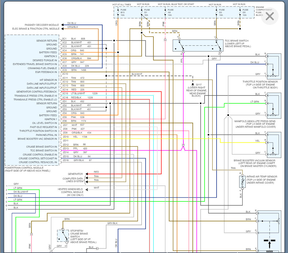

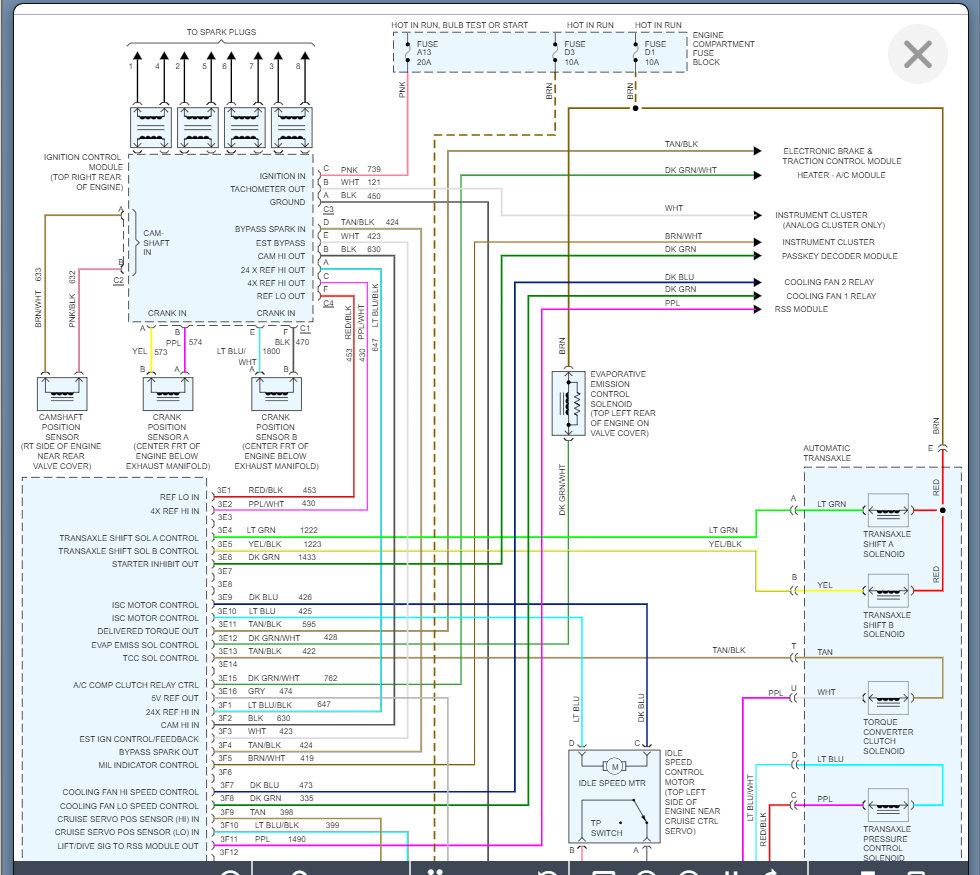

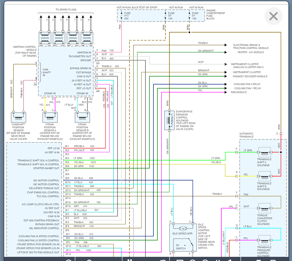

Installing engine want to disconnect wire harness from firewall, so i can connect wires to new engine prior to dropping engine in.
May 19, 2022 at 8:36 AM
No problem. We don't have a layout of the harness showing where they go but we do have a complete system diagram which will show the details that I am thinking you are looking for.
Here is a guide that will help with any testing that you need:
I am attaching the diagrams below which will help so let me know what other info you need.
