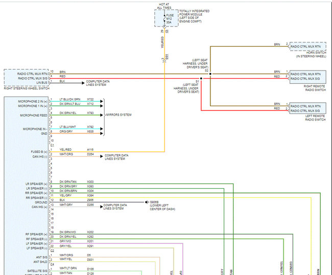

wiring colors diagram for front door/rear speakers needed
2016 DODGE CARAVAN
96,000 MILES • 3.6L • AUTOMATIC
CHRIS MIZSERO
  • 12 POSTS
installing some after market speakers, rather than spending on adapters, i am just going to splice into the factory wiring. but the wire colors differ from the stereo side.
any chance to get the correct wire colors for positive and negative? thank you.

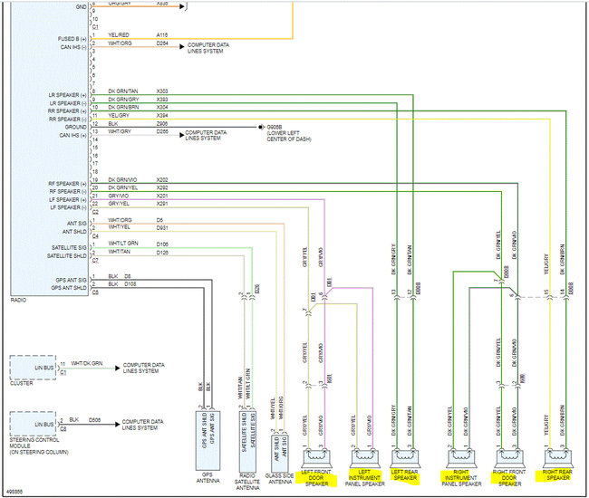

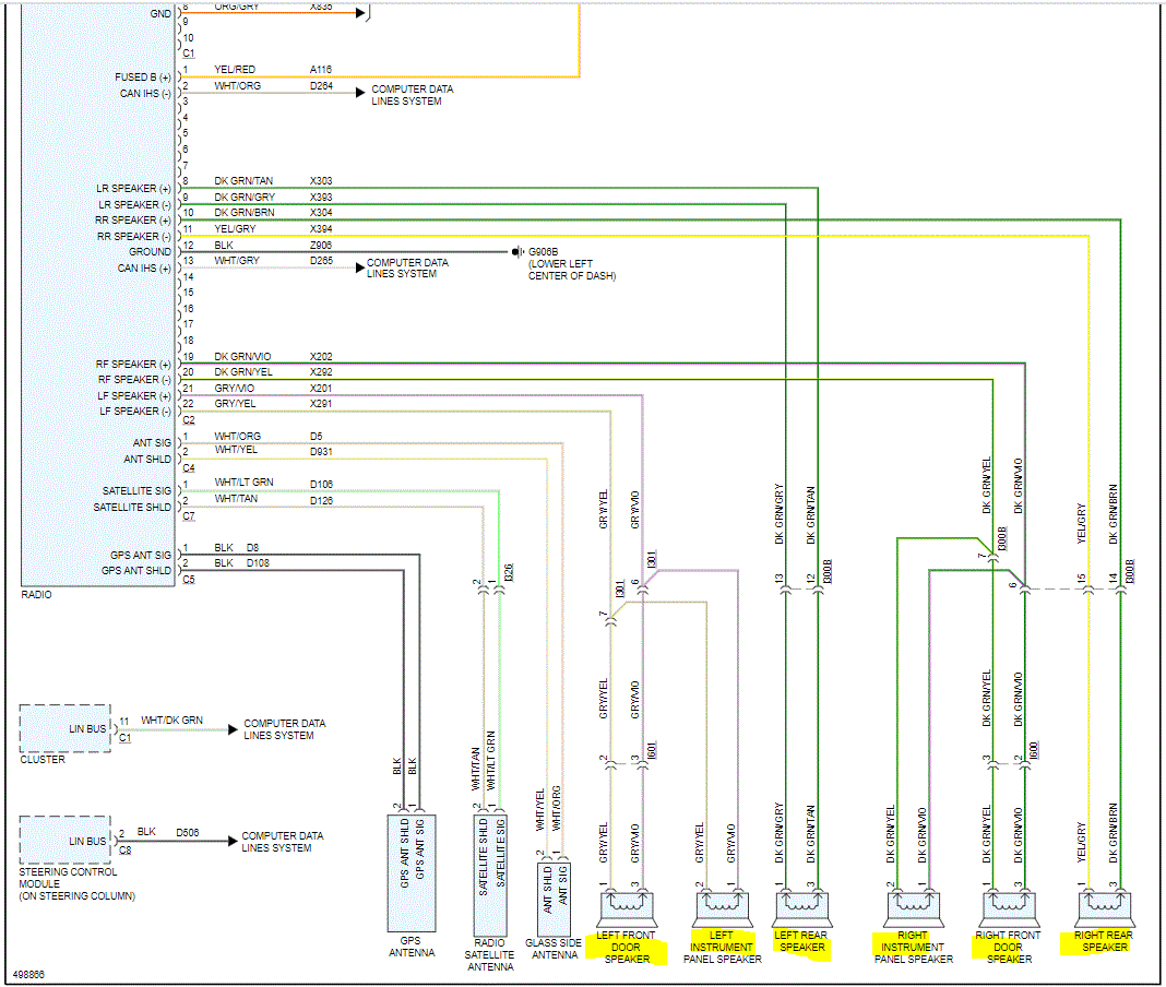

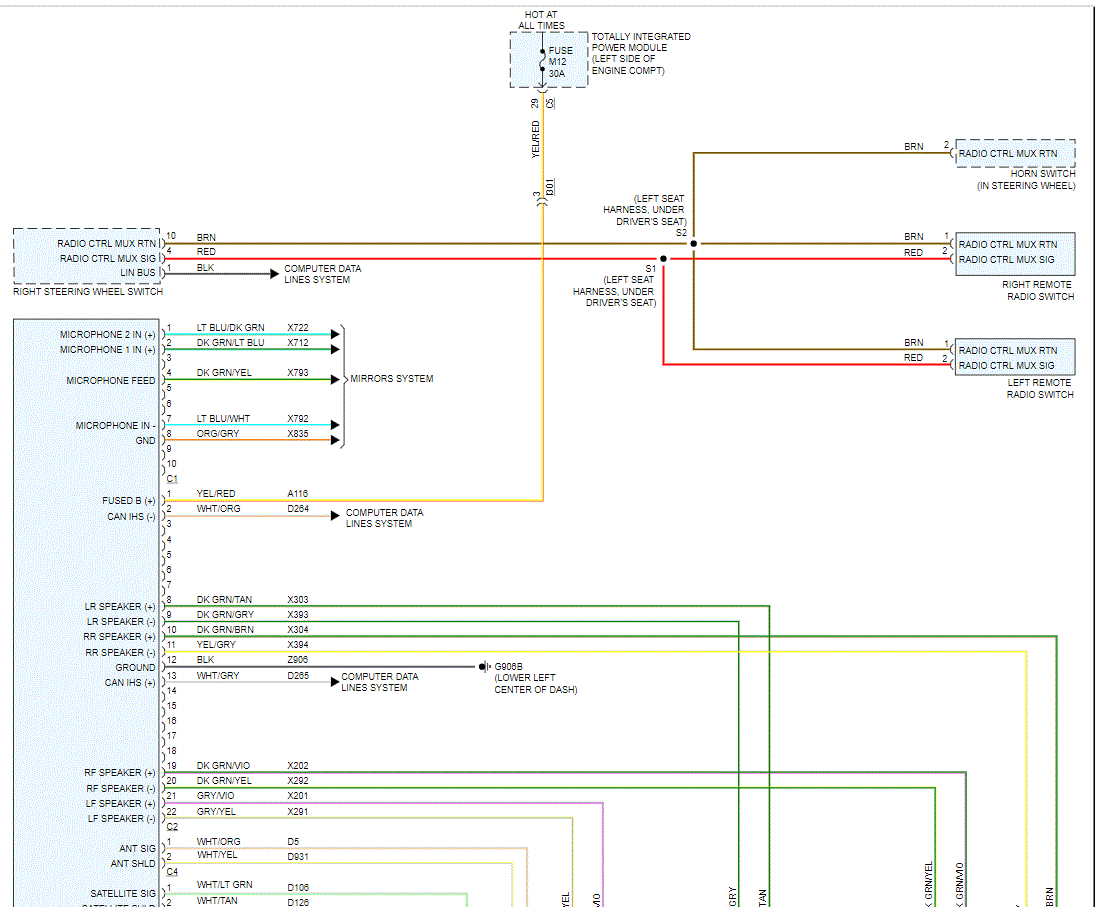

I'm not sure which factory radio was in the vehicle. However, I attached the entire wiring schematic for the standard radio that came in it.
I had to break the pic in two so it was readable, but I did overlap them so you can follow them.
In the second pic, I highlighted all the speakers. The wire color is present in each. if you follow the wire back to the radio, it indicates positive or negative.
I hope this helps.
See pics below
