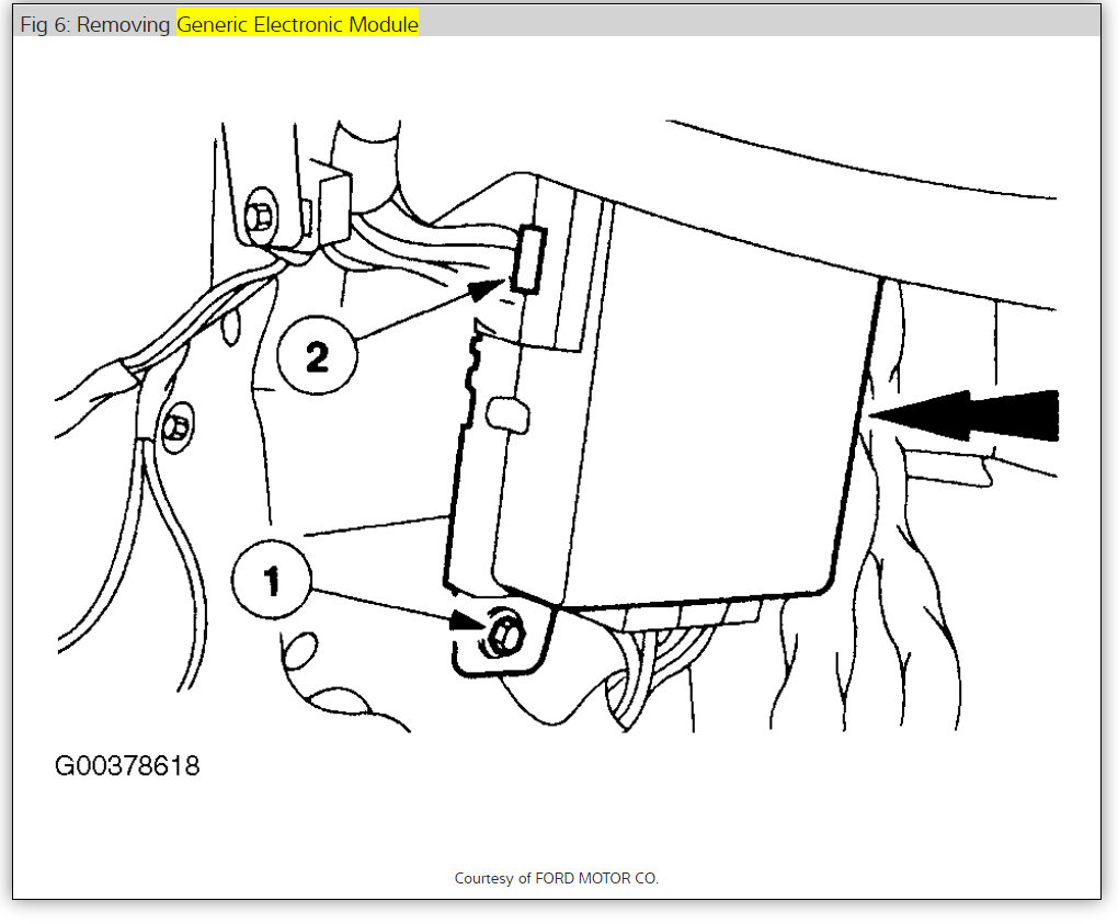

I bought the GEM off the internet for $18.00. Could it be bad and can you test them?

If I buy a new gem module will I have to have it programmed to my vehicles identification number for it to work?
Sunday, December 16th, 2018 AT 12:16 PM
KEN L
  • MASTER CERTIFIED MECHANIC
  • 48,289 POSTS
I believe the GEM self initializes. Check out the diagrams (below). Please let us know what happens.

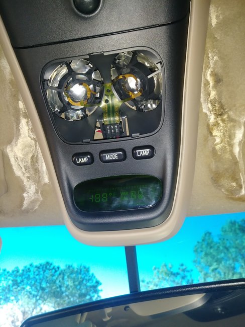

I pulled the sun visor down and found this.
Tuesday, December 18th, 2018 AT 12:29 PM
KEN L
  • 48,289 POSTS
Good find, the car looks like it has severe water damage from a leaking windshield. You better have that fixed first before trying to fix the electrical. Can you remove the cluster and take a picture of the electrical connector? We need to look for corrosion.

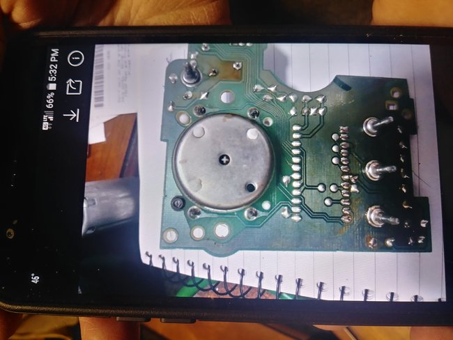

This is off my old cluster the one that gray smoke came from and it smells like burnt wire's. Does it look burnt to you?
Thursday, December 20th, 2018 AT 2:44 PM
KEN L
  • 48,289 POSTS
Hard to tell picture in picture but I think I see burnt solder joints in the circuit board.

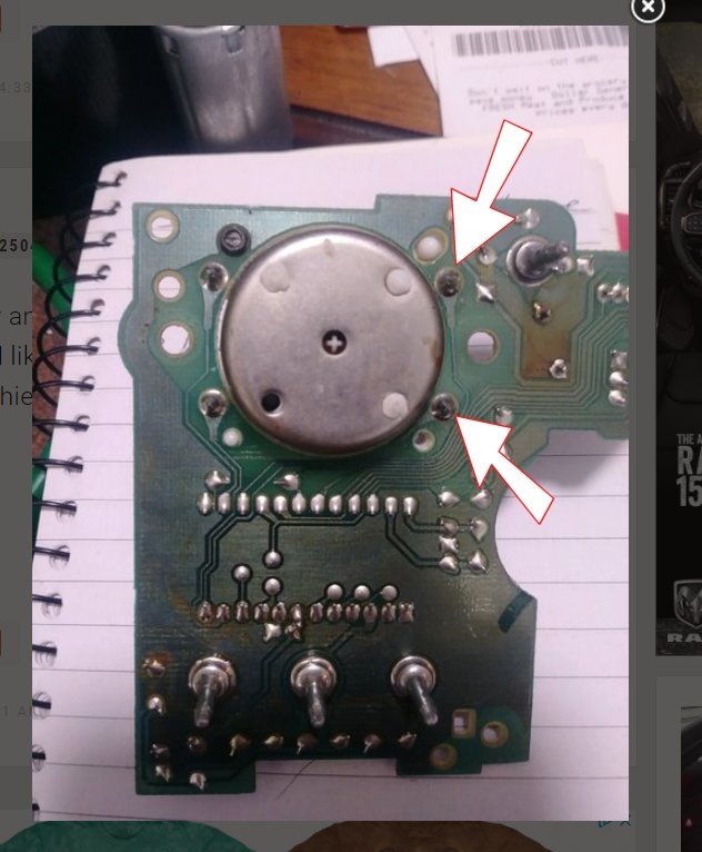

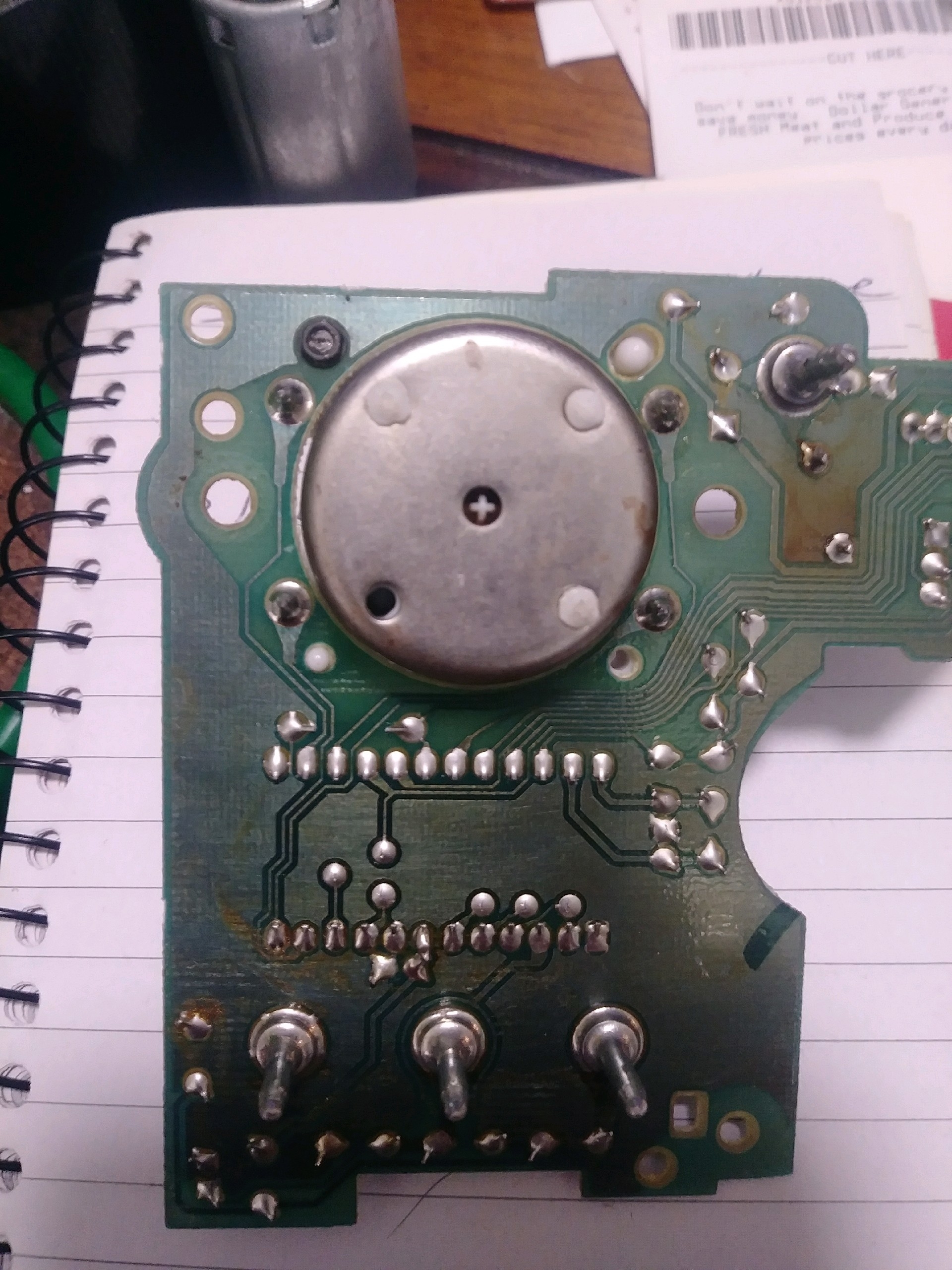

Can you see this one better and tell from it? When this shored out smoke came from it and it smelled like burnt wires and my power windows, radio, dome lights, sunroof windshield wipers stopped working at the same time.
Friday, December 21st, 2018 AT 11:21 AM
KEN L
  • 48,289 POSTS
I have marked the problem areas in the diagrams below you must be able to clean I up and solder the joints. If not I would try a new or used one.
