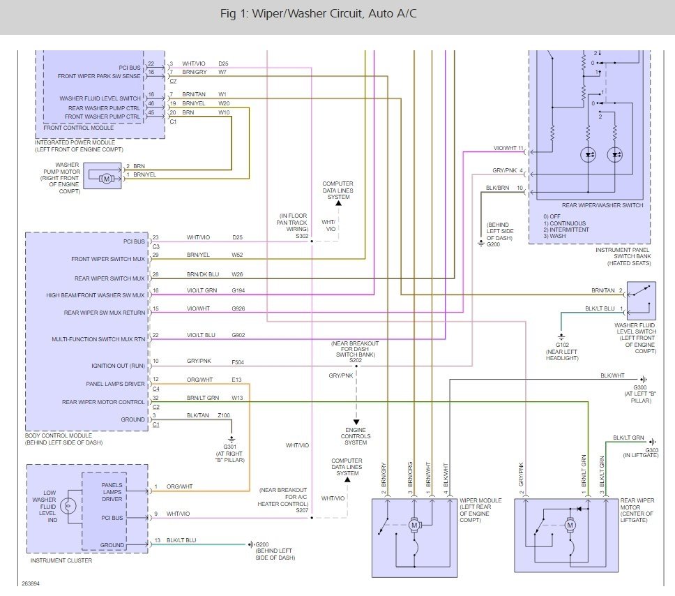

Car running and driving. Turn on wipers and all gauges go crazy. Speedometer goes to 120, temperature gauge goes to hot, gas gauge goes to full. After a minute everything goes to normal for a few seconds and then the problem resumes. After turning off wipers the problem seems to stop. Please help.
Jun 27, 2017 at 4:18 AM
  • 55,249 POSTS

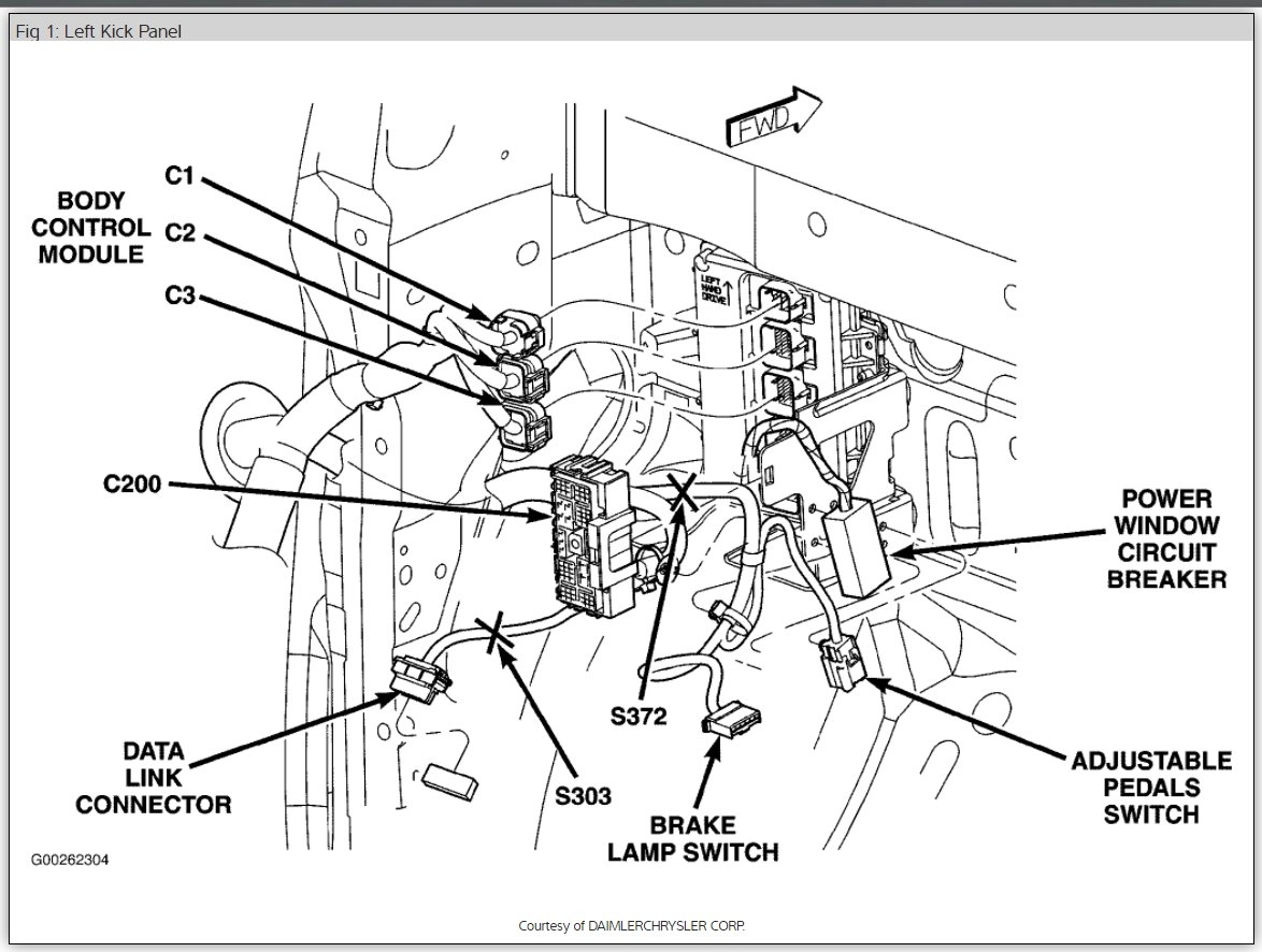

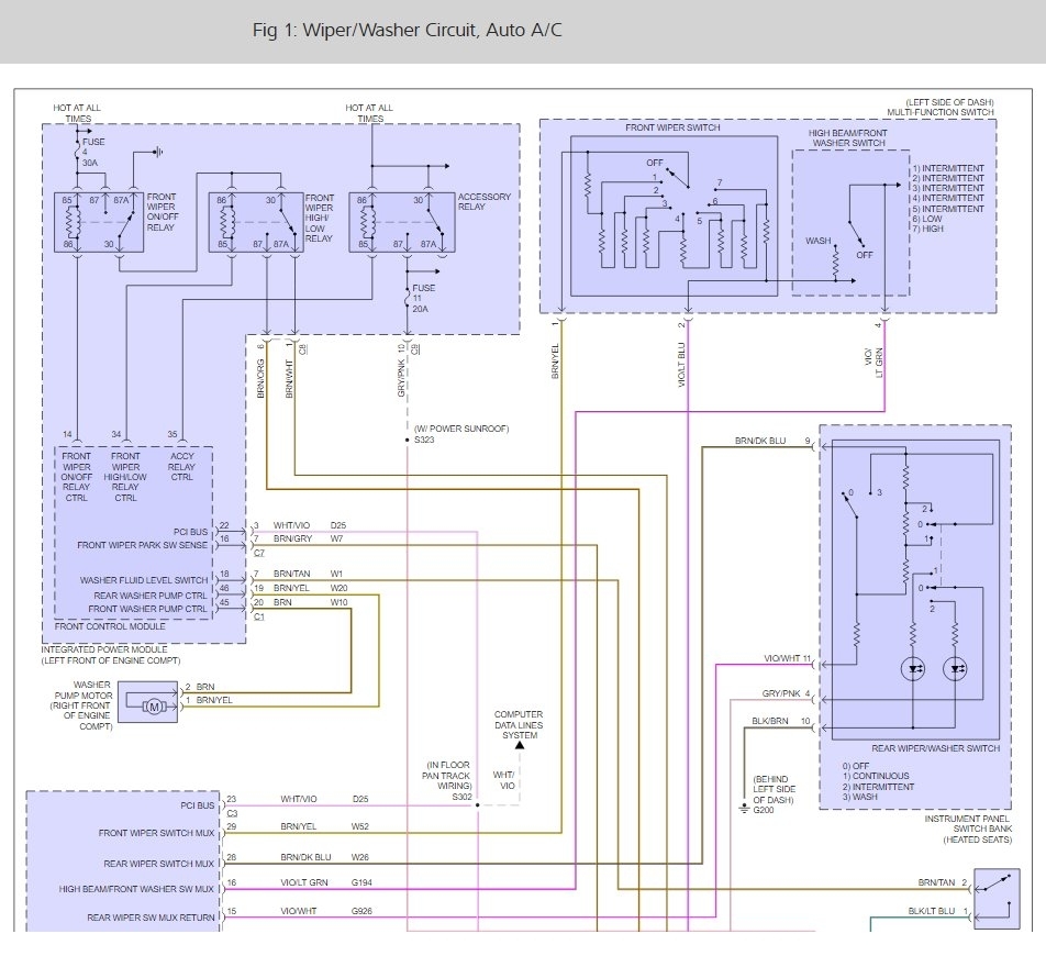

Two things come to mind for this problem, first would be a bad ground at one of the circuits, next would be a bad BCM. Here are some wiring diagrams and BCM location (below) along with a guide to help you do some testing.
Check the ground for power that's how you know the ground is not working.
Please run some tests and get back to us we are interested to see what it is.
