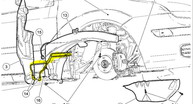

I have the car listed above M/T and I’m unsure about why my windshield wiper fluid just trickles out, if at all, of the nozzles. The wiper fluid reservoir is completely full and I can hear the wiper motor when pushing the button. Please help.
Aug 3, 2021 at 11:16 AM
  • 110,248 POSTS
Either the pump is weak, there is a leak, or something is plugged. If you open the hood, locate the washer nozzles. There will be a rubber tube that supplies solvent to them. One at a time, disconnect the nozzles and try the washer. See if the pressure is higher. If it is, replace the nozzles. If it isn't, have a helper actuate the washers while you watch for leaks under the hood and near the right fender. (passenger side)
If you look at the pic below, I highlighted the washer tubes which come from the pump. They are in a crazy location. The pump is even worse.
Let me know what you find.
