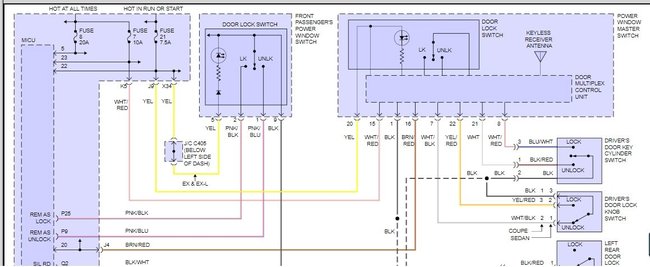

My keys got locked in my car, a friend forced his arm through the driver side window that was partially opened, setting the alarm off. We got the alarm to go off but now the window and door lock controls are not working. Why?

Did he reach the door lock switch? Did he use any kind of tools to get the door open?
I do not have much to work with here. Please give me as much detail as possible.
I attached a wiring diagram for the windows and door locks. check the fuses listed for power on both sides for power with the key on.

No, I tried to tell him all he needed was a long stick. Yet he needed to show off. He didn't use the lock on the arm rest. He reached until he got to the knob that you pull up on. Located at the top of the door near the window.
Dec 17, 2018 at 1:35 PM
Okay. Start with checking the fuses.
