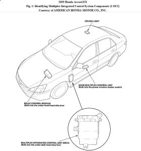

The switch to lock all windows execpt driver window does not word. The window switch is good and the dealer told me he needs to change the Driver Fuse Box part# 38200-SDA-A01. Can I do that and how long should it take?
Dec 19, 2009 at 5:52 AM
KHLOW2008
  • 41,812 POSTS
Hi jfrancke, Thank you for the donation. Replacement of the fusebox is not very difficult and can be accomplished if you are a DIY person. Time should be about an hour. It is the MICU unit as shown in the diagram.
