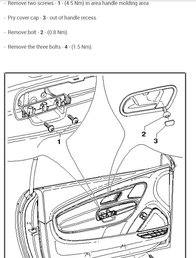

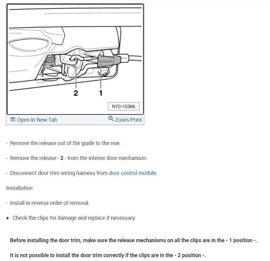

My driver side window doesn’t roll fully up like it use to. When I close the door it’s suppose to automatically fully go up but it doesn’t.
May 3, 2020 at 7:33 AM
  • 55,402 POSTS

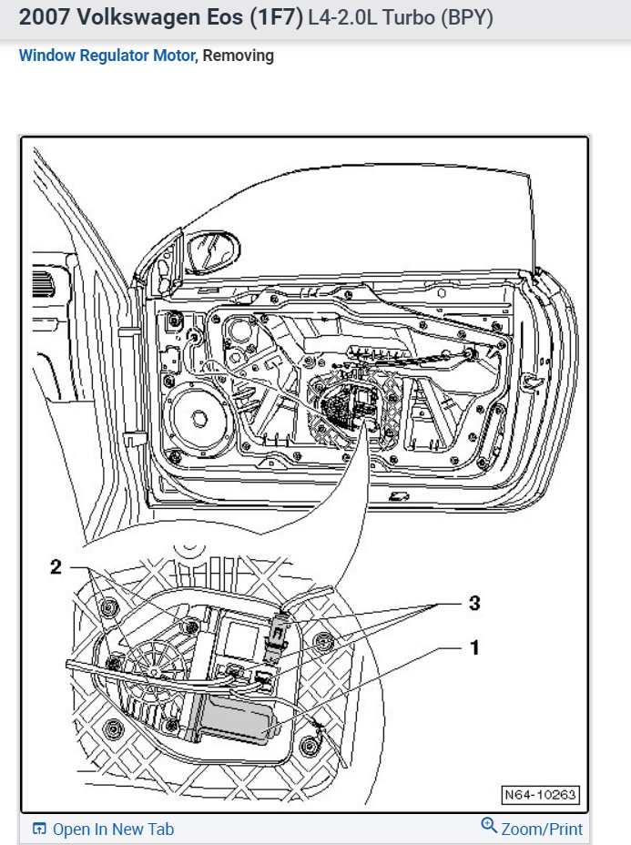

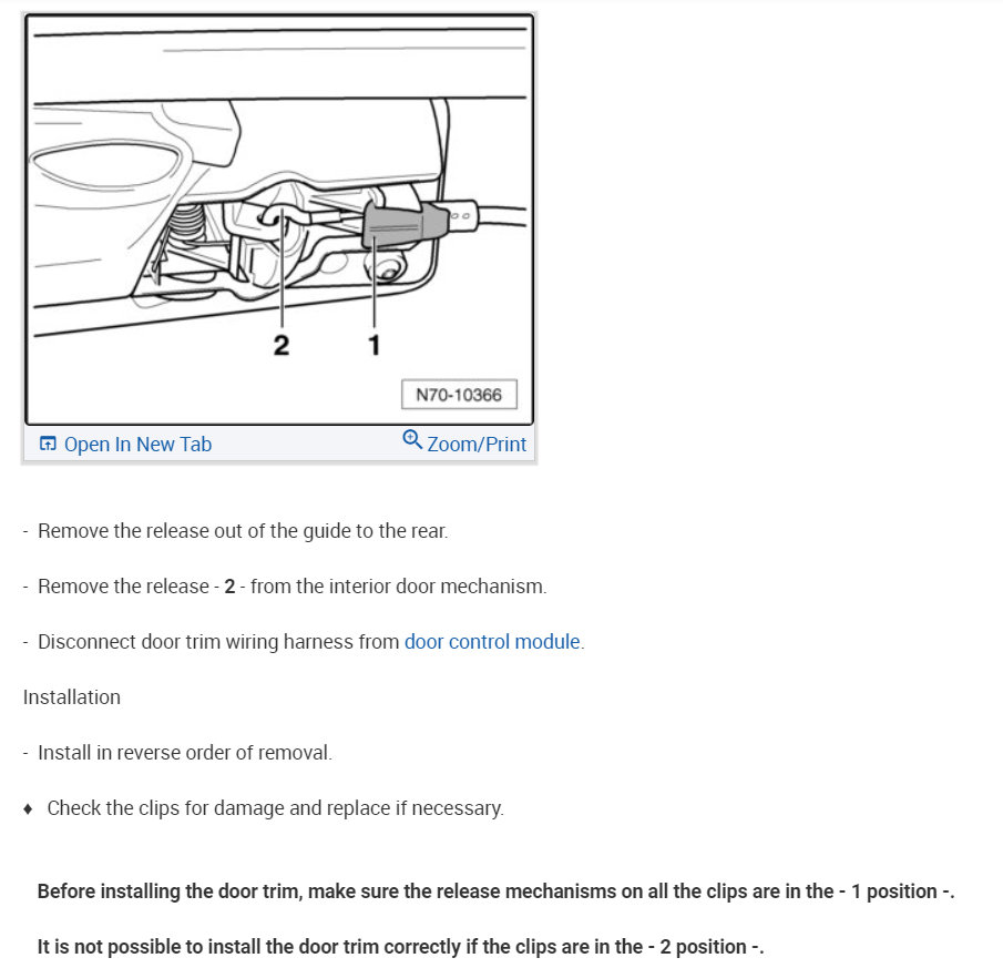

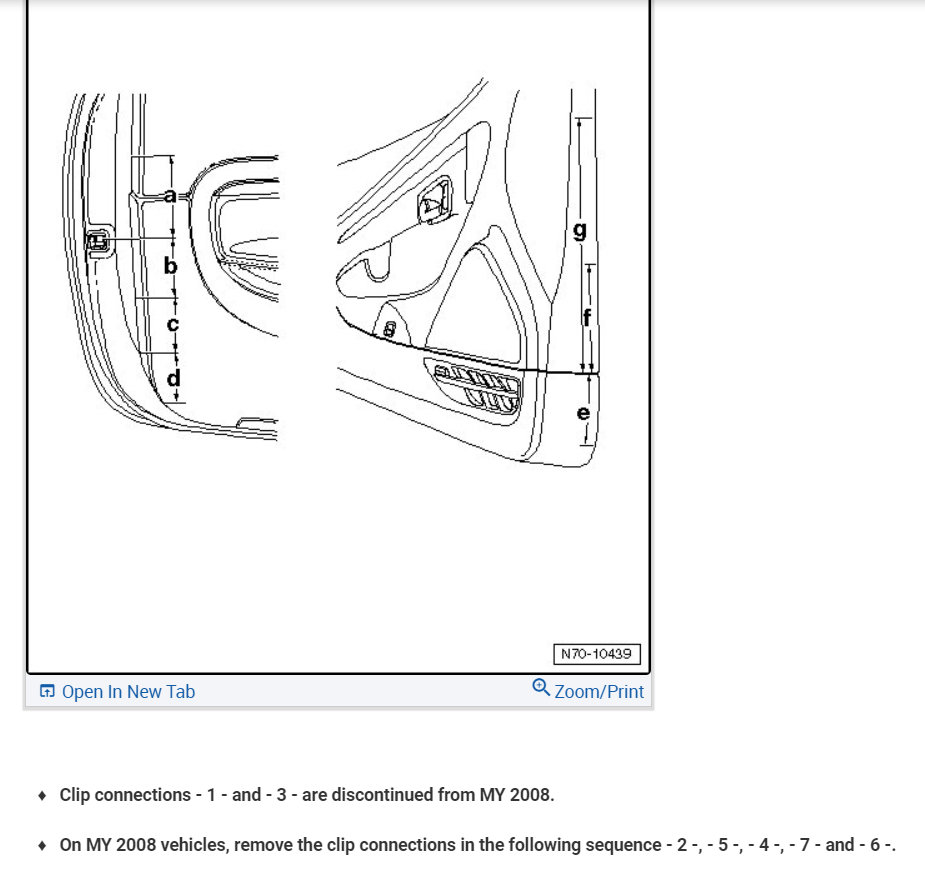

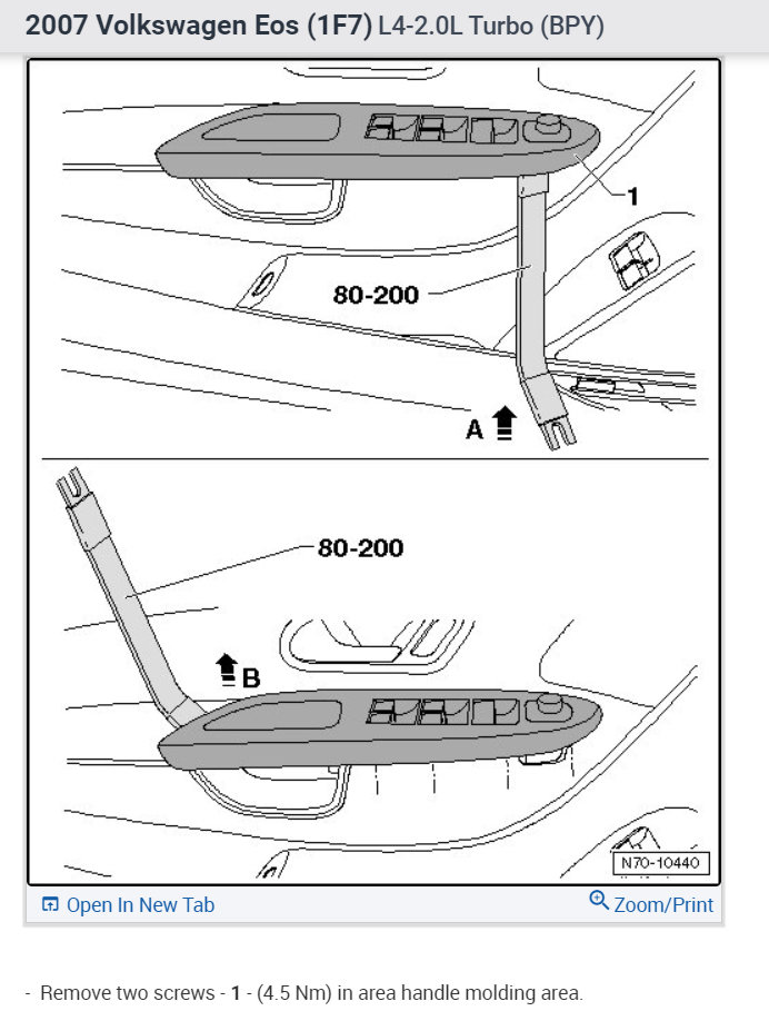

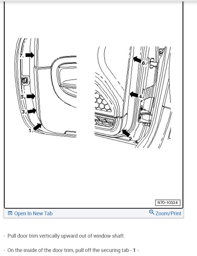

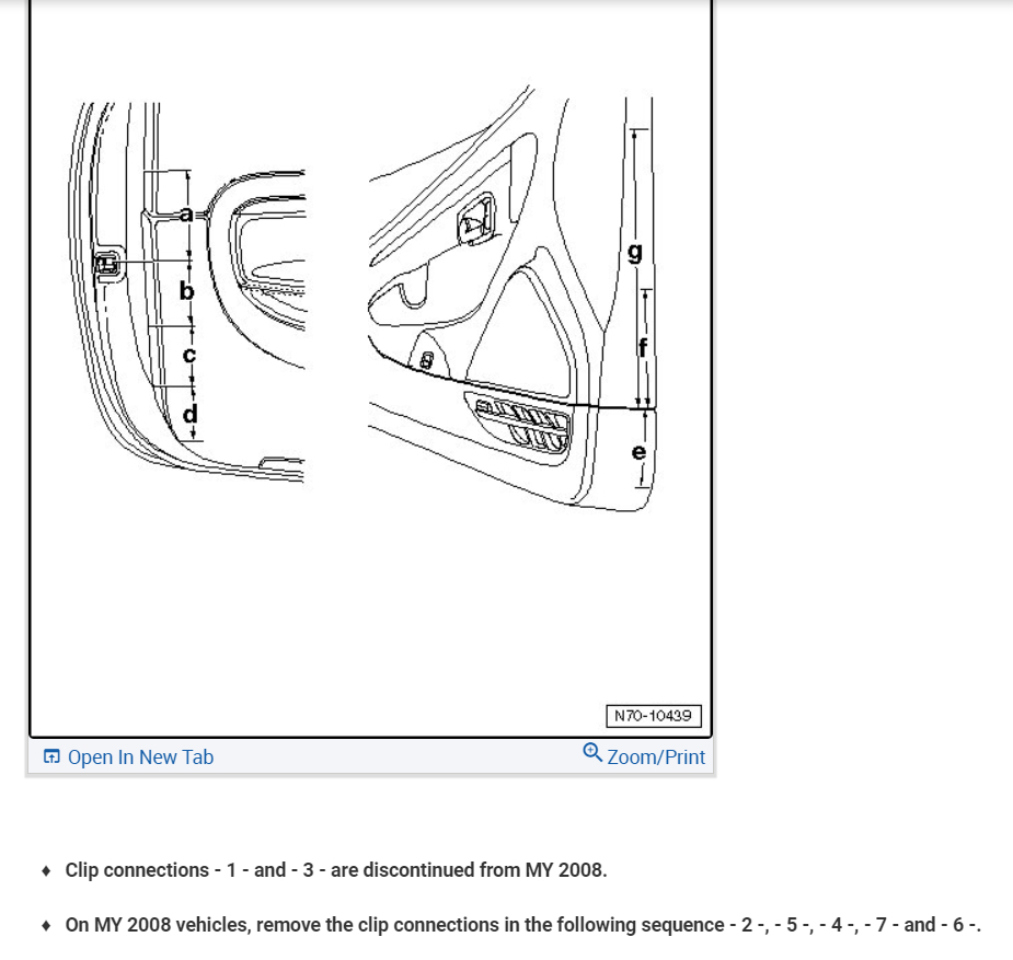

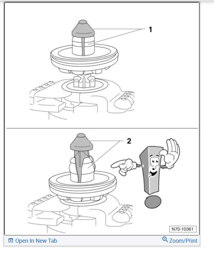

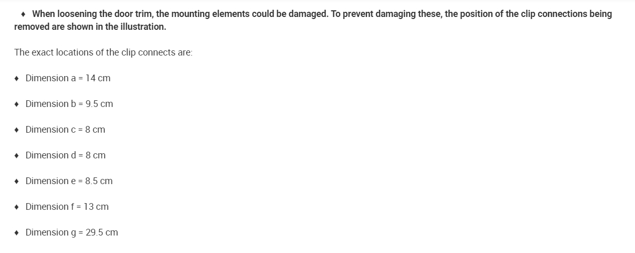

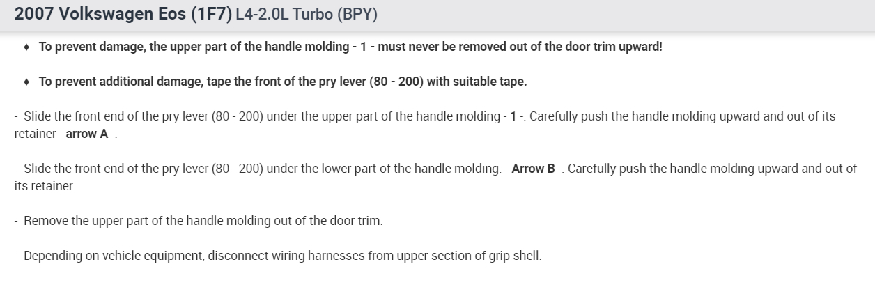

Can I ask if the window rolls up correctly with the switch or just when you shut the door it does roll up? Can you please shoot a quick video with your phone so we can see what's going on? that would be great. You can upload it here with your response. One will be a motor issue the other a switch/command problem. If the motor is getting weak here is how you can replace it. Check out the diagrams (below). Please let us know what happens.
