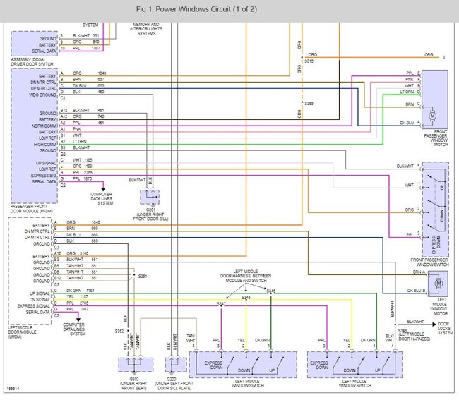

I had my alternator replaced and now the passenger side windows and mirrors only work when I use the buttons meant for the drivers side. Both sides function at the same time. The car battery did run down to an almost zero charge before new install. I asked the shop about it and they insist that it has nothing to do with installing the new alternator although I do know that they were accessing the battery and fuse panel under the rear seat as they both vaguely mentioned it and left the seat disengaged and the cover to the fuse panel off and near the seat.
Jul 15, 2017 at 10:01 AM
  • 55,412 POSTS

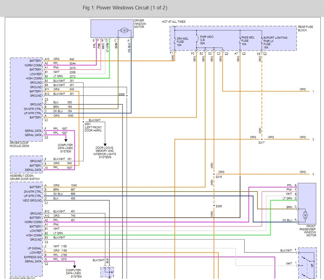

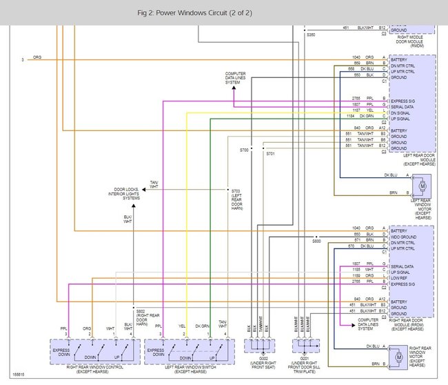

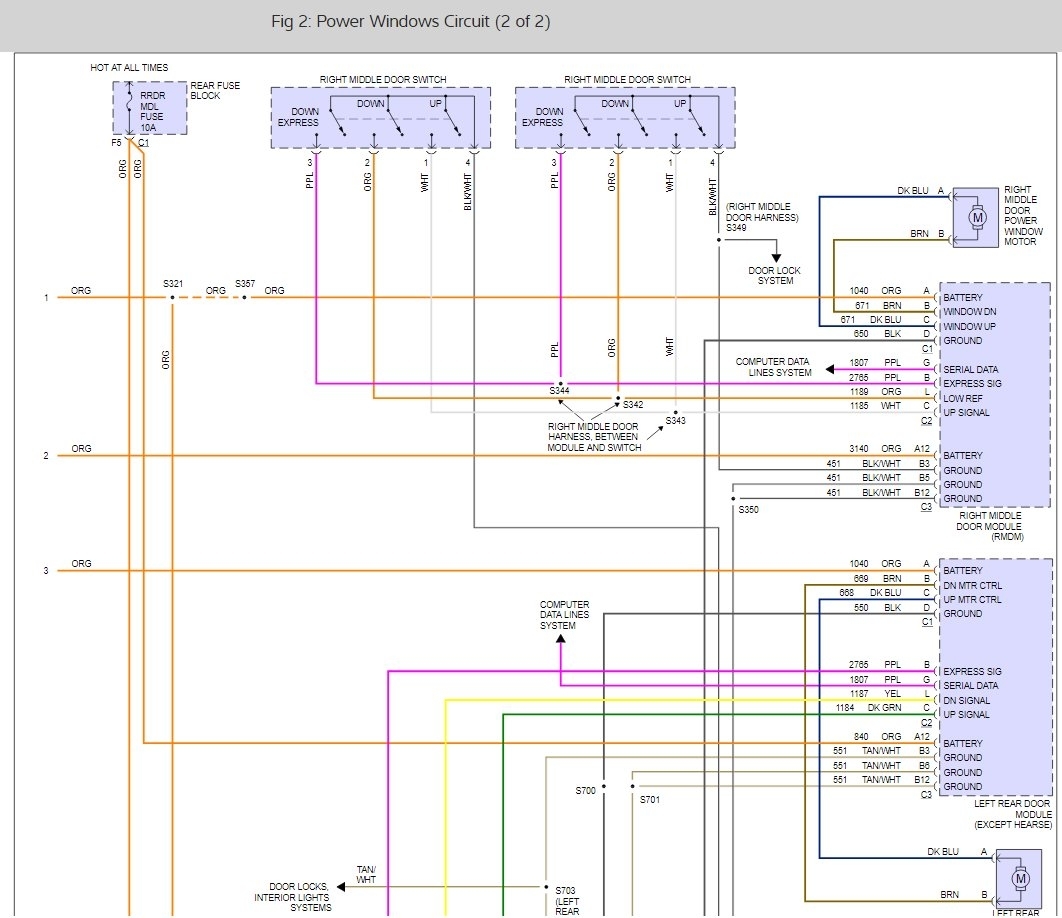

There is a passengers side window module that sounds like it has gone out. But to be sure here are some wiring diagrams (below) and a guide to help you test to confirm the problem.
Jul 17, 2017 at 5:36 AM
JENNIFER MCMICAN
Well, I didn't see your reply until now (but thank you) we tried the suggestion to short the battery cables & reboot the electrical and this seems to have solved the problem.
