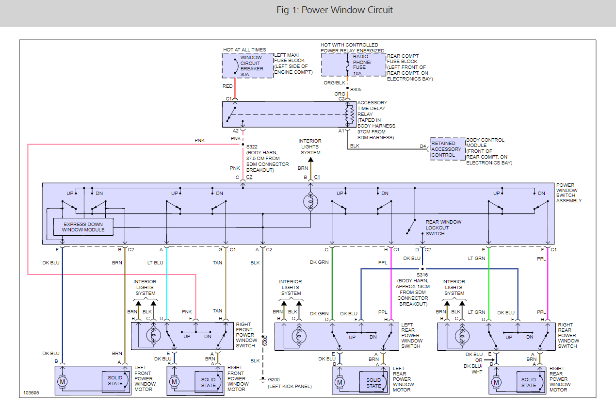

the regulator and the module both work correctly just not on the left side. I tried them both on the right side and they work fine. where is the fuse and relays for the left rear side? I also get the module to click but nothing happens. Any ideas?

It is quite possible with the year and miles, that there may be broken/shorting wires in the pivot area of the door, or in the door itself. First would be to check if power and ground are getting to the window motor. You would remove the panel keeping the connections intact, but disconnect the windo motor. Bridge the window motor connector with a test light and operate the switch in both directions. it should light in both directions. If it does, you have a faulty motor, which I believe is sold as a complete regulator. The click you hear is the module switching (internal relay)

You would either need to check that power and ground is coming out of the switch to the motors, or check it at the motors. Switches were known to fail on these years. Does the left rear work with it's dedicated switch?
You could apply power and ground to the motor, and it should go one way or the other depending on the polarity. The chance that you had two motors fail at the same time would be unlikely, so they would probably work. That would lead you back to having to do electrical checks of the circuits. If you have a test light and can use it, you can check first if power is getting to the motors, and if not trace it back in the circuits. I got you a schematic for reference.
Here are some guides and diagrams to help you start testing
Cheers

Thanks gstacey. I really used that schematic and the window switch was bad nice work 2Carpros you guys are smart. Save me big cash I like that. I will tell me friends.
