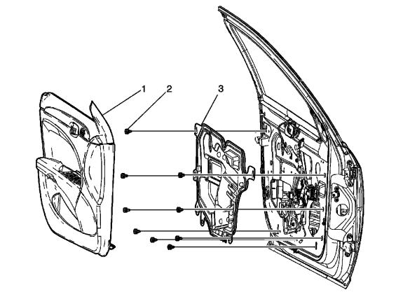

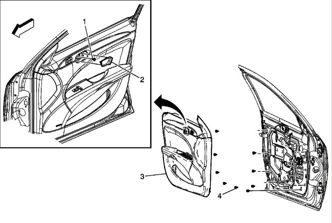

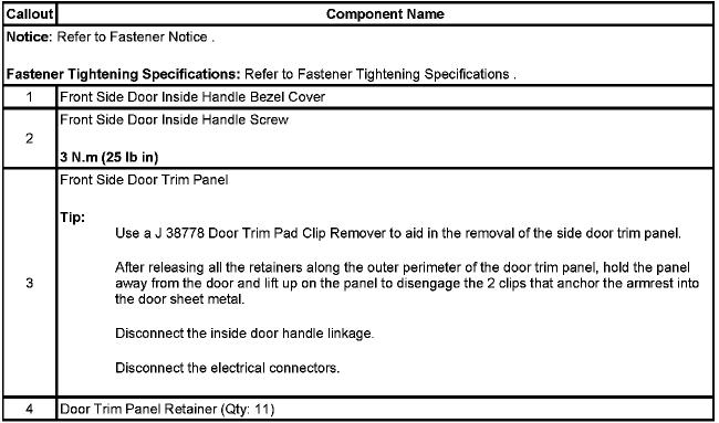

Hi, I need to replace the window regulator on my 2007 Buick Lucerne. I can't find how to take the door panel off. What is holding the door closing handle on on the inside. I only see one screw near the unlatch handle/flipper. Any pictures or help! Driving me nuts!

Hope this helps.
Let me know if you need anything else.

Sean, THANKS!! That helps a lot! Now, what do you call the rubber thing under the bumper? Mine is black in color. The wife tore it half off on one of those cement parking blocks. I need to replace it cause it is hanging half off and I don't want to tear it off if I can fix it some how. Any ideas on a fix?
