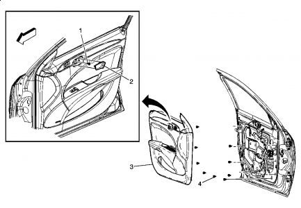

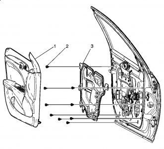

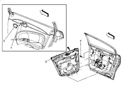

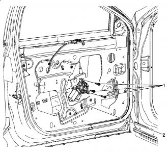

Hello, Not too much directions but I would say your window motor is bad, once you remove the door panel unplug the motor and ground on pin on the motor put twelve volts on the other, then reverse them. if it struggles moving it up with twelve volts right to the motor then the motor is bad. Look at the cable system really good, see if all is in track. It is better to replace the motor and regulator even though sometimes you can get just the motor. The cable is just as worn and will go out too. so replace both as they come already together. The directions are to remove the door panel:
https://images.2carpros.com/forum/automotive_pictures/248015_Door_Trim_1.jpg
https://images.2carpros.com/forum/automotive_pictures/248015_Door_Panel_1.jpg
Water deflector

Motor and regulator bolts.
https://images.2carpros.com/forum/automotive_pictures/248015_Door_motor_1.jpg

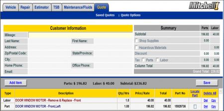

Make sure you brace the window up so it does not free fall down. My estimates are below. you can check with your local parts store like AutoZone etc., and see if they have the part. It may be cheaper to do it yourself.
https://images.2carpros.com/forum/automotive_pictures/248015_Quote_4.jpg
