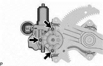

My drivers side window quit working about a week ago. I can still operate all other windows from the drivers switches, just not the drivers side window. When I push the drivers window button I can hear a click noise where I believe the window motor is, but that is all. I’m guessing it’s not the switch since the other windows work from the position. What are the best steps for isolating whether it is a failed actuator or motor? Also, is there a resource showing how to remove/replace one of these? Thanks in advance!

It sounds like the motor if you only hear a click.
Here are the directions for removal of the motor. The attached pictures correlate with the directions.

12. REMOVE POWER WINDOW REGULATOR MOTOR ASSEMBLY
(a)Using a T25 "TORX" socket wrench, remove the 3 screws and power window regulator motor assembly.

Joe, thank you! This is incredibly helpful. You mentioned photos for each step. I'm seeing the one photo showing the motor and actuator assembly. Maybe I'm looking in the wrong area on here? Thanks again for your help.

No, you are correct. The motor and regulator are bolted together. The regulator is what moves the window via power from the motor.

Thanks again Joe. Sorry for the misunderstanding. What i meant was, your initial message said that there were photos corresponding to the directions, but I was only seeing one image attached. Are there more photos? thanks again for all of the help.

No problem at all. Honestly, I was most likely typing fast and added an s. Is there anything other you need pictures for? If so, I can try to find what you need.
