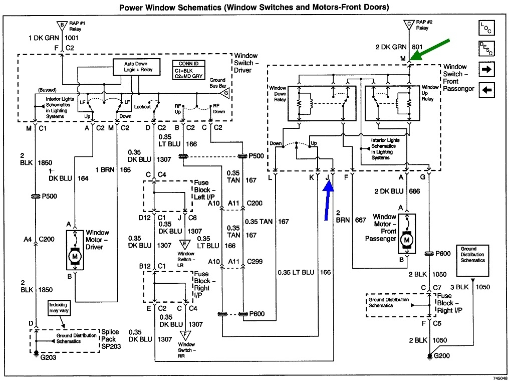

Removed passenger side door panel to replace speaker. now window will not go up or down using the passenger side switch. The driver side switch will operate on the window. Changed passenger side switch and still will not operate. Is there a separate fuse for each window?

One of the confusing things with power windows is either switch, driver's or passenger's, can cause the passenger's window to not work from one of those switches. That's because current flows through parts of both switches when either one is pressed
Given the age of the vehicle, the best suspect would probably be a broken wire between the door hinges. The fastest way to test for that is to pop the passenger's switch assembly out of the door to take some voltage readings on it. The switch must remain plugged in, so you'll have to back-probe alongside the wires in the back of the connector. A test light works best for this type of problem.
For the benefit of others researching this topic:
You can use a digital voltmeter too, but always look at the readings with a little suspicion, especially when you have things disconnected and you find 12 volts.

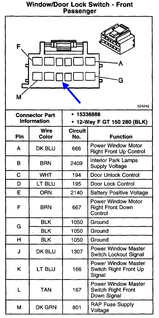

Check for 12 volts on the dark blue wire. You should see 0 volts when you press either the "Up" or "Down" switch on the passenger side. If you find 12 volts, there's a break in that dark blue wire, the driver's switch is switched to "Lock", or the driver's switch is defective. To prove this is the circuit with the problem, leave the test light in place, then use a small jumper wire to connect the probe to ground. As an alternative, you can just use the jumper wire to connect terminal "J" to either "G" or "H", then the window should work when you press a switch.
For the next test, there must be 12 volts on the dark green wire, terminal "M". You can move the test light's probe there or you can just leave it on the dark blue wire, turn the driver's switch to "Lock", then activate either passenger switch. If the proper 12 volts is on the dark green wire, it will go through either relay and show up on the dark blue wire when a switch is pressed.
Let me know what you find up to this point.

Bad wire between door and body. It was an easy fix. Thanks for the info.
