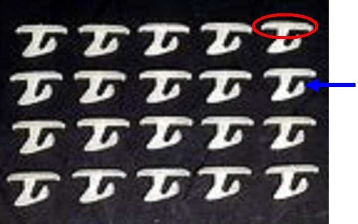

If you need to remove the weatherstrip, the photo below shows the type of clip you're likely to run into. The part circled in red is slid into the hole of the seal. Hold the seal in one hand, then pull the clip sideways with your other hand to pop one end out or to slide it back in. Removing it from the metal hole is easy once you know how. Use the weatherstrip as a handle to pull the clip up and sideways until the tab with the blue arrow peeks out. Use a flat-blade screwdriver or similar tool to squeeze or push that tab in the direction the arrow is pointing, then pull it out. To reinstall them, push on the head through the weatherstrip to poke it back into the hole.
