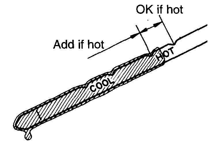

Let me know. If you haven't checked the fluid, here are directions for doing it. Also, the attached picture correlates with the directions.

pic 1
1. CHECK THE FLUID LEVEL
HINT: Drive the vehicle so that the engine and transaxle are at normal operating temperature.
Fluid temperature: 70 - 80°C (158 - 176°F)
a. Park the vehicle on a level surface and set the parking brake.
b. With the engine idling and the brake pedal depressed, shift the shift lever into all positions from P to L position, and return to P position.
c. take out the dipstick and wipe it clean.
d. Put it back fully into the pipe.
e. take it out and check that the fluid level is in the HOT position.
If there are leaks, it is necessary to repair or replace O-rings, FIPGs, oil seals, plugs and/or other parts.
___________________________
Let me know. If it is low on fluid, make sure to use the correct type for this vehicle.

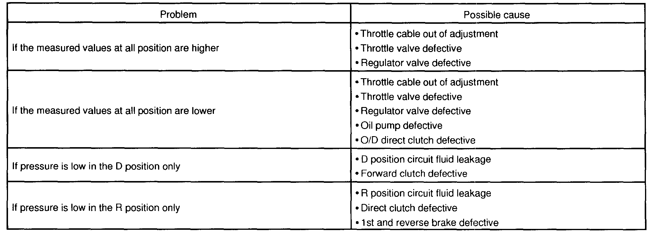

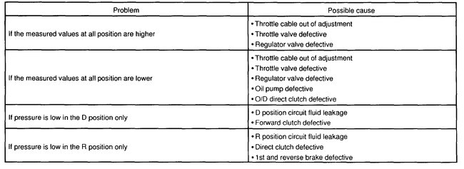

pic 1

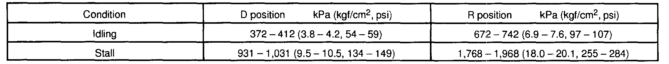

Specified line pressure:
If the measured pressure is not up to specified value, recheck the throttle cable adjustment and retest.
pic 2
Evaluation
_____________________________________
Let me know. Also, if you have never changed the transmission fluid, you may consider removing the pan to confirm the filter isn't plugged.
