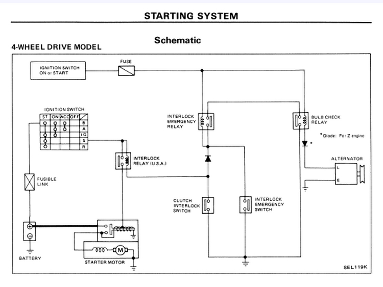

changed valve cover gasket, reassembled, it started, ran erratically, found the vacuum hose not connected to air cleaner housing. attached it and now it will not turn over at all. Have rechecked all the vacuum routing and assembly 3 times. Everything is in order. checked spark with multimeter, all good there and definitely getting gas.

everything is in working order, put a multimeter on battery, alternator, coils, starter, all reading 12+
everything goes it just won't grab and commit.

So the engine is not cranking over? Or is engine cranking but will not fire?
You have 12V at starter solenoid, have you checked if you also get 12V at the starter solenoid exciter wire when cranking the engine?
See diagram below, for an 1989 Nissan Hardbody VG30.
The 12V from ignition switch is routed through the starter interlock rely to the starter solenoid.
The starter solenoid is grounded via the clutch switch.
