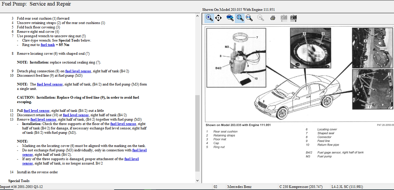

Starts fine when cold. Runs very well but when you stop and turn the engine off it will not start until the engine cools down again usually after 60 minutes. The engine turns over okay but will not fire until it has cooled down.

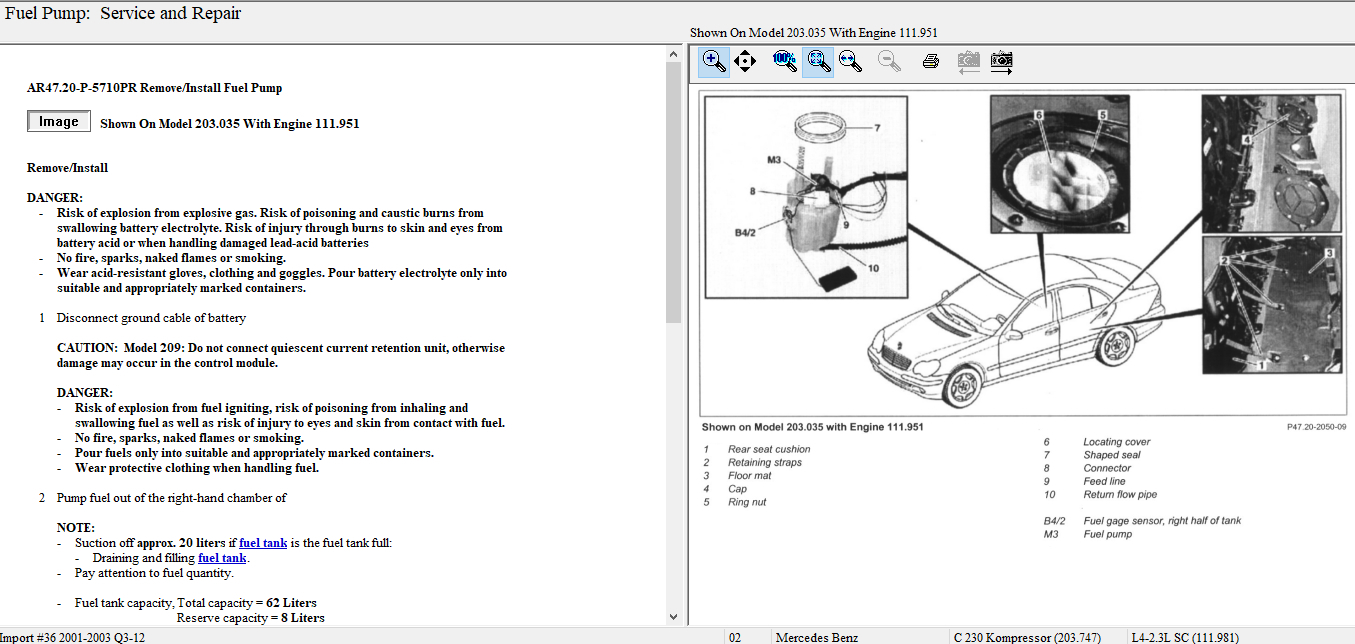

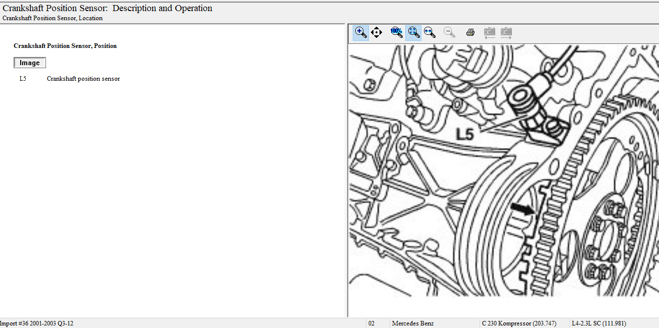

Is it c230?? model year 2002,this sounds like fuel pump defected or crankshaft sensor, for more diagnosis read the fault codes then send to us to help you for proper diagnosis.
check our link below how to read fault codes.

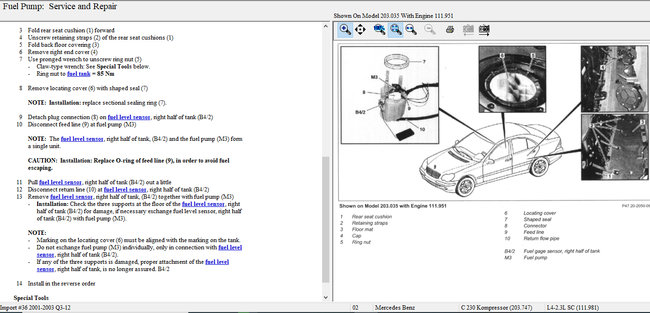

Check our link how to test fuel pump, and the crank sensor.

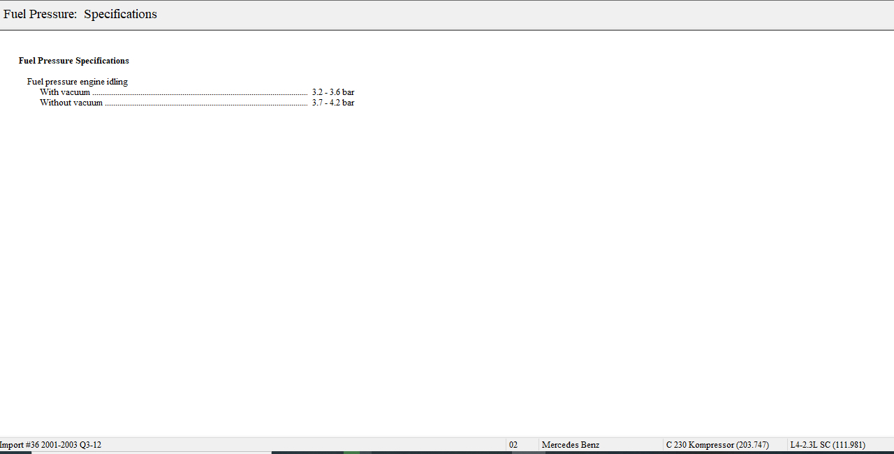

Check the diagrams below specified fuel pressure, fuel pump location, and replacement procedure.
