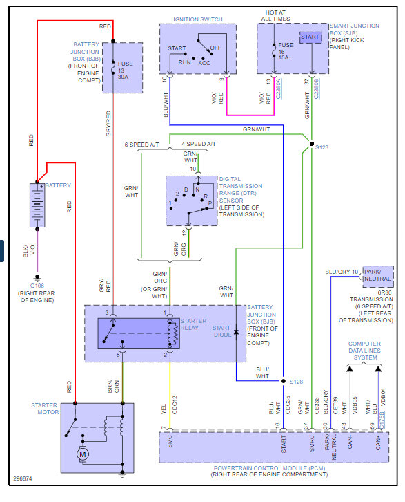

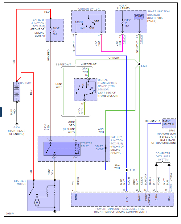

It will not start but starter stays engaged until I turn key off?
Mar 27, 2023 at 3:45 AM
  • 55,721 POSTS
Yep, so when the battery voltage/amperage becomes low and the engine will not start because the electrical system will drop below the minimum to make the ignition and computer system to work, also it does not have enough voltage to break the circuit to the starter. Here is a guide to help load test the battery to confirm the issue:
Please go over this guide and report back.
Mar 27, 2023 at 4:49 AM
SALEEN1986
I have put new battery in truck yesterday and it is still doing the same thing. don't hear fuel pump coming on either.
Mar 27, 2023 at 8:20 PM
  • 55,721 POSTS

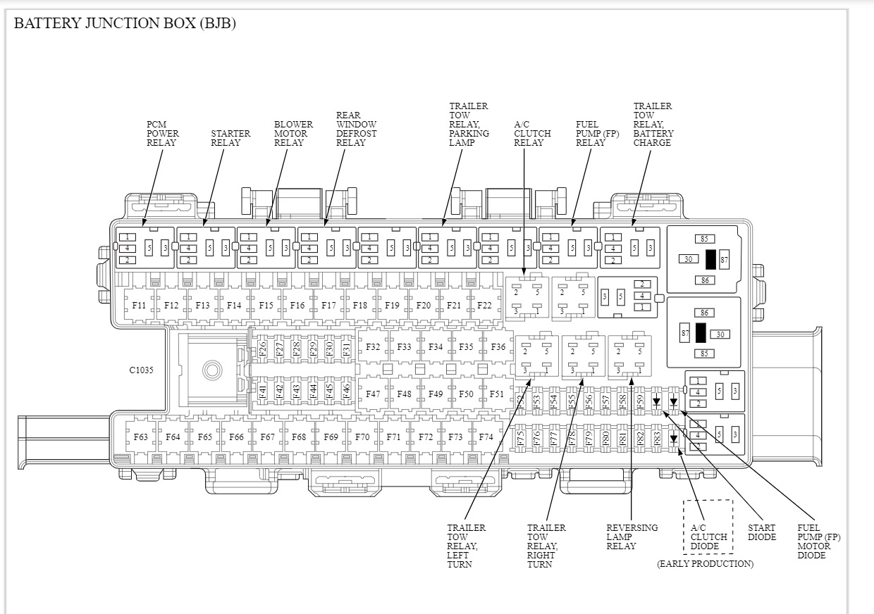

There is a starter relay that might be sticking on which is controlled by the PCM or you may have a bad PCM, would run a scan on the truck to see what comes up. You can get a CAN scanner (Controller Area Network) from Amazon.

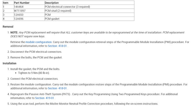

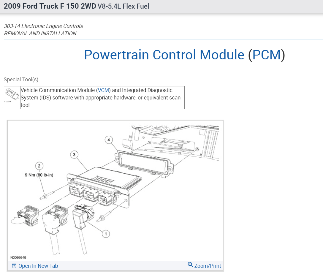

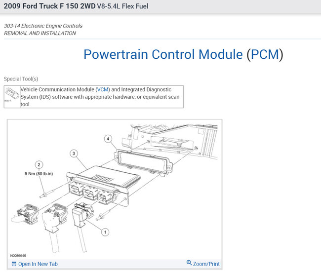

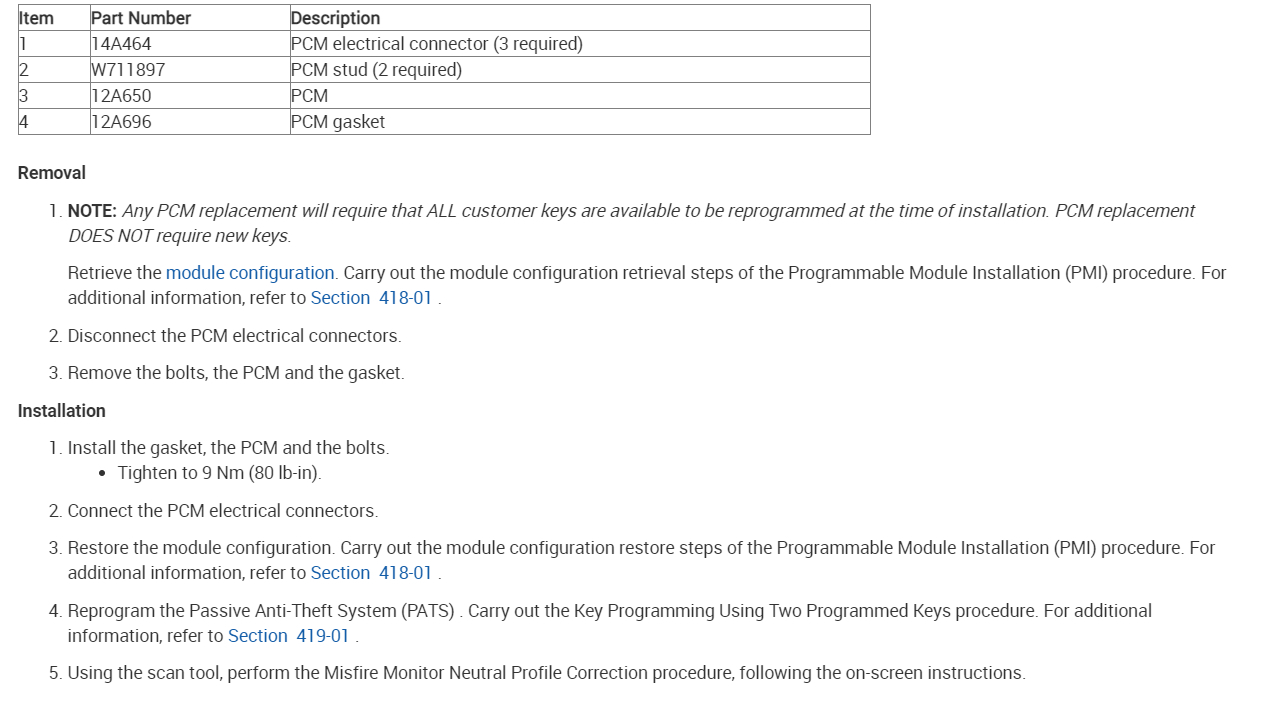

Here is the location of the starter relay so you can swap it out and I have included how to change out the PCM as well in case you need it. You can get a preprogrammed unit by searching Google or Ebay. Check out the images (below). Please let us know what happens.
