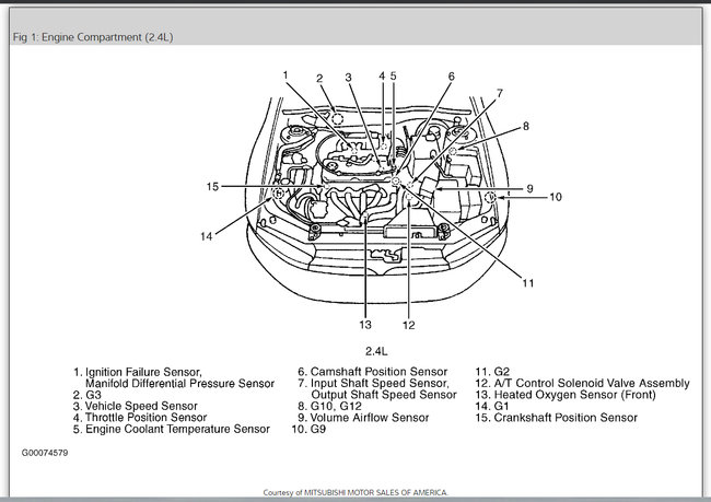

I was driving one day and car shuts off. brake oil and emergency light came. then after had to push car. waited for ten minutes started right back up. made it home then car would not start. balance shaft belt broken. changed injectors, fuel pump, spark plugs, alternator and starter. It has compression on all cylinders . don't know what else?

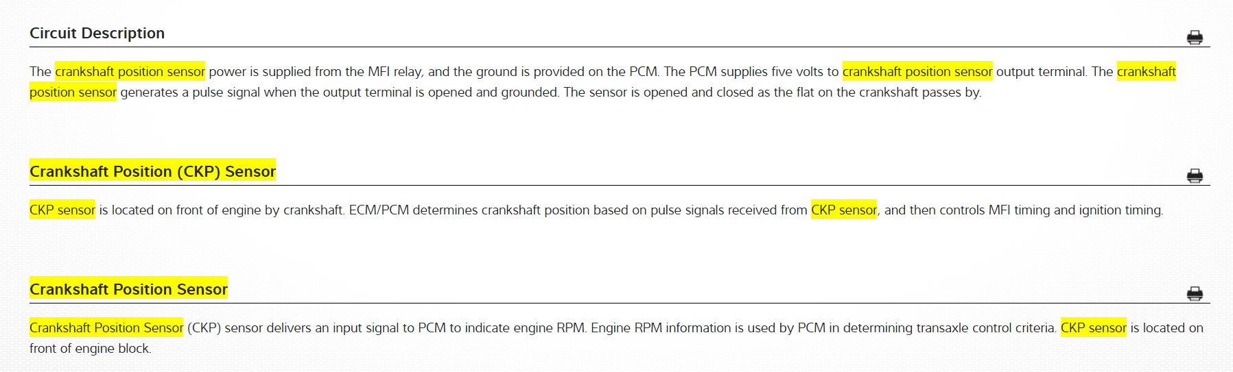

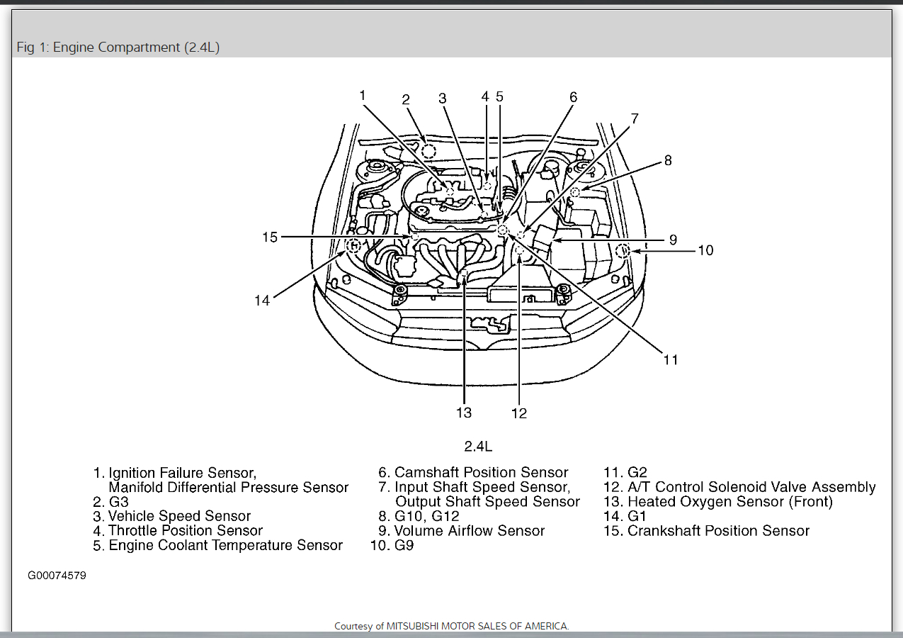

This could be a problem with your Crankshaft Position Sensor (CKP). It sends a voltage signal to your vehicles Power-train Control Module (PCM) letting it know where your engine is in it's cycle. It could be going bad or it's associated wiring. I have included a few links for you down below. Please go to them and go through them.
https://www.2carpros.com/articles/how-a-crank-shaft-angle-sensor-works
I have also included some vehicle specific information for you in the diagrams down below. Please go through them and get back to us with what you find out.
