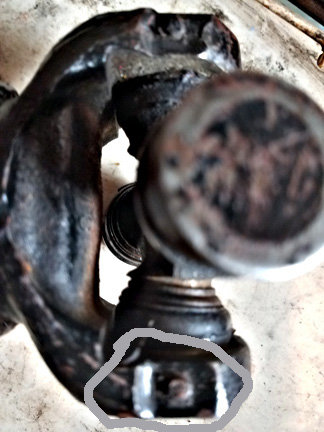

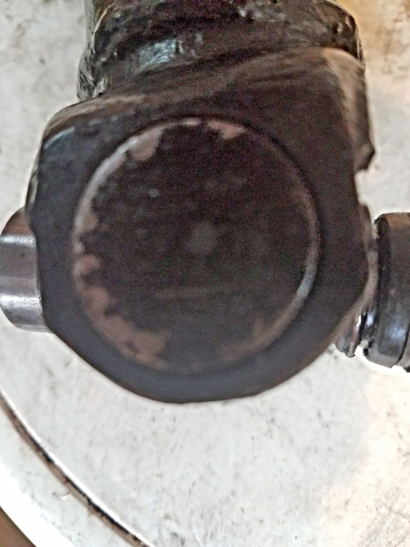

We decided we want to replace the U-Joint. Couldn't find YouTube video the was like ours. How do we replace? Is the circled area a removable pin? Two in each side. If so how?

I believe that is nylon. If you heat it with a torch, it should come out like a worm all by itself once it gets hot enough. It must be the original parts. The replacement joints will come with a C-clip for each side to hold things together.
Let me know if that helps.

You were right they came out with heat. We have it together but still not shifting with engine running. No longer any grinding, just wont move out of neutral position. Will go through all positions easily with engine off.

Isn't that an interesting way to remove a U joint? Lol I haven't done one of those in a long time.

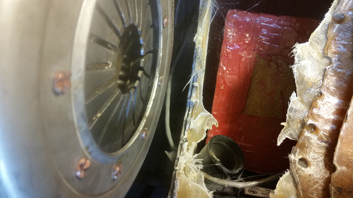

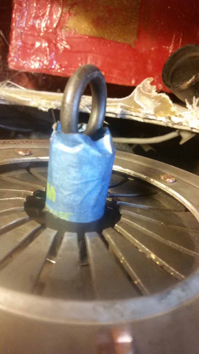

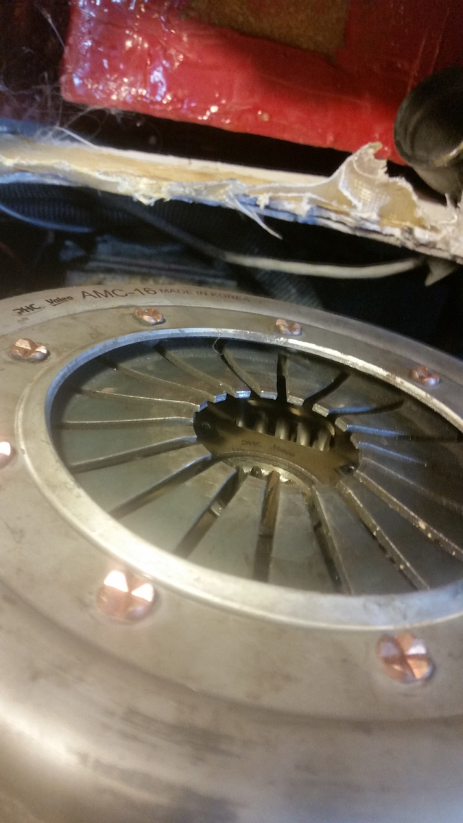

On the clutch is sounds like you have a bent pressure plate which will never release. Make sure the transmission does not "hang" while engaged into the clutch disc without having the mounting bolts to hold it. Get a new clutch kit. here is a the correct way to install a clutch.

We took the pressure plate to a clutch and brake place to have it tested. It tested fine.
Going to disassemble again.
Not sure about testing for hang, have to leave transmission fluid in transmission when taking apart?

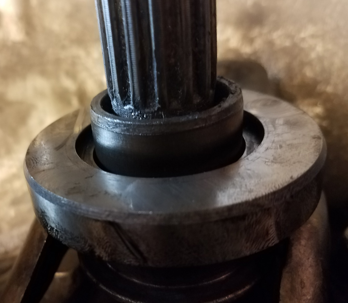

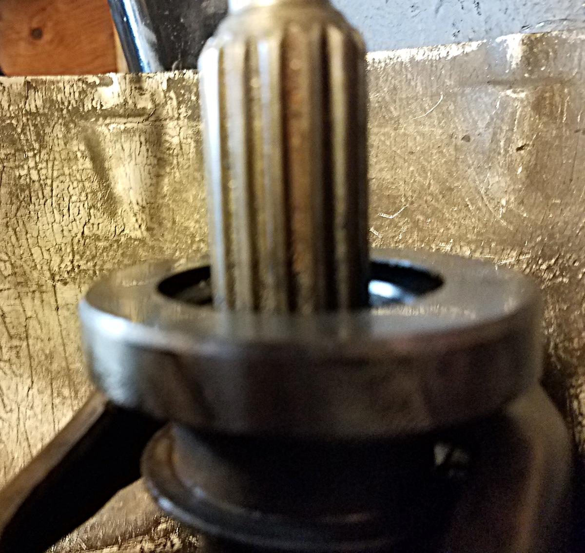

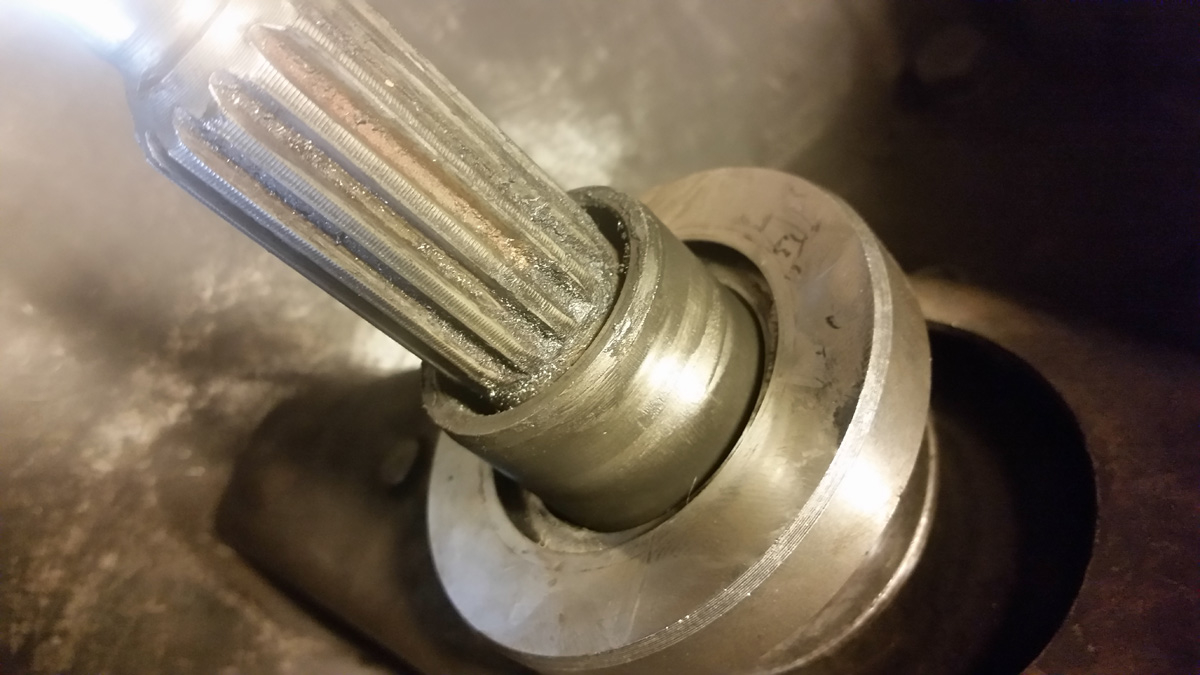

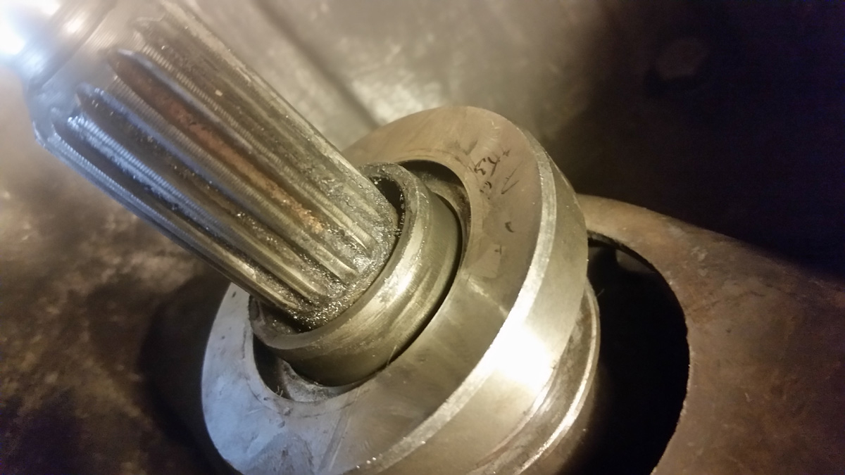

And the saga continues. Where can I get the part number for the clutch fork/release lever? Haven't been able to find one online. Want to replace it and the rest of the stuff that goes with it. It looks like the release bearing doesn't move forward enough.

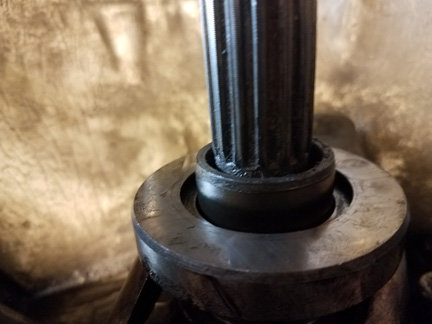

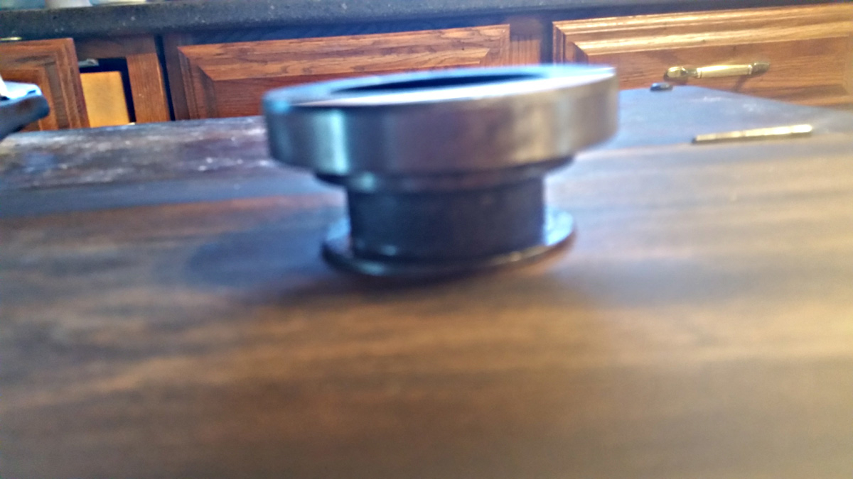

Don't think release bearing is putting pressure on clutch plate.
Sunday, August 25th, 2019 AT 7:49 PM
  • 109,885 POSTS
Welcome back:

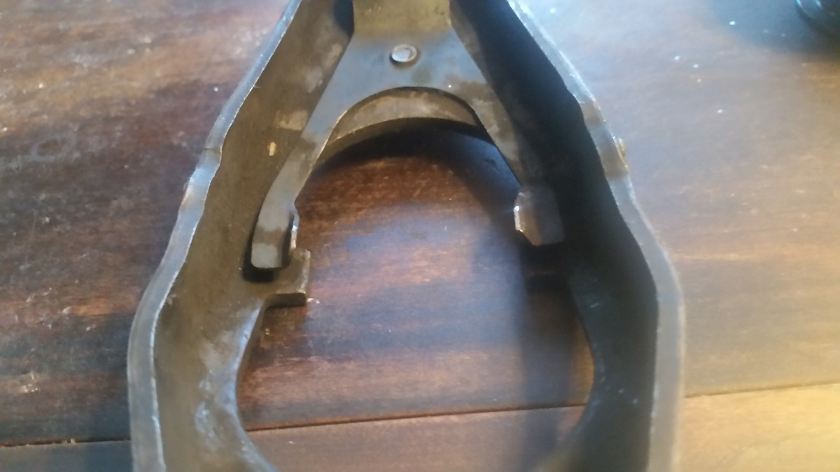

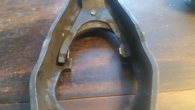

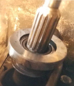

It doesn't look like it was touched. Are you certain the fork is installed correctly? Are you sure it isn't bent? The only other things are the cable or a wrong part.

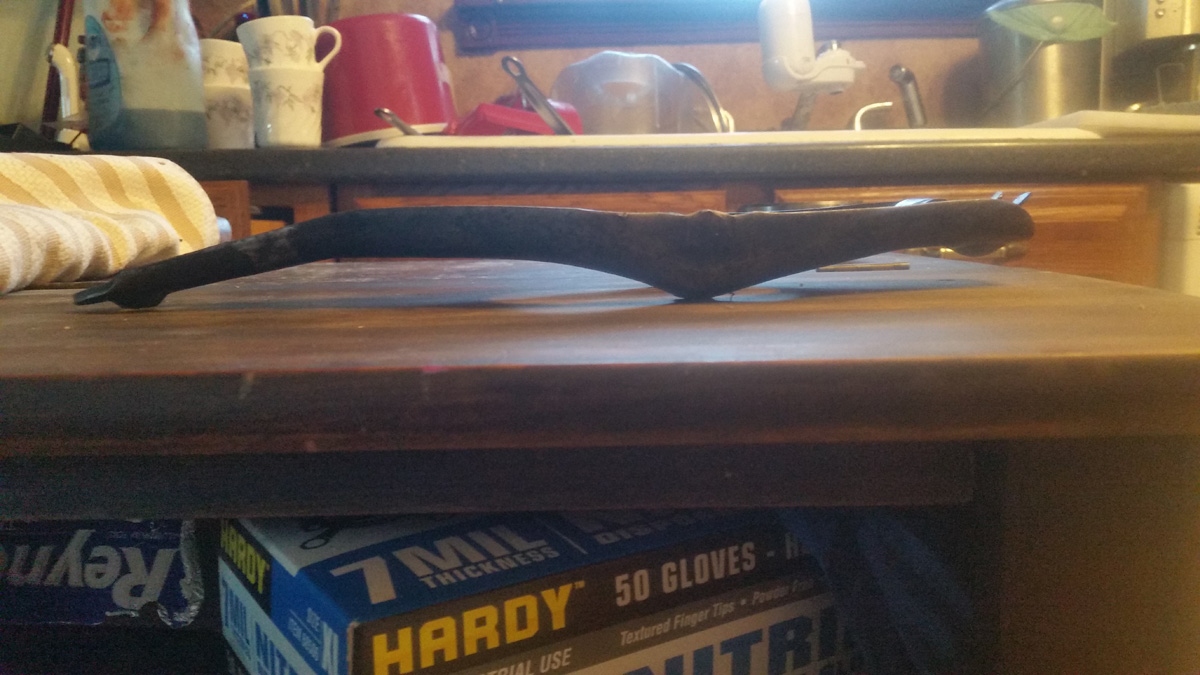

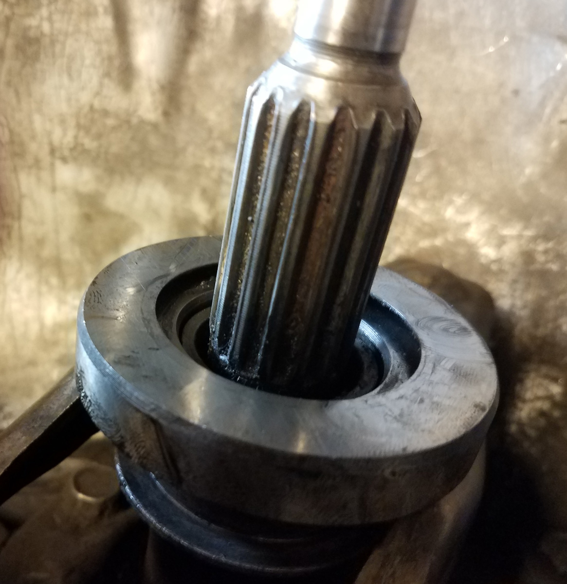

That is why sent picture of fork. Does it look bent to you? The clutch disc and clutch plate match the old ones. When it is assembled the clutch fork is all the way forward, I would think it should be part way back. I don't see how the fork could get bent as it is pretty heavy steel. We have removed and reinstalled the fork, but cannot get it to move the bearing far enough forward. Could the bearing not be tall enough?

Yes is could, do you have much play in the clutch fork?

Dummy of the year award here. The fork pin was in original position, Backed it off and now have about 3/8" coverage of splines fork forward and 3/8" of smooth shaft showing fork back. Is this about right or should there be more forward?
Wednesday, August 28th, 2019 AT 2:58 PM
  • 109,885 POSTS
Welcome back:
That should be close enough so it can be adjusted with the cable if it needs more.

It's finally functioning, Thanks for all your help.
