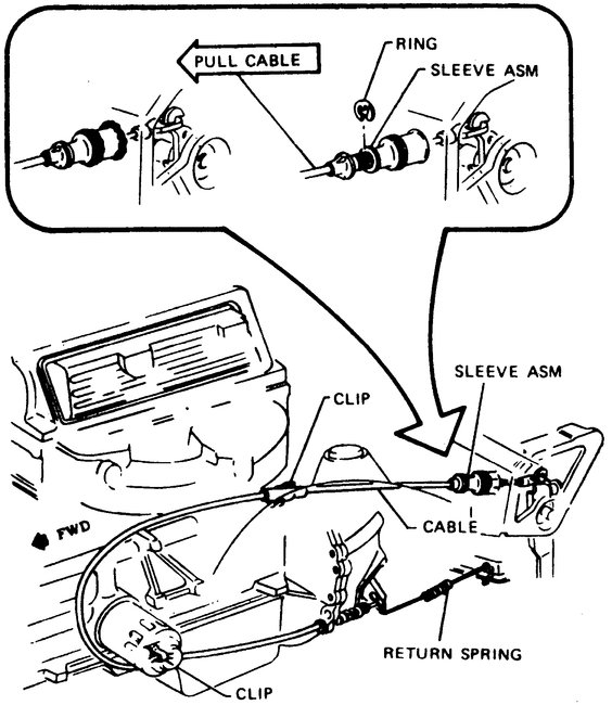

If it won't shift when the engine is running, then the clutch isn't disengaging. If there are no strange sounds associated with this new problem, I suspect the cable has broken or needs readjusted. Here are the directions specific to this vehicle for clutch cable adjustment. The attached pictures correlate with these directions.
______________________________________
clutch cable
1983 Chevrolet Chevette L4-98 1.6L
Clutch Adjustment
Vehicle Transmission and Drivetrain Clutch Adjustments Clutch Adjustment

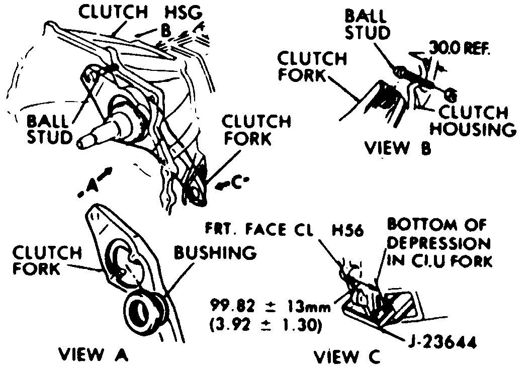

CLUTCH ADJUSTMENT
Figure 4 / See Pic 1
Figure 5 / See Pic 2
1. Perform initial ball stud adjustment as follows:
a. Place gauge J-28449 with flat end against clutch housing front face and the hooked end positioned in the bottom depression of the clutch fork, Fig. 4.
b. Turn ball inward until clutch release bearing contacts clutch spring.
c. Install and torque lock nut to 25 ft. lbs. (33 Nm).
d. Remove gauge.
2. Attach and adjust clutch cable as follows:
a. Install clutch cable through hole in clutch fork and seat, then install return spring.
b. From engine compartment, pull cable until clutch pedal is firmly against pedal stop and hold in position, Fig. 5.
c. Install snap ring in first fully visible groove in cable from sleeve, then release cable.
d. Clutch pedal lash should be 0.58 to 1.08 in. (15-27 mm), if not, proceed to step 3.
3. If clutch pedal lash is insufficient, remove snap ring from cable and allow cable to move into dash by one cable notch, then reinstall snap ring, Fig. 5.
4. If clutch pedal lash is excessive, remove snap ring from cable, and pull cable out of dash by one cable notch, then reinstall snap ring, Fig. 5.
5. Check to ensure clutch pedal lash is 0.58-1.08 in. (15-27 mm).

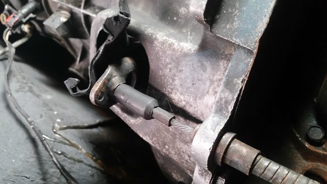

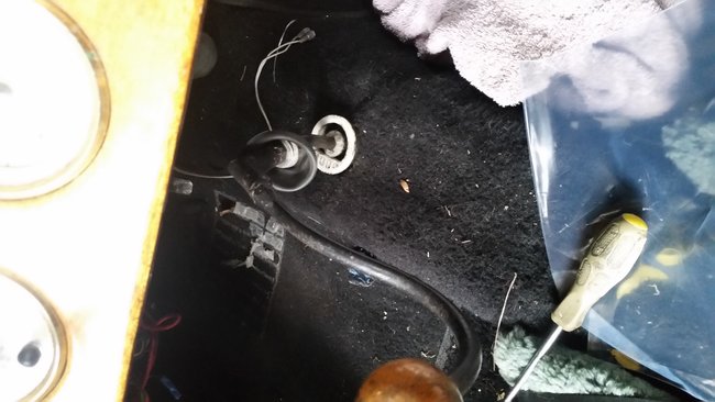

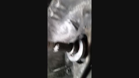

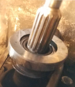

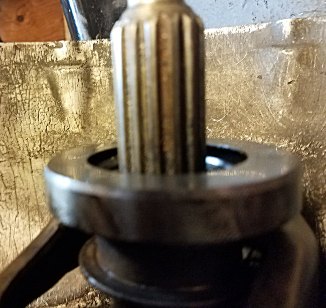

Thanks for the answer. This is actually a "Kit Car" on a Chevette Chassis. Here are some pictures. I am not very versed in mechanics. Applying the clutch pedal moves the lever all the way forward, when released it goes within about 3/4" of all the way.
Mar 19, 2019 at 12:34 PM

Okay, then the clutch isn't disengaging. The only thing I can say is you need to start at the pedal and work toward the clutch. Since this system isn't hydraulic, either something has broken (pressure plate, release bearing, release fork) or the cable itself is bad and out of adjustment.

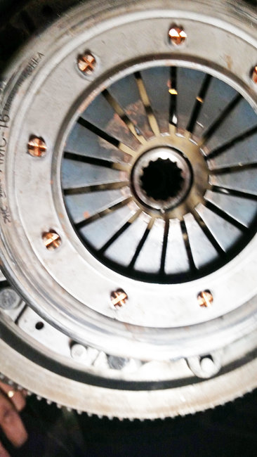

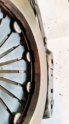

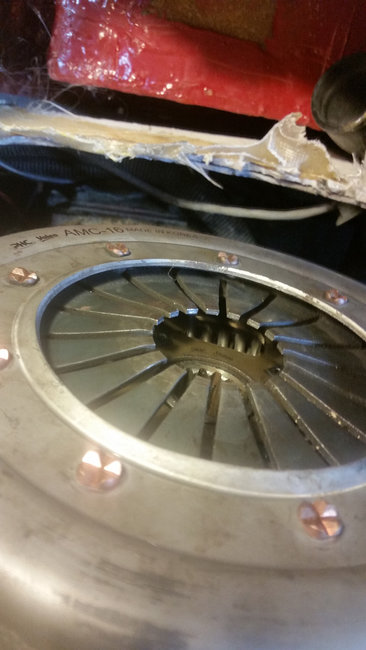

Finally able to get back to this. Clutch Fork seem intact, How do you evaluate pressure plate?
Jun 5, 2019 at 12:14 PM
  • 110,190 POSTS
Welcome back:

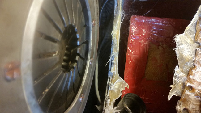

As far as a pressure plate, you need to check the pressure plate springs to see if they are broken. Again, the best thing is to remove it for inspection. Does the clutch fork move when you depress the clutch? If it does, either it is broken, is disconnected from the release bearing, or the pressure plate is bad.
Jun 5, 2019 at 4:56 PM

The clutch fork is supposed to move isn't it? See attached.
Jun 5, 2019 at 6:10 PM
  • 110,190 POSTS
Welcome back:
Yes, that is what presses the release bearing against the pressure plate to disengage the transmission from the flywheel. When released, the pressure plate springs keep pressure on the clutch disc pushing it against the flywheel. When you press the clutch, that bearing releases the pressure from the pressure plate springs allowing the clutch disc and flywheel do spin freely. Do you have any pictures of the pressure plate and clutch disc?
Jun 5, 2019 at 7:04 PM

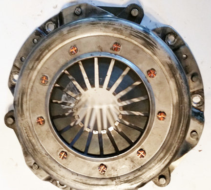

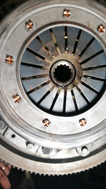

Hard to get a picture square on.
Jun 5, 2019 at 7:21 PM
  • 110,190 POSTS
Hi Mike:
Honestly, the pictures are fine and the pressure plate to be fine too. You didn't notice any broken springs, correct?
Jun 5, 2019 at 9:39 PM
MICHAEL CHAVOR
  • 23 POSTS

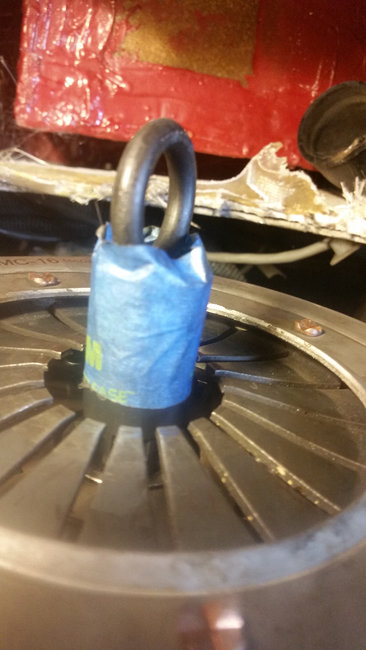

No Broken springs. Tried pushing on plate with a dummy donut, but it doesn't move, Shouldn't it?
Jun 24, 2019 at 11:16 AM
  • 110,190 POSTS
The tangs (springs) around the pressure plate are what move. When the release bearing pushes against them, they should move in and release the pressure from the clutch disc and disengage the transmission. Is that what is happening? I used one of your pictures and circled where the release bearing pushes. Those tangs are very rigid, but when pressure is applied to them, their pressure is released from the disc. Are the two of them stuck together somehow?
Jun 24, 2019 at 5:48 PM
MICHAEL CHAVOR
  • 23 POSTS

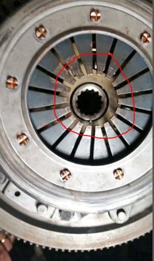

When pressure applied to Tangs there doesn't seem to be any movement.
Jun 25, 2019 at 9:52 AM
  • 110,190 POSTS
Something is stuck together then. Remove the pressure plate and check if the clutch is stuck to the flywheel. Something is going on there. you should be able to move the disc when the pressure plate is released. At this point, it needs to come off the engine.
Jun 25, 2019 at 7:17 PM
MICHAEL CHAVOR
  • 23 POSTS

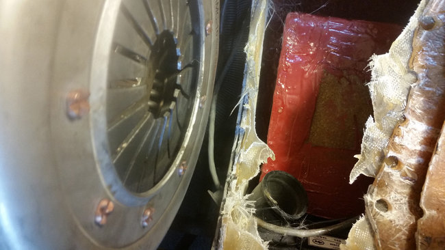

it is off engine. the pictures I sent were of it off. The Tangs do not move and there is a gap between the nobs on the Tangs and the plate. See pictures.
Jun 25, 2019 at 8:40 PM
  • 110,190 POSTS
Was the clutch disc stuck in anyway? So help me understand. The pressure plate is stuck in it's present position and won't release, is that correct? If that's the case, the pressure plate is bad.

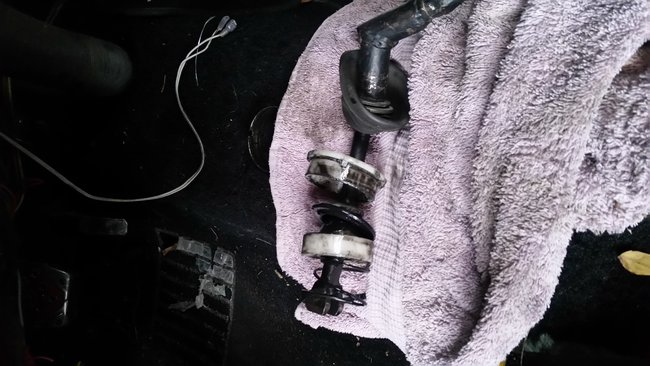

No it wasn't. had pressure plate tested, it is good. We removed Flywheel and had it turned. We are now trying to put it back together. We are having trouble putting the drive shaft on. The trunnion caps don't want to seat in the cups. One side will go in but not the other? Must be a trick to getting them both to seat?

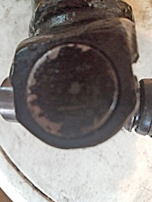

MICHAEL CHAVOR
  • 23 POSTS

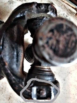

We decided we want to replace the U-Joint. Couldn't find YouTube video the was like ours. How do we replace? Is the circled area a removable pin? Two in each side. If so how?
Aug 8, 2019 at 12:41 PM
  • 110,190 POSTS
Welcome back:
I believe that is nylon. If you heat it with a torch, it should come out like a worm all by itself once it gets hot enough. It must be the original parts. The replacement joints will come with a C-clip for each side to hold things together.

You were right they came out with heat. We have it together but still not shifting with engine running. No longer any grinding, just wont move out of neutral position. Will go through all positions easily with engine off.

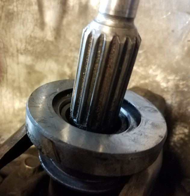

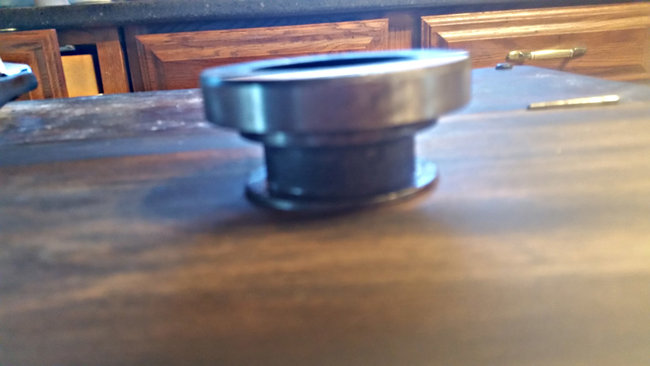

and the saga continues... Where can I get the part number for the clutch fork/release lever? Haven't been able to find one online. Want to replace it and the rest of the stuff that goes with it. It looks like the release bearing doesn't move forward enough.
Aug 22, 2019 at 5:56 PM
  • 54,178 POSTS
Try RockAuto.com or its going to be a wreaking yard the only place you will find parts for this car.
Aug 23, 2019 at 12:04 PM
MICHAEL CHAVOR
  • 23 POSTS

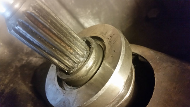

Don't think release bearing is putting pressure on clutch plate.
Aug 25, 2019 at 7:49 PM
  • 110,190 POSTS
Welcome back:
It doesn't look like it was touched. Are you certain the fork is installed correctly? Are you sure it isn't bent? The only other things are the cable or a wrong part.
Let us know.
Aug 25, 2019 at 8:04 PM

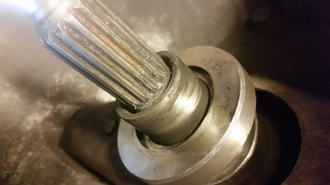

MICHAEL CHAVOR
  • 23 POSTS

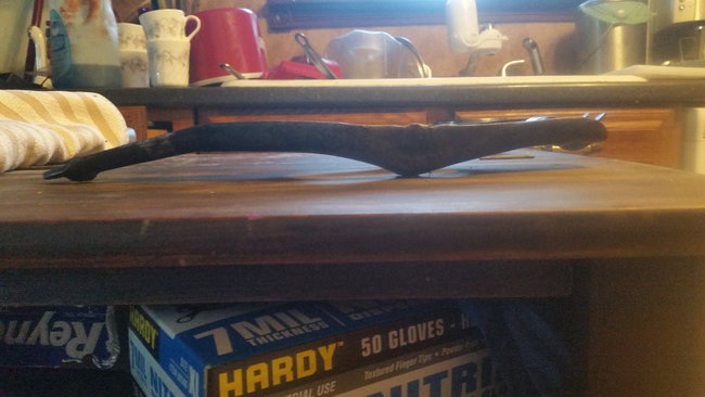

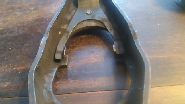

That is why sent picture of fork. Does it look bent to you? The clutch disc and clutch plate match the old ones. When it is assembled the clutch fork is all the way forward, I would think it should be part way back. I don't see how the fork could get bent as it is pretty heavy steel. We have removed and reinstalled the fork, but cannot get it to move the bearing far enough forward. Could the bearing not be tall enough?
Aug 25, 2019 at 10:46 PM
  • 54,178 POSTS
Yes is could, do you have much play in the clutch fork?
Aug 26, 2019 at 12:39 PM

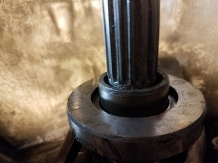

MICHAEL CHAVOR
  • 23 POSTS

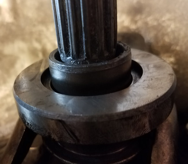

Dummy of the year award here. The fork pin was in original position, Backed it off and now have about 3/8" coverage of splines fork forward and 3/8" of smooth shaft showing fork back. Is this about right or should there be more forward?
Aug 28, 2019 at 2:58 PM
  • 110,190 POSTS
Welcome back:
That should be close enough so it can be adjusted with the cable if it needs more.
Let me know if it takes care of the problem.
Aug 28, 2019 at 5:09 PM
MICHAEL CHAVOR
  • 23 POSTS
It's finally functioning, Thanks for all your help.
