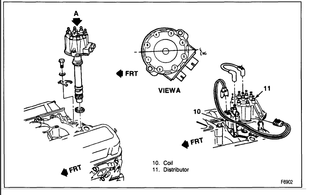

will not run on starting fluid, the code is flash pause flash flash, then long pause and repeat flash pause flash flash..thinking it must be something with the spark.
Nov 26, 2017 at 11:53 PM
  • 55,721 POSTS

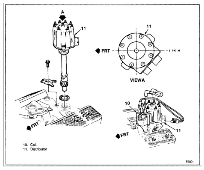

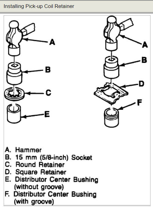

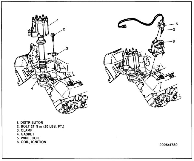

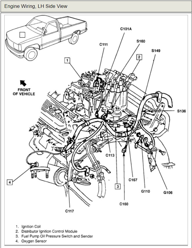

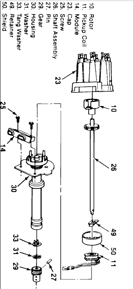

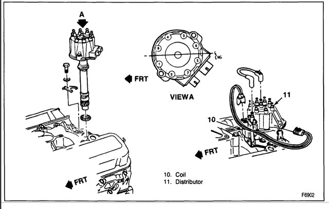

Yep that is what it sounds like. The code it is trying to tell you is 12 which means it cant find anything wrong which leads us to the ignition coil, module and pick up. Here is a guide to ehlp you get these components changed out I recommend AC Delco from Amazon.
Here are some diagrams that shows how to remove the distributor, ignition pickup and coil assemblies. (below)
