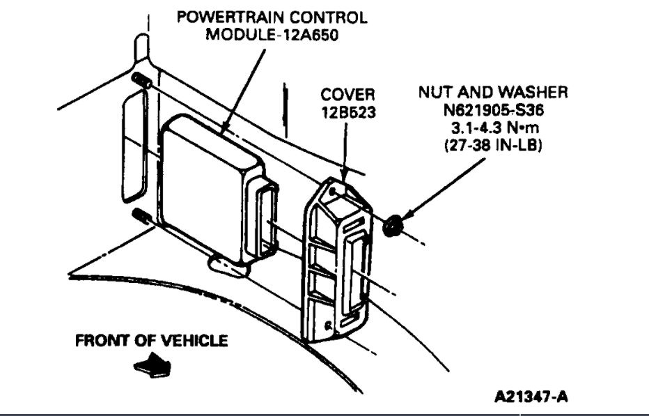

REMOVAL
1. Open hood and disconnect negative battery cable.
2. Loosen connector to module retaining bolt and unplug connector.
3. Remove two nuts and PCM cover.
4. Remove PCM from left hand inner fender.
INSTALLATION
To install PCM, reverse removal procedure.
