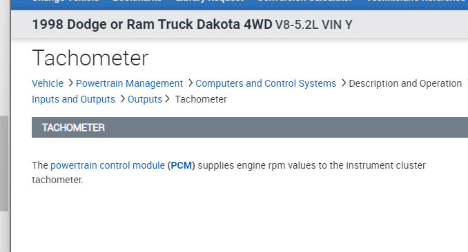

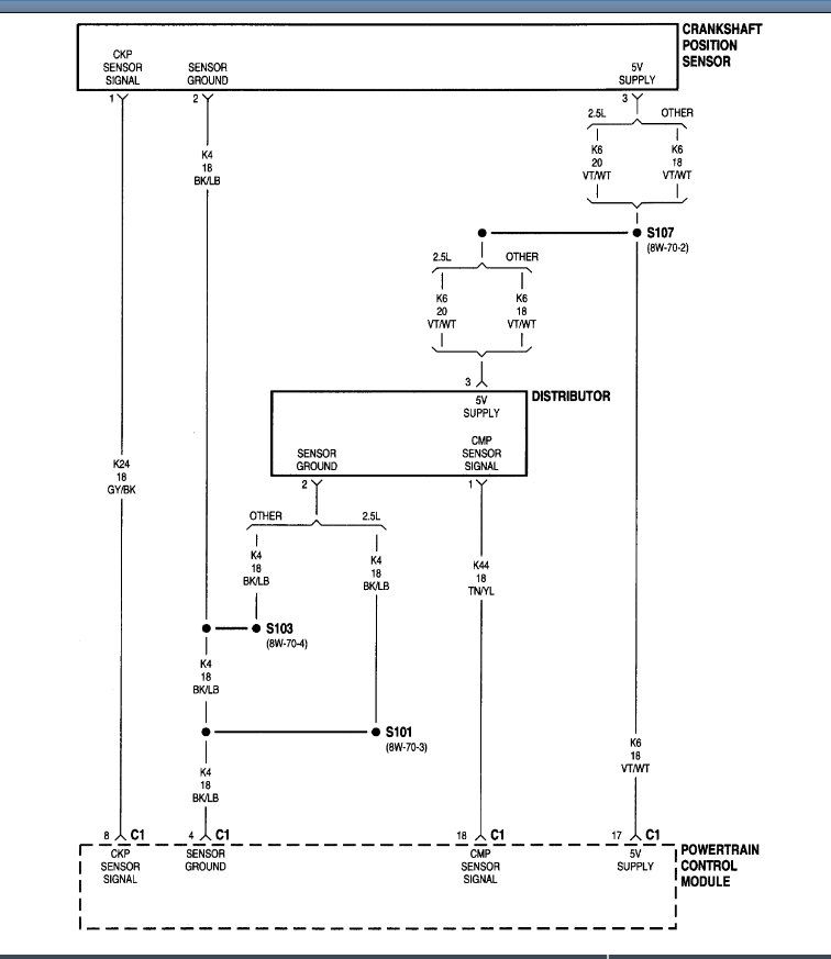

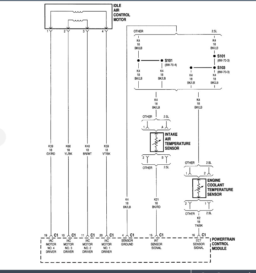

If you look at the wiring diagrams the PCM controls the idle air and the tach, so I am thinking worst case the PCM failed when connecting the battery again. However, this is why I would like to try and force a restart before we get too far.
