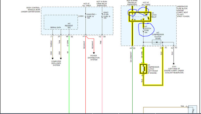

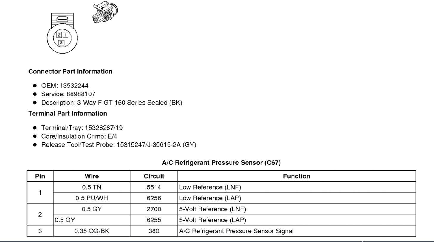

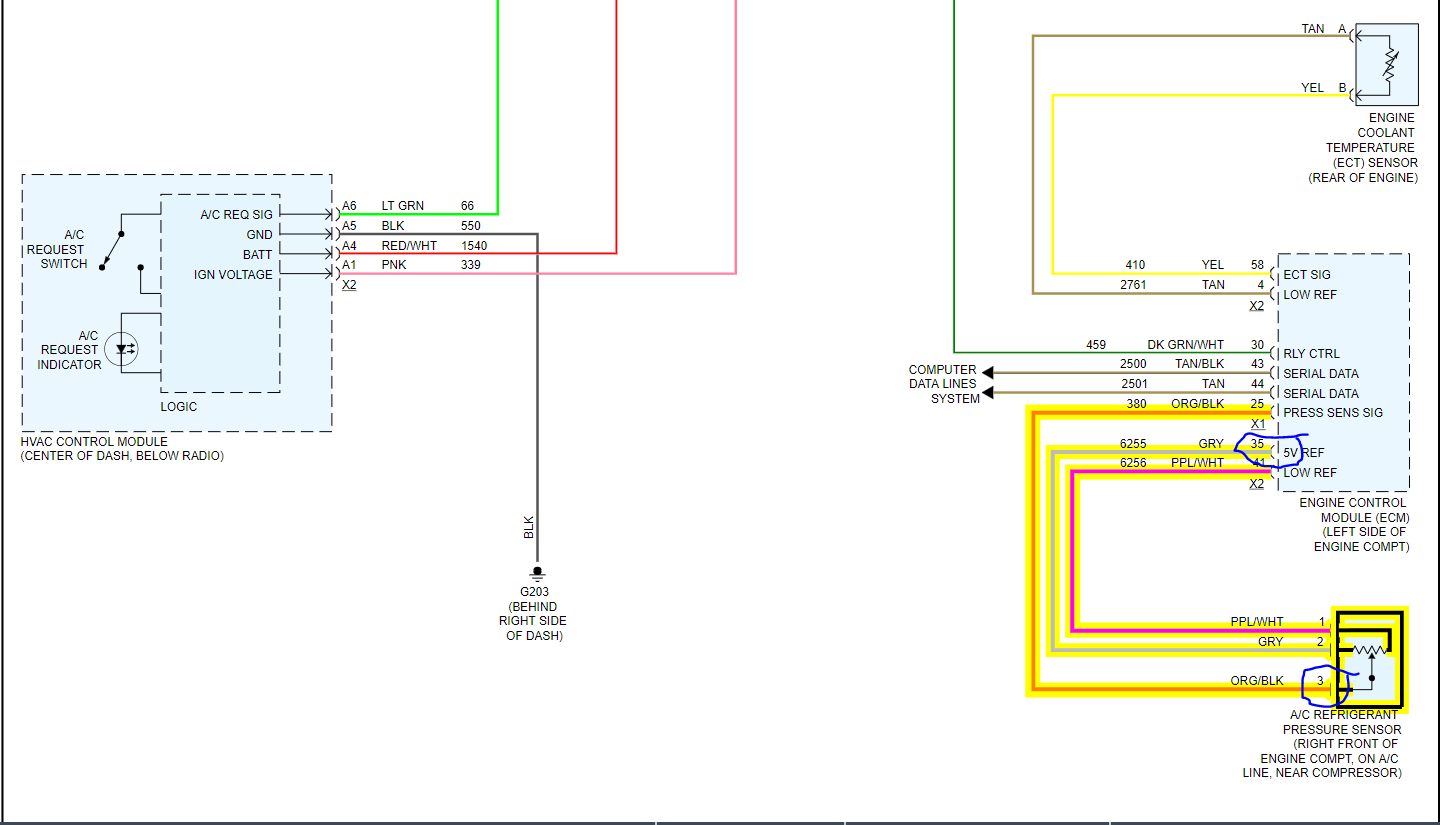

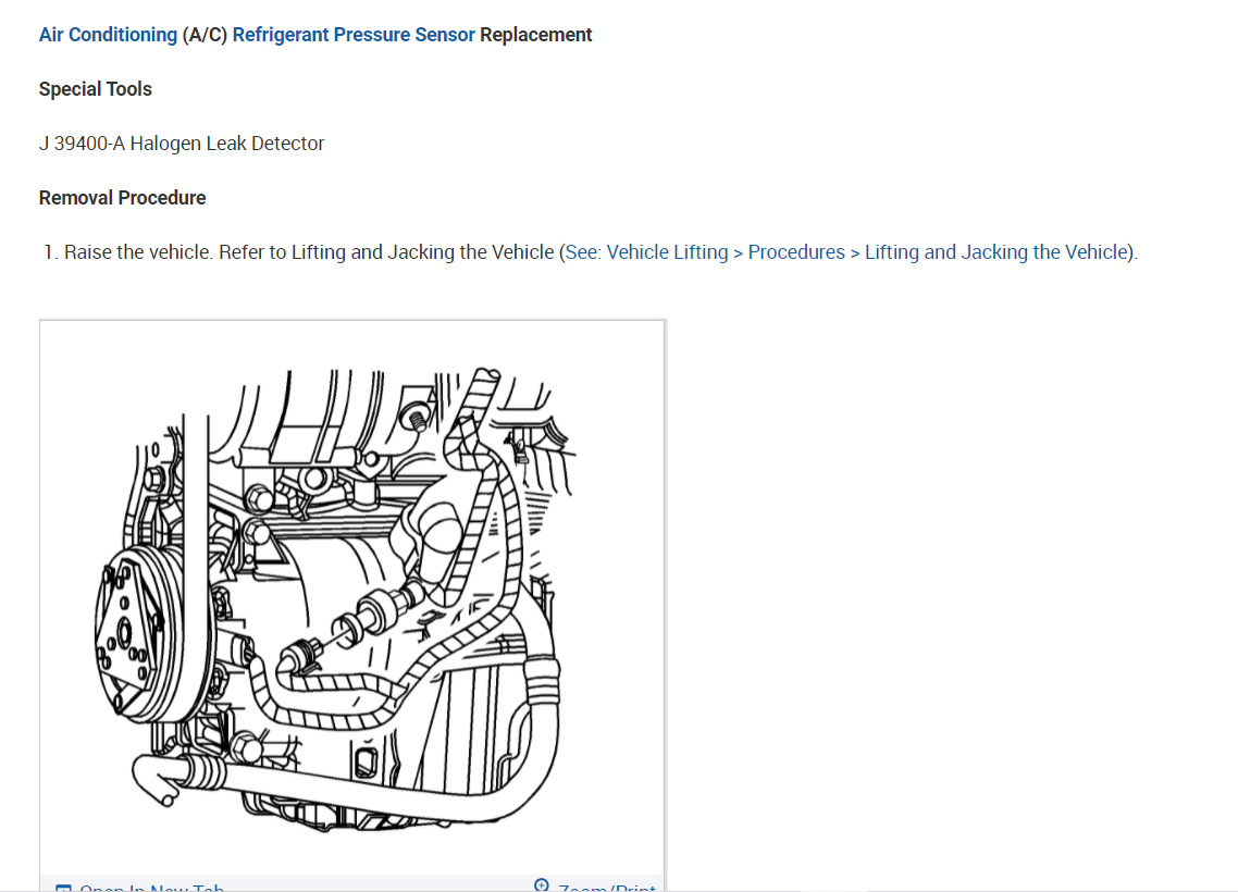

There is no power being sent to the clutch. I checked the relays and fuse they looked good. The pressure sensors are also working. I test the ground with my continuity tester it was also good. The switch just got replaced. I'm running out of ideas on why there is no power being sent to the clutch.
May 5, 2021 at 7:11 AM
Good afternoon,

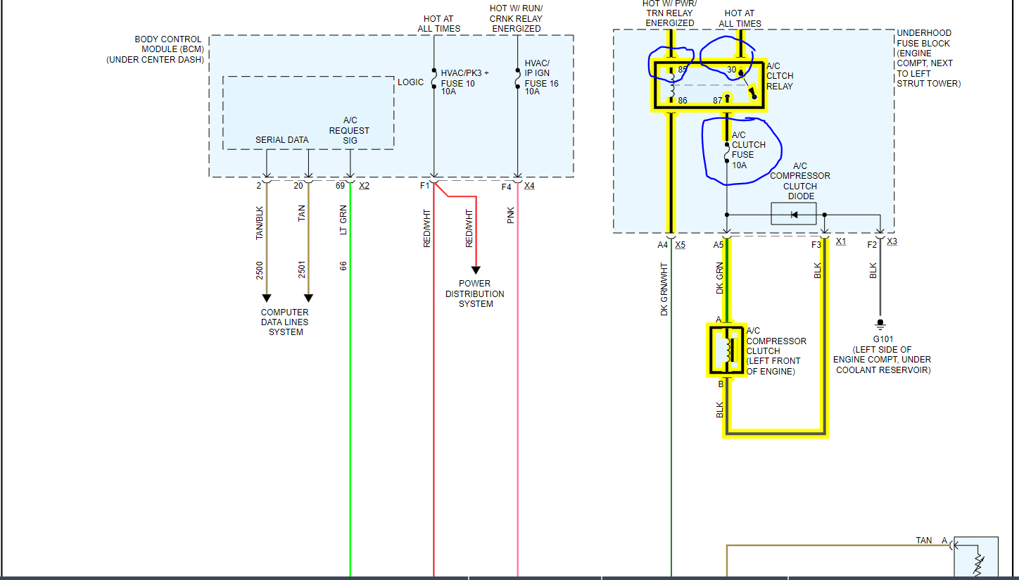

The power comes from the relay. I attached a wiring diagram for you to view. Check the fuse I circled for power on both sides with the key on and the A/C commanded on.
Also, can you give me the pressure readings of the A/C system? If the Freon is low, the compressor will not activate.
