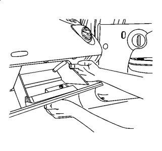

does an 07 pontiac G5 have a cabin filter
Mar 11, 2010 at 12:54 PM
DOCFIXIT
  • 18,828 POSTS
Yes it does remove glove box pinch each side in

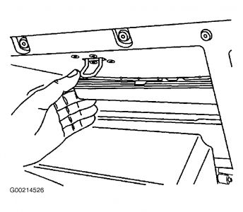

Then unlatch door to filter

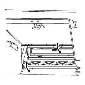

remove filter
