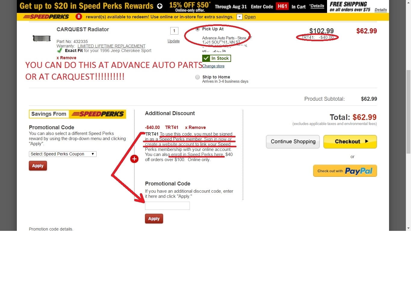

I'm banking on a restricted radiator!
Flush?
Heck no, that usually don't get it all, and you still have an old radiator.
How 'bout this?
http://shop.advanceautoparts.com/p/carquest-radiator-432335/19920367-P?searchTerm=radiators
Yeah, I can do you a lot better than that! Read this!
https://www.2carpros.com/questions/2001-dodge-neon-milage-just-want-put-fliuds-their-locations
I took the liberty of running this radiator into the check out so you can see the deal!
Find the radiator at either Advance Auto Parts or Carquest/ add to cart/ enroll in "Speed Perks"/ use promo code "TRT41 in promo box, the apply/ watch $40 drop on price/ select nearby store to pick up from in 30 minutes/ MAKE SURE ALL OF THE INFO IS CORRECT!/ GO TO CHECKOUT/ PAY ONLINE/ IN 30 MINUTES PICK UP YOUR PRIZE!
See pick below
Return saying that CJ MEDEVAC is the greatest! Lol!
The Medic
