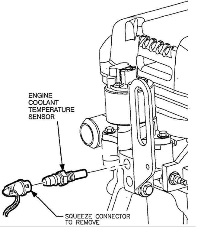

Tonight I replaced the engine coolant temperature sensor, I will not know if that fixed it until I get home from work tomorrow since this problem only happens once the engine is warmed up. I will post results here.
Jun 27, 2017 at 1:49 PM
  • 55,309 POSTS
That is exactly what I was going to suggest.
Here is a guide that will show you what you are in for when doing the job.
https://www.2carpros.com/articles/coolant-temperature-sensor-cts-replacement
Here is a diagram of where its at on your car. (below)
Great job on the video BTW
Please let us know what happens, we are interested to see what it is.

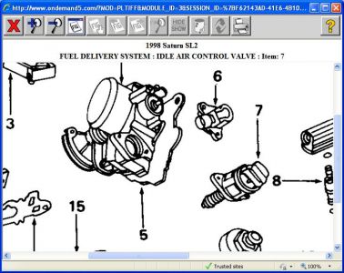

https://images.2carpros.com/forum/automotive_pictures/416332_iac_pic_1.jpg
when u changed the coolant temp sensor did u inspect the coolant temp sensor connector?if not check that out and if its corroded then replace the connector.i would try taking off the idle air control motor its diagram number 7 on the diagram i posted also clean out the hole it goes in real good the hole passes thru the bottom of the throttle body opening u will see the hole if u look into the opening of the throttle.use some carb spray.let me know what u find.
