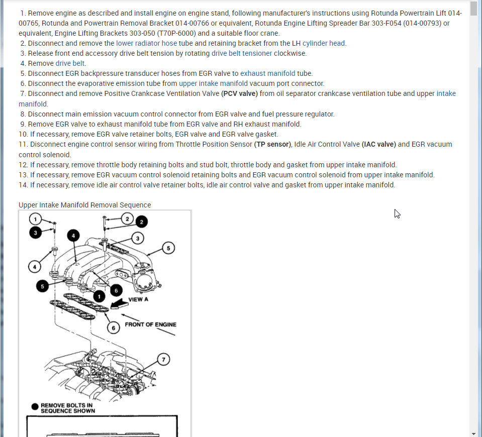

  • CAR REPAIR CONTRIBUTOR

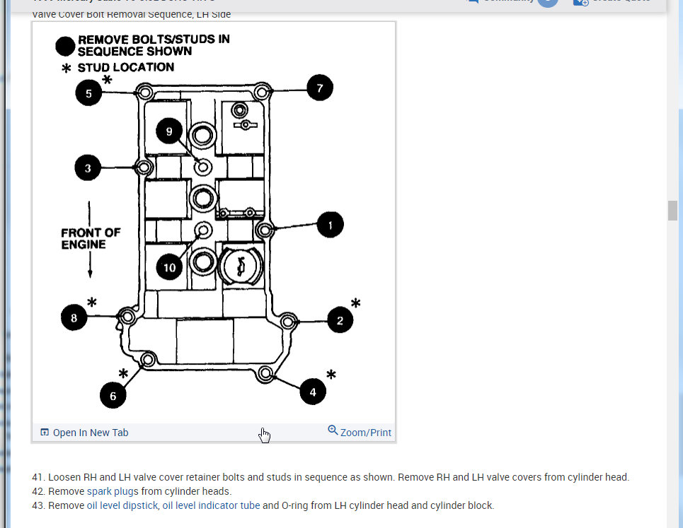

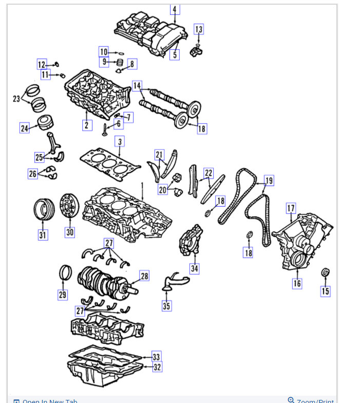

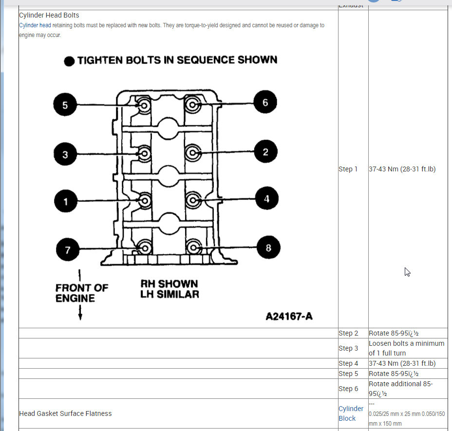

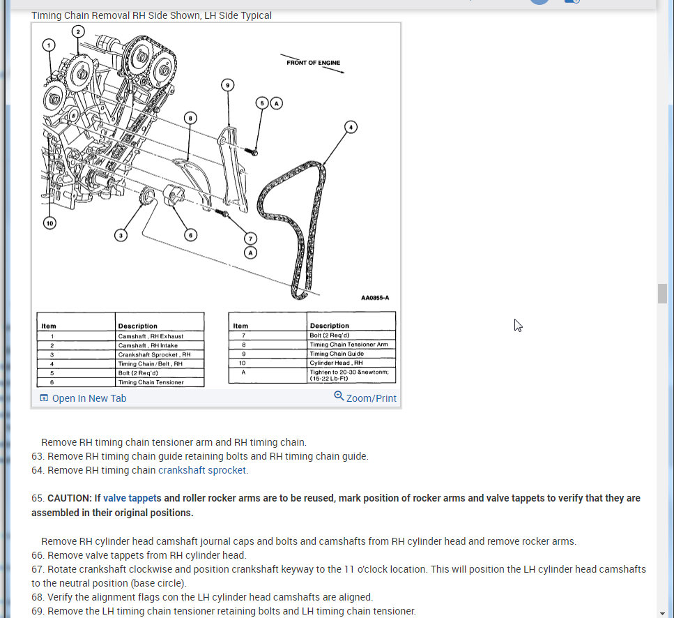

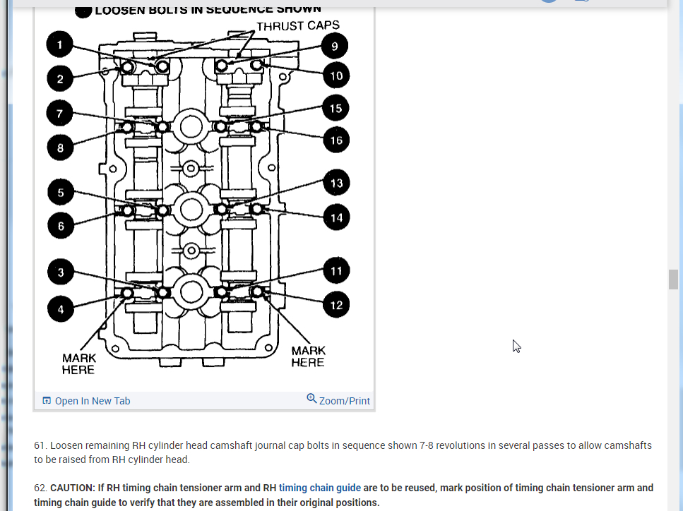

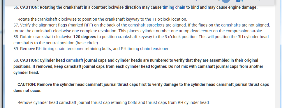

Unfortunately then that points pretty much only to a head gasket or warped head. I attached more info for this as well.
This info is for the DOHC motor as that is the more common engine but clearly this is not a fun job to do. Let us know if you need more info. Thanks

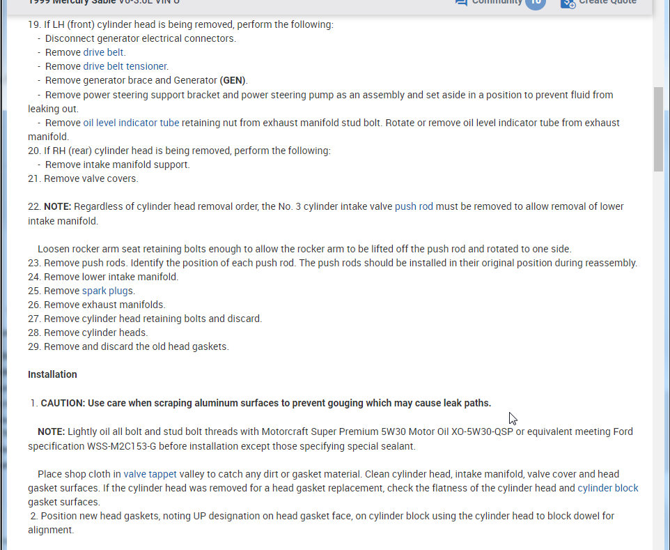

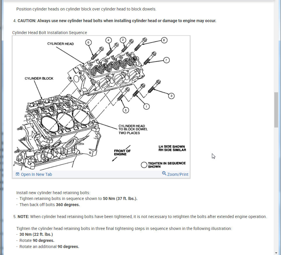

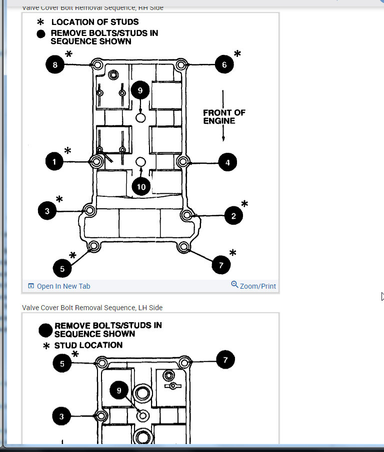

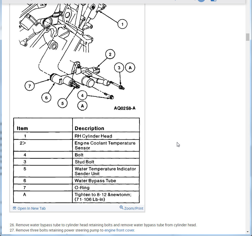

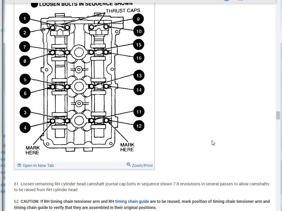

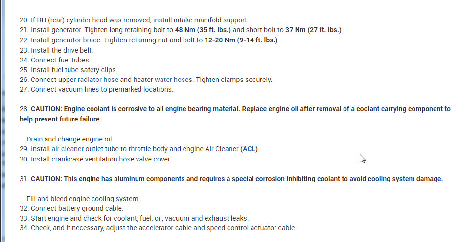

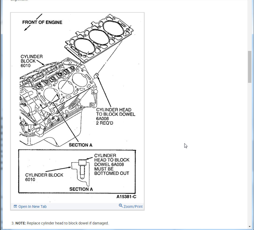

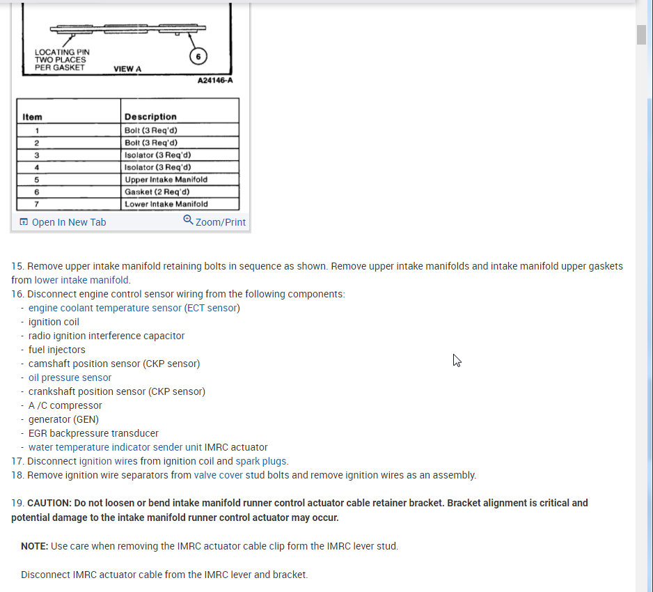

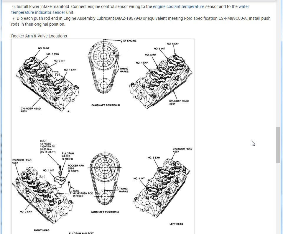

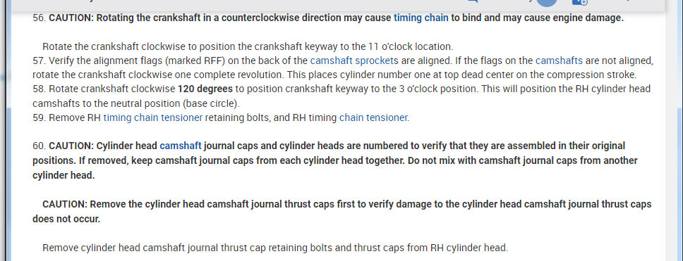

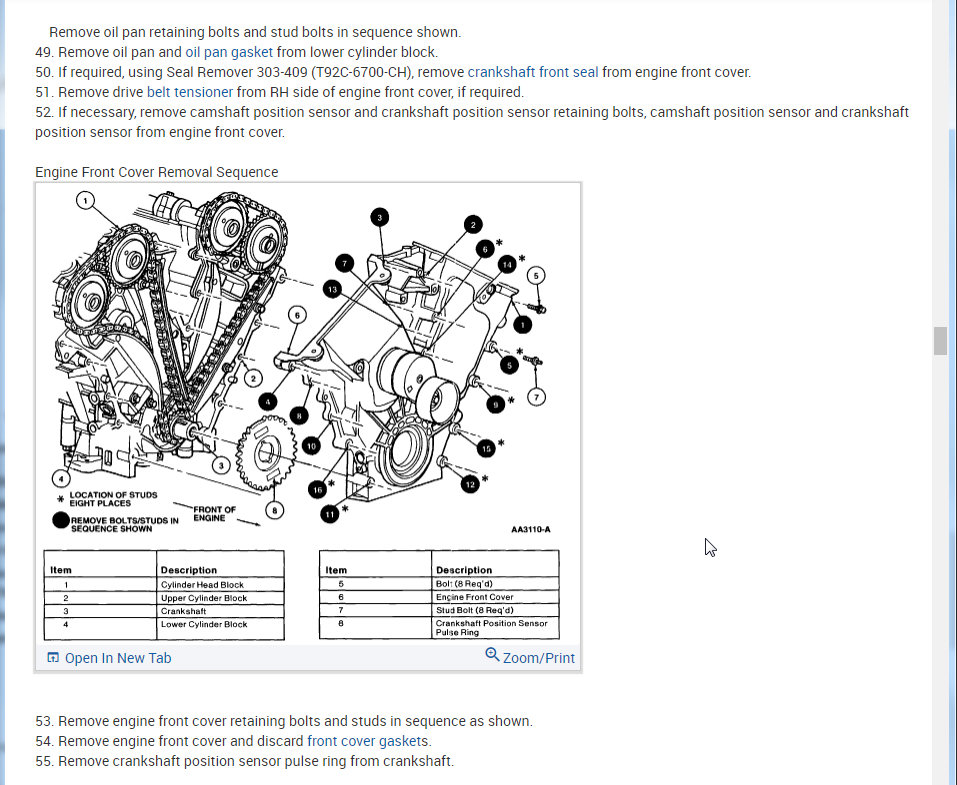

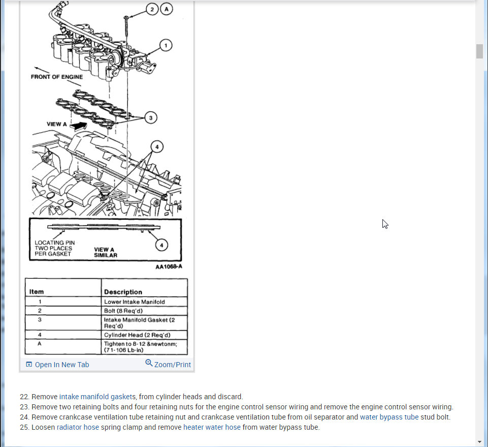

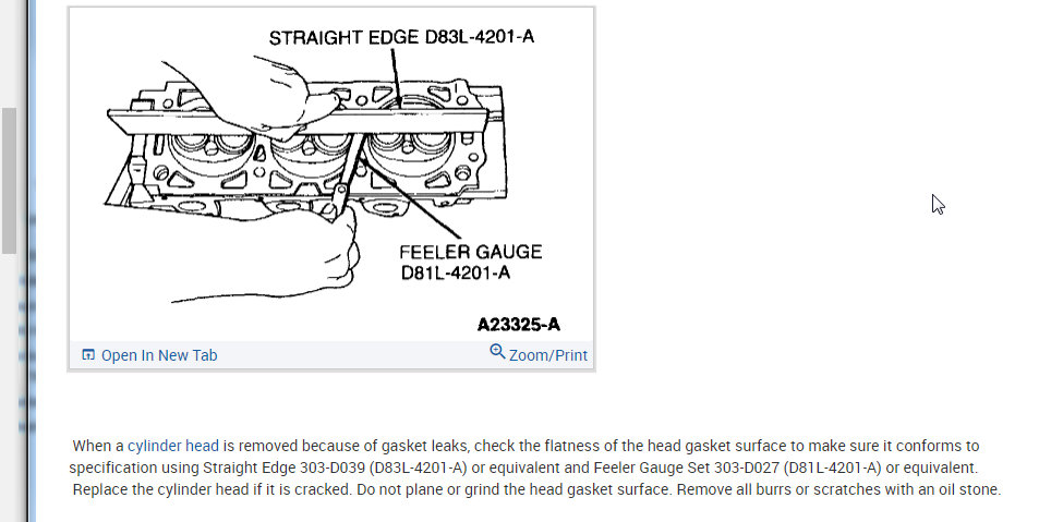

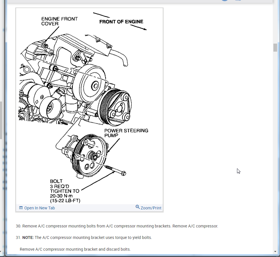

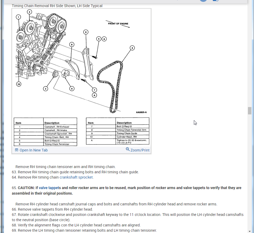

Of course you have the other engine from what I provided. :)

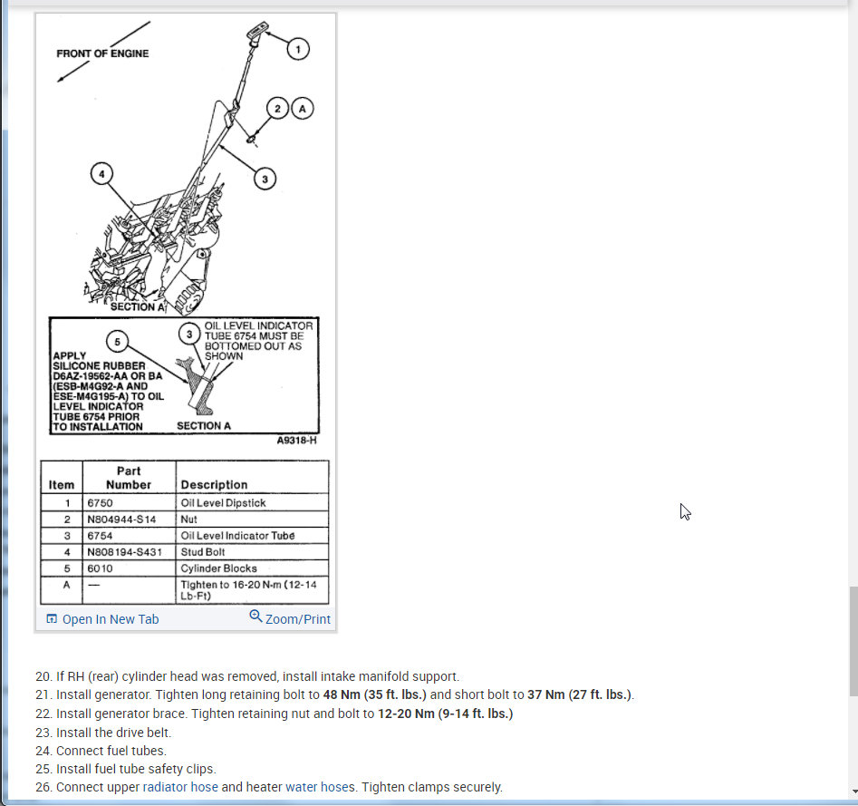

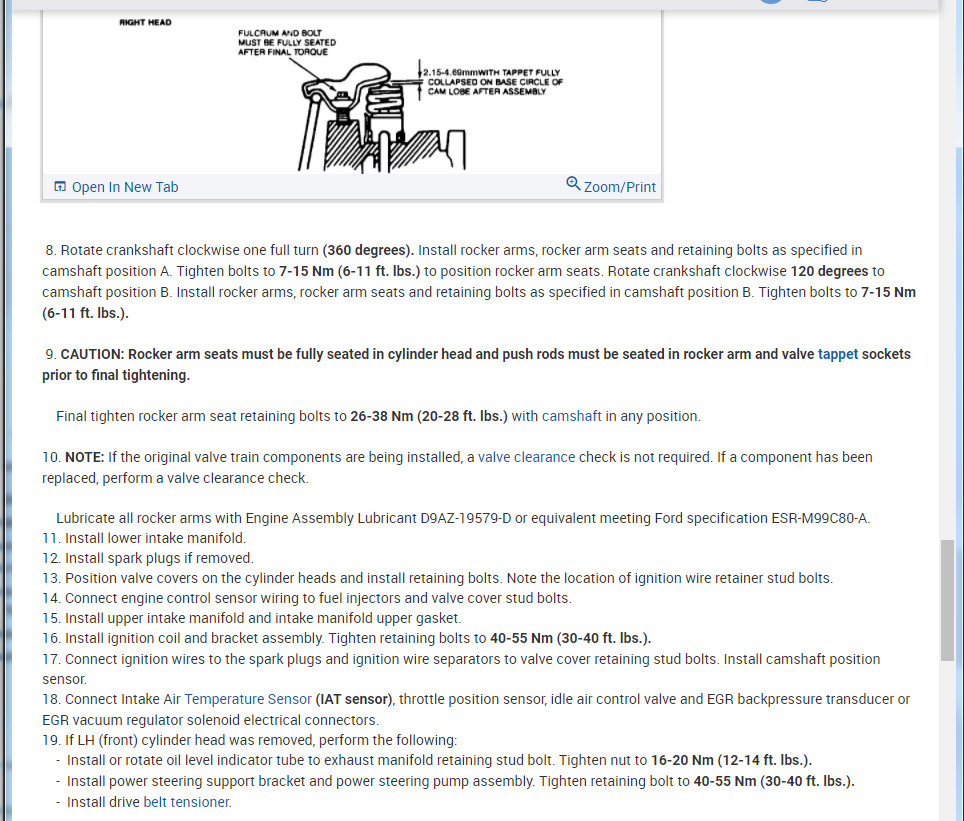

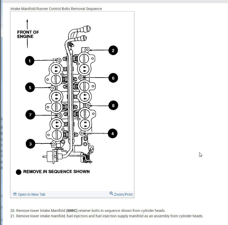

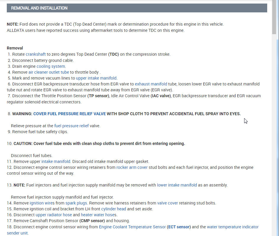

Below is the process for removing the heads.
As for the starter, can you get a picture of the crack? Normally I would not worry about it if you can still tighten the starter bolts. If there is a crack that doesn't affect the bolts, I would just use some JB weld to give it a little structure or support but it should be ok.
The only times a crack has to be repaired by replacing the case is when you can't tighten a bolt or it leaks. Other then that, most cracks will not effect the unit.
