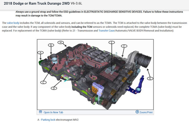

Where is the transmission range sensor located?
2018 DODGE DURANGO
70,000 MILES • 3.6L • V6 • 2WD • AUTOMATIC
HOWELLK17
  • 5 POSTS
Transmission range sensor location needed.
Dec 27, 2024 at 12:47 AM
  • 55,433 POSTS

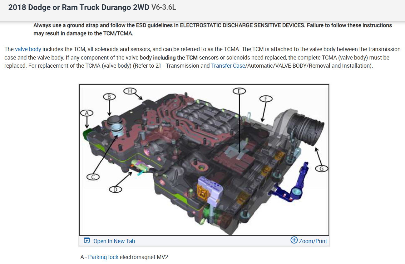

The transmission range sensor is part of the valve body, here is what the part looks like that has this sensor intergraded into, what problem are you having? Check out the images (below).
Dec 27, 2024 at 4:18 AM
HOWELLK17
  • 5 POSTS
A lot of problems. When you go to start it, it won’t start. Stays in run and can’t shut it completely off. Message on dashboard that says service transmission car is not in park continue in D and don’t turn engine off. The FCW lights are on my dashboard and won’t stay off when you turn them off in the uconnect. The shifter knob is all lit up red, and have to disconnect the battery to keep it from draining the power.

Let's check the fuses #60 # 94 in the fuse panel under the hood, this guide can help:
If the fuses are okay I would replace the valve body which is the transmission control module. Make sure you clear the codes once the repair is completed. Please go over this guide and get back to us.

Replacing it is not too bad, but it will need to be programmed, do you have that capability?
Dec 30, 2024 at 1:10 AM
HOWELLK17
  • 5 POSTS
No I do not.
Dec 30, 2024 at 2:23 AM
  • 55,433 POSTS
no problem, then it would be best to have a repair shop do it for you.
