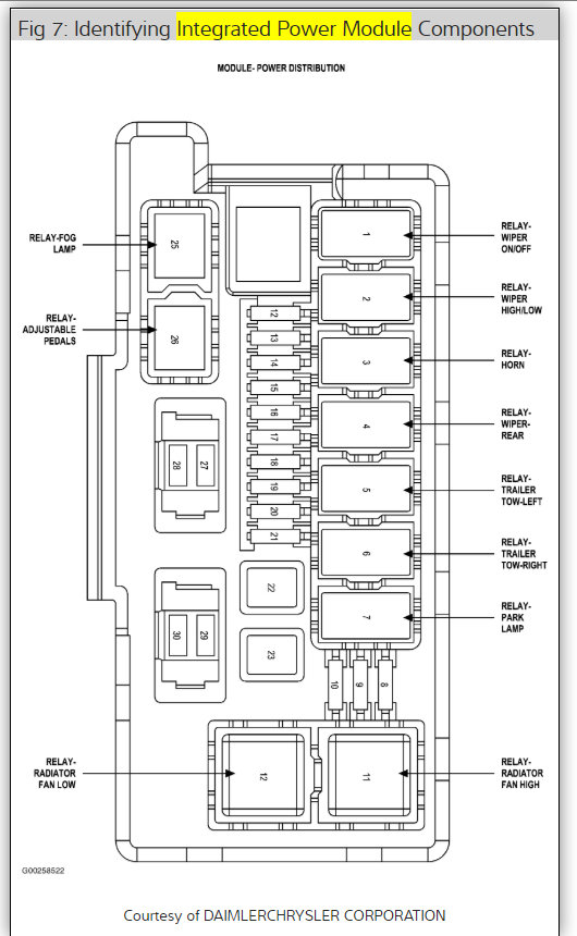

will not shot out of park. i am pushing the brake as usual but will not shift?
May 5, 2008 at 4:03 PM
BMRFIXIT
  • 19,053 POSTS

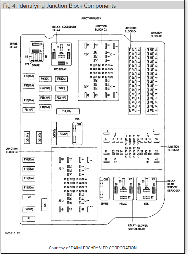

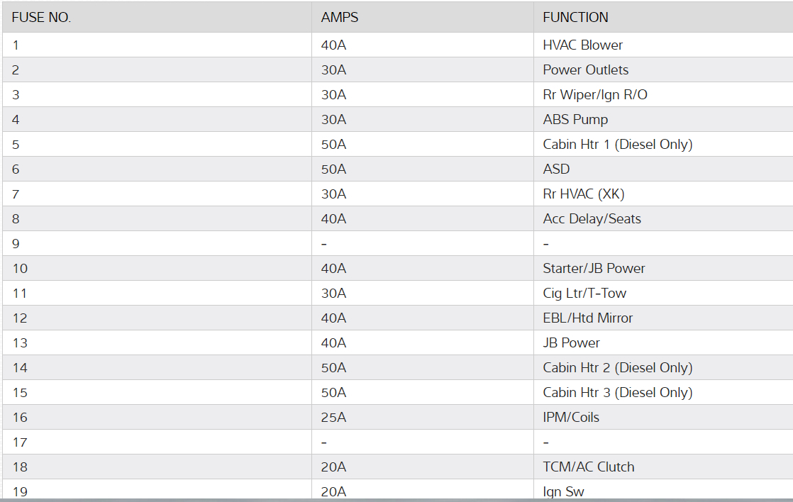

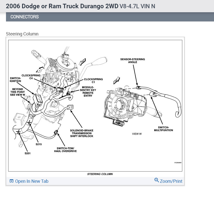

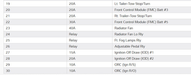

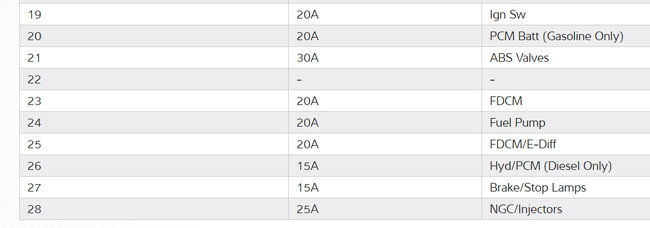

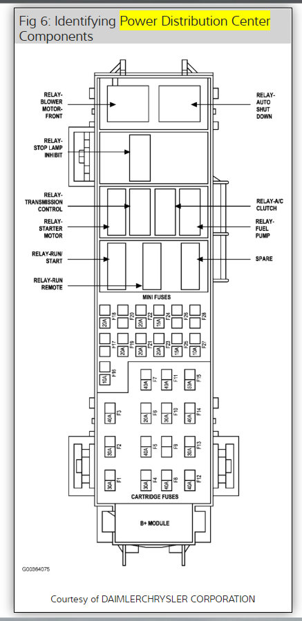

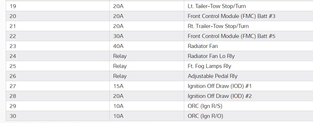

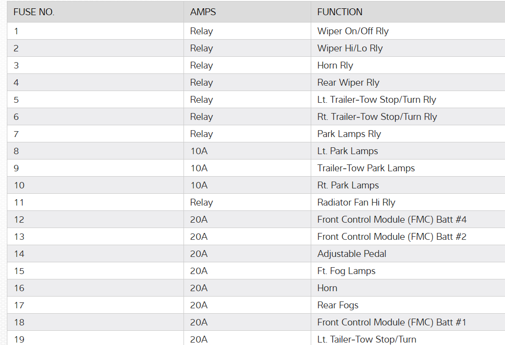

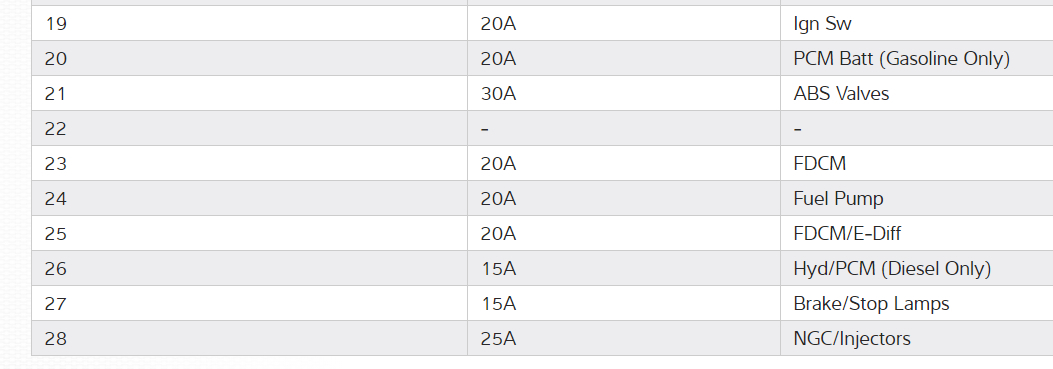

check if you have brake light when stepped on brake pedal? check fuses , check brake light switch and its connector. If all okay the interlock solenoid is out here are the fuse locations and the interlock solenoid replacement instructions in the diagrams below.
Check out the diagrams (Below). Please let us know what you find. We are interested to see what it is.

Thank you for this post I had this problem and had to replace the solenoid cost me $134.00 all fixed I love this site.
